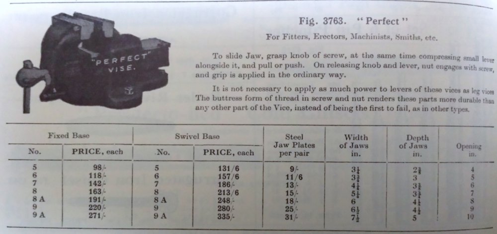

That looks like a Parkinsons Model F No.7 Perfect Vise, I'd say it's worth 25 quid. If you make the jaws out of something soft you won't damage your work piece but they will wear out. I'd use some tool steel and leave it smooth, will last a long while without damaging anything.

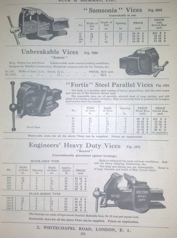

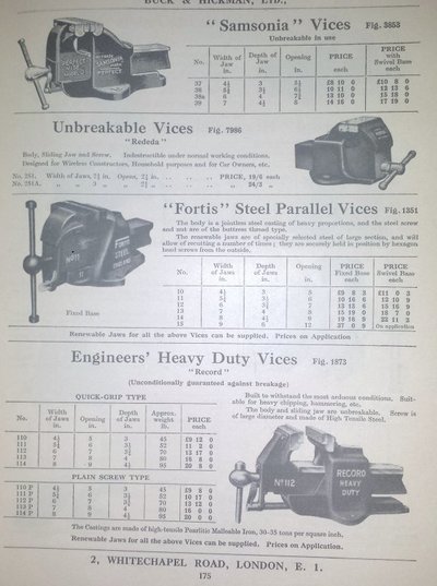

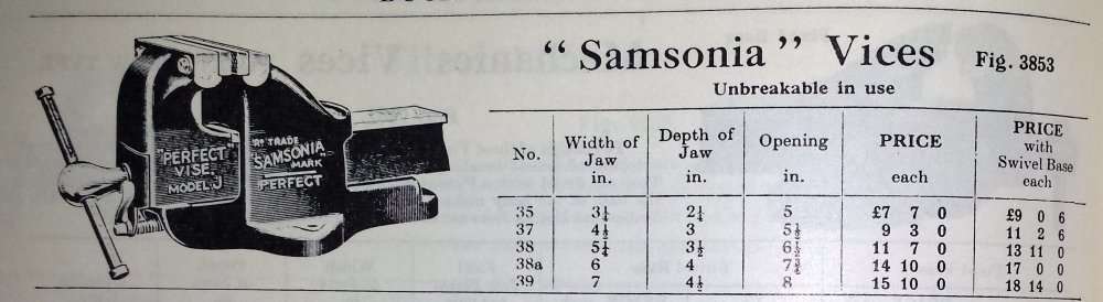

I'd have thought they would have upped the metal content slightly, especially in the upper jaw area. I'd be damned unwilling to put the unbreakable aspect through its paces personally, looking at one.
