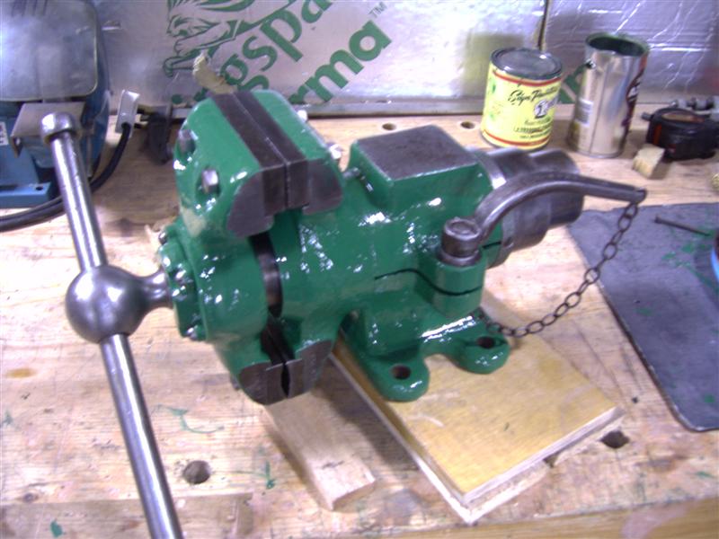

i will have to borrow one but how do i get the two main halves of the vice apart? would be handy to be able to take it apart to get to the screws properly.Impact driver?
ive never took one apart before and this one has a quick release mech.

thats the problem ive got as this is the only vice ive got as i gave away the other one, hence why ive left it with battered jawsOn that vice there is a taper pin at the back which you have to knock out of a mandrel. After that just wind her out. Bear in mind having another vice makes the process much easier when getting the screws out as impact drivers work best on stationary objects.

Looks like a Record 34, just undo and remove the bolt holding the horseshoe plate on. Press the quick release lever tight against the turnscrew and pull both the turnscrew and quick release out. Simples. Now, Remove the spring, washers and tube spacer now loose from the underside of the vice. Then pull the slider out from the main body. IF it is a No 34 it will have slow taper screws which are a right s*d to get out and has already been covered by others on how to remove, and again IF it is a No34 you might consider replacing with jaws from a No 4 which have the same fixing centres and same width but normal countersunk heads that are a lot easier to remove next time. Just need the fine thread countersunks to match the threads in the vice.i will have to borrow one but how do i get the two main halves of the vice apart? would be handy to be able to take it apart to get to the screws properly.

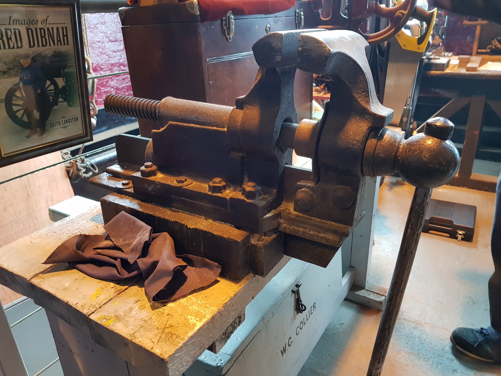

Am planning a visit to the pumphouse. Looks a very interesting placePurely by chance I've been sorting through photos on my phone and came across this
It's at a local museum that houses a couple of horizontal pumping engines and various bits of elderly transport - http://e17pumphouse.org.uk/
I keep meaning to volunteer when I can find the time.

how do you get the screws out of the jaws if theyre in tight?
i would love to rebuild my vice but cant even get the jaws outthe flat head screws are well stuck.
tig a bit of flat bar on em
