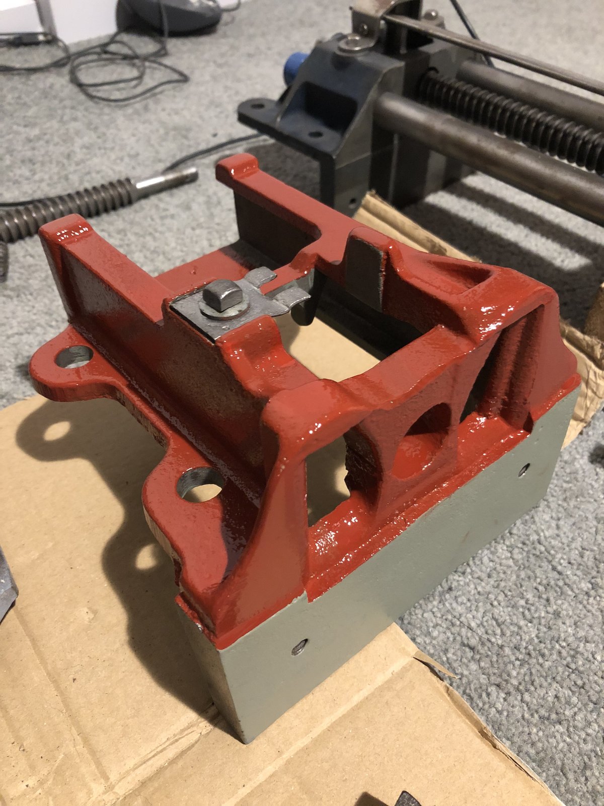

Put the mechanism back together, and turn the nut two or three clicks. You can only turn it one way. If you notice the QR mechanism skipping when you're manually closing or opening the vice, turn it another click. Keep doing that until it works as it should. I don't think I've ever needed more than four clicks.
Other than that it was just pure rust.
