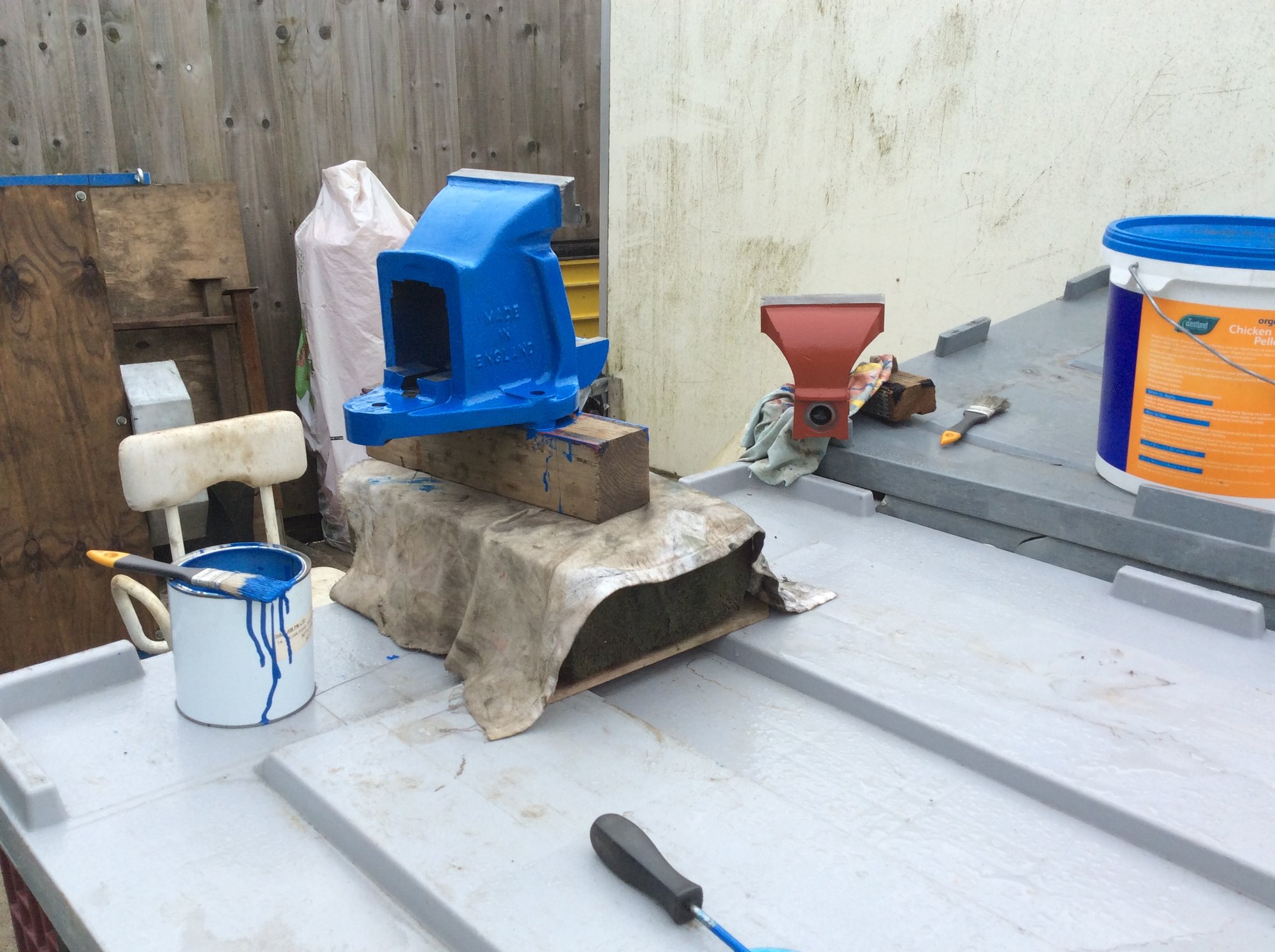

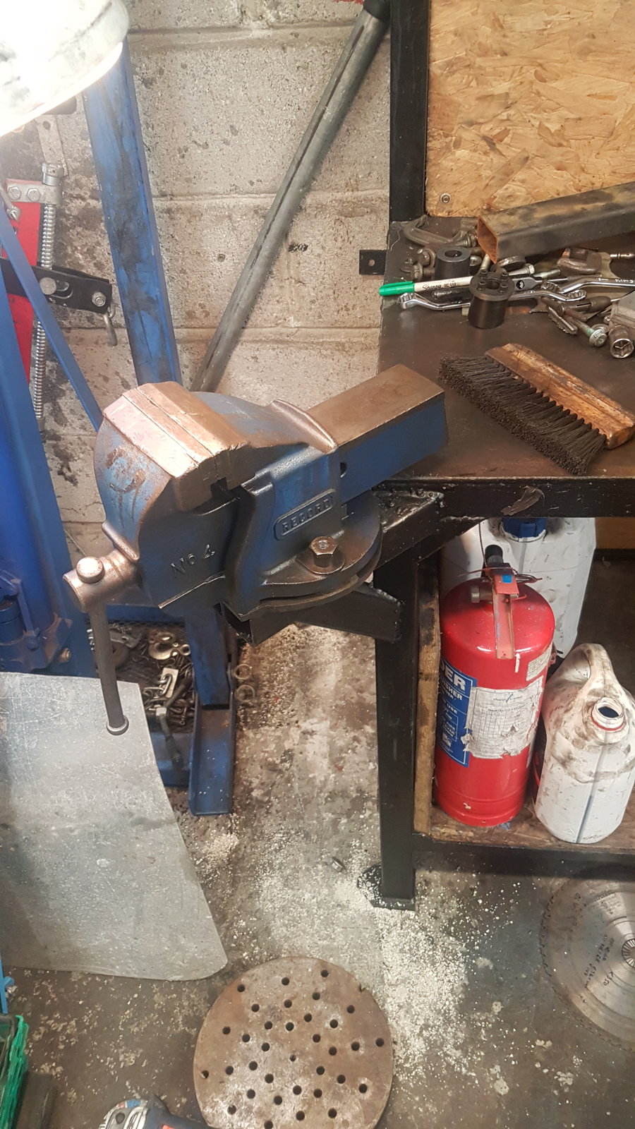

New addition to the family today

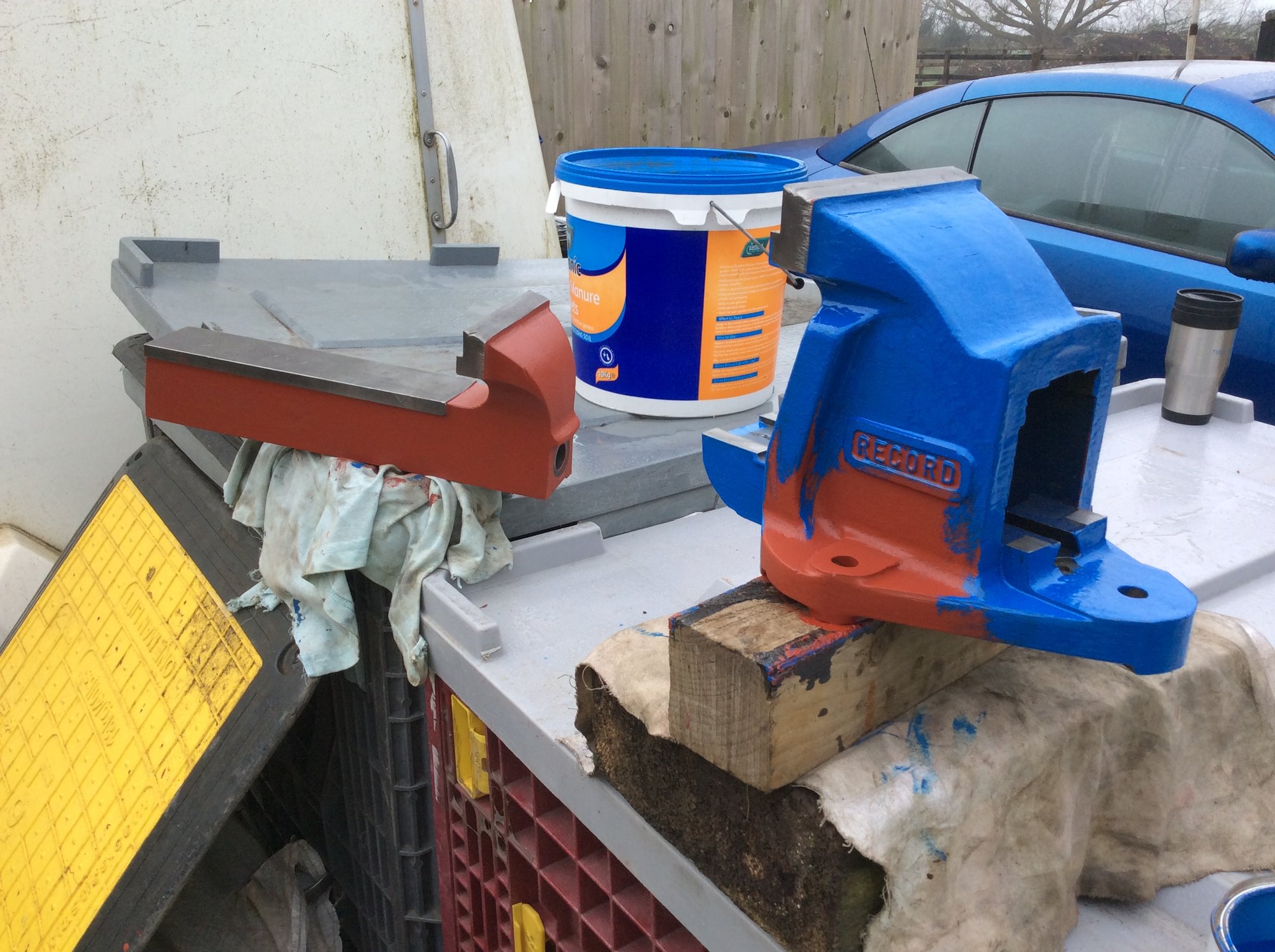

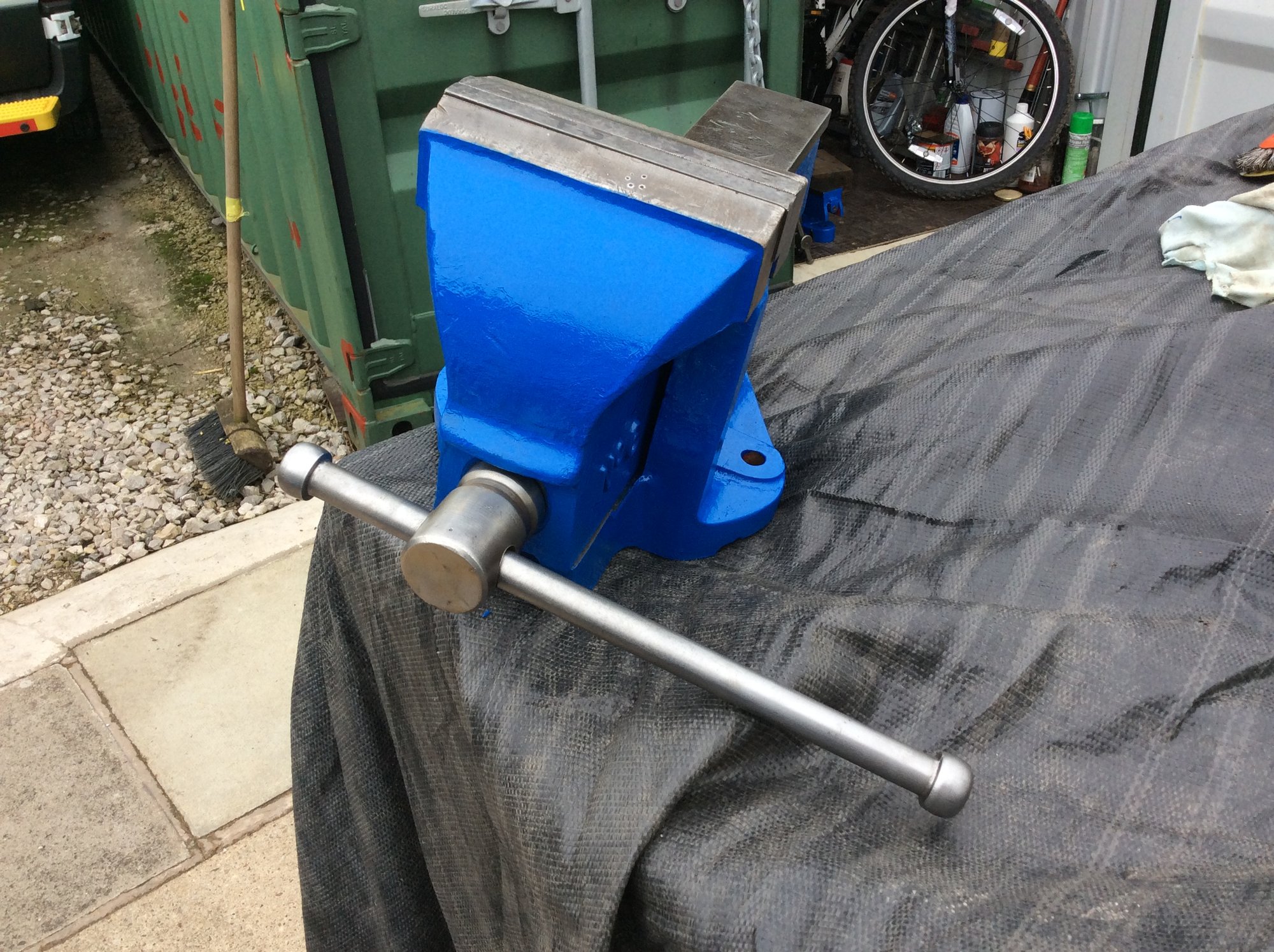

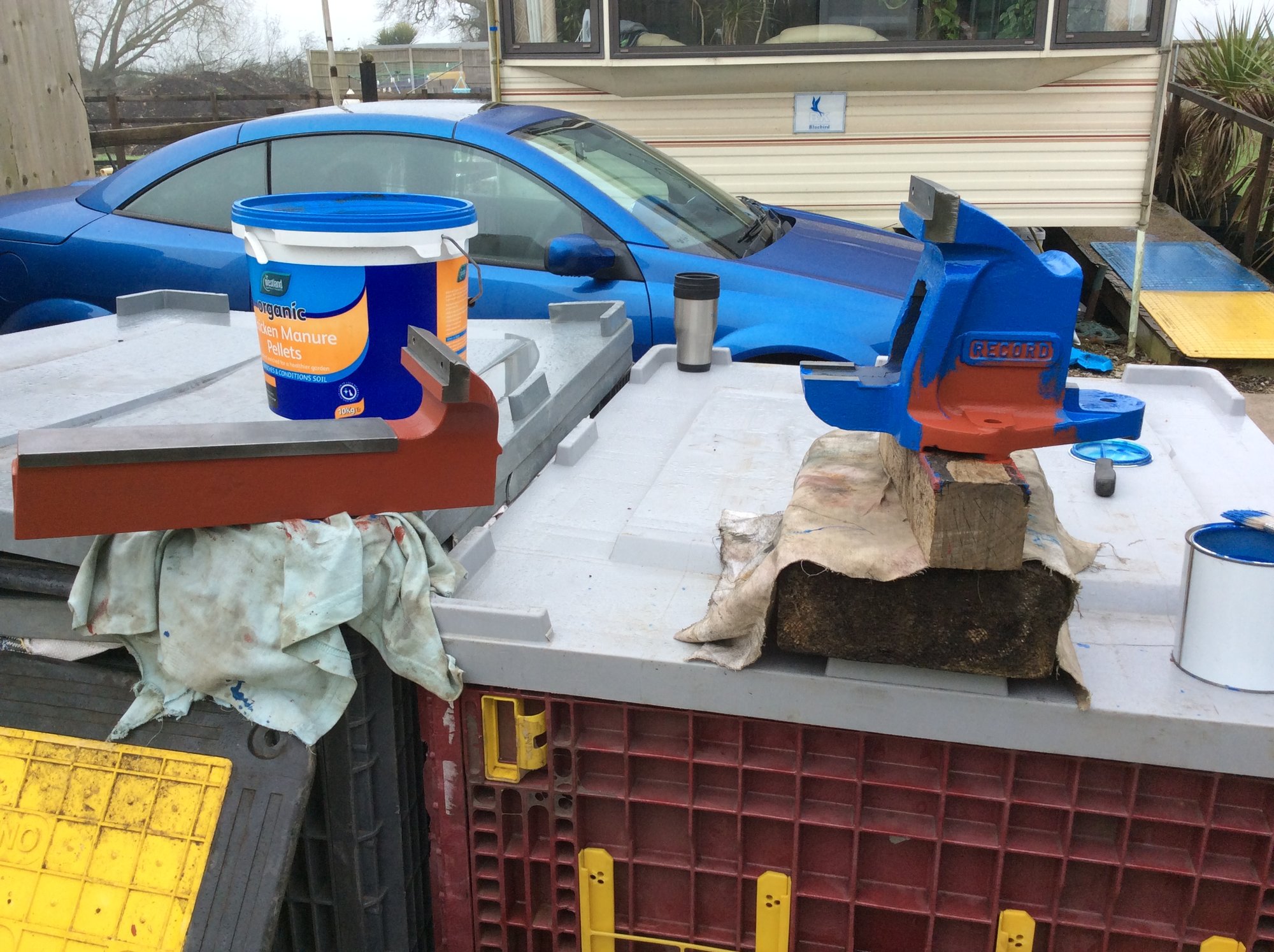

Stripped tonite, wire brushed, sanded, bit of smoothing here n there, gonna degrease tomoz n jetwash off, then primer in red lead oxide , n i may leave it red, not sure as i have the roundel blue from doing my 24,
Wot do u guys think i shud do ?

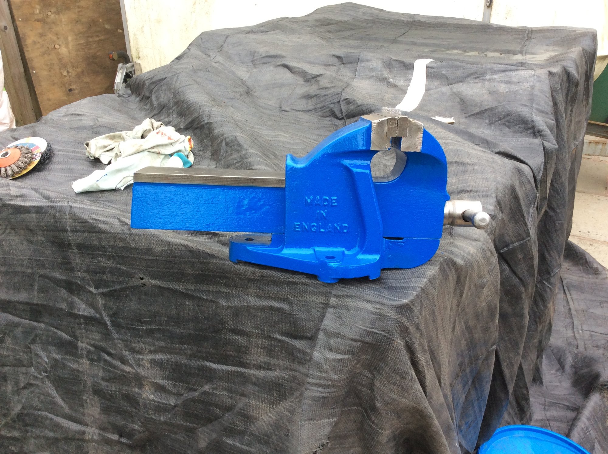

If it's going to be used & abused don't bother painting it. If you want to paint it don't use any primer, just apply the blue straight onto the vice. It's cast iron & it doesn't tend to rust if it's inside. If you put primer on & the paint gets chipped it will stick out a mile. I used grey primer on my record no 6 before the blue and after some use it looks awful with grey patches showing where the blue has been chipped.
