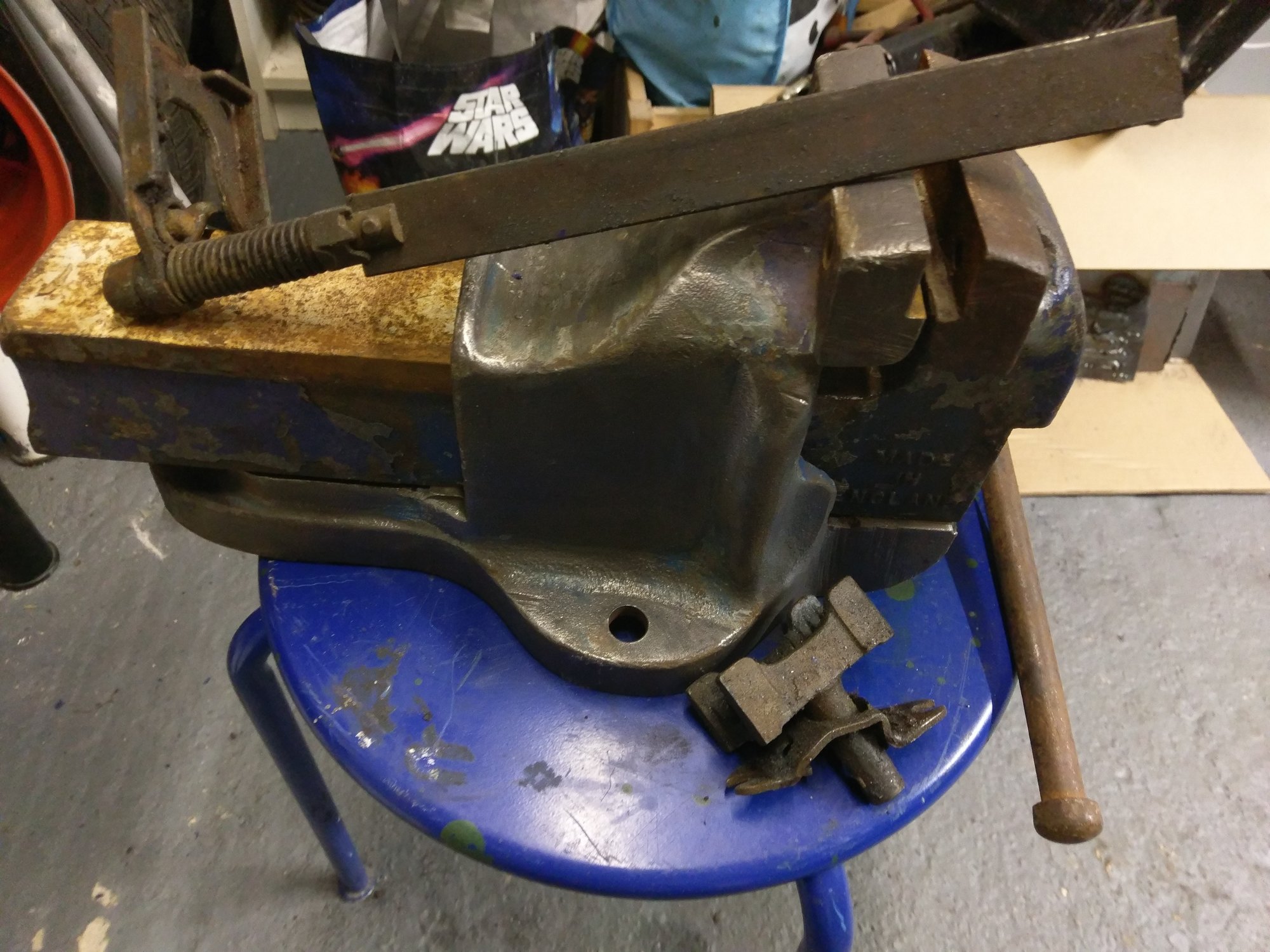

The best way to fix a vice is with another vice - if possible bigger than the one you're working on. I used a woodworking vice when I did my Record. If heat doesn't work, light tapping on each end of the jaws left and right may loosen the screws. Use an impact screwdriver, a normal one will got you nowhere. The screws should eventually come loose.

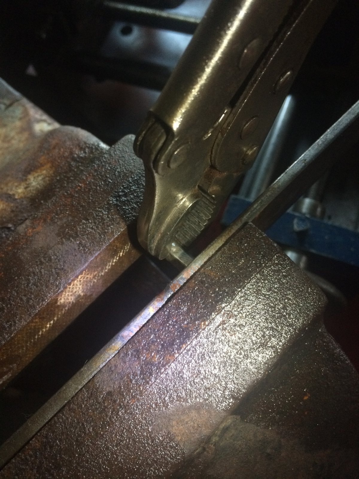

Well my first vise was brand new so...) I would like to have an impact driver, but this trick works brilliantly, and I've seen someone use an impact and end up having to weld a bolt to it, whereas I would guarantee it would have come out if he did it like this (NOT with vise-grips
). This one was nowhere near as tight as the No.36 with it's fine thread and long taper head (which also came out).I've sheared the end off the screwdriver bit using that method, if the impact driver method doesn't work for me I usually just build up a blob with the tig welder and then weld a nut on. That has never failed and once removed I cut the nut off and recut the screw slot.

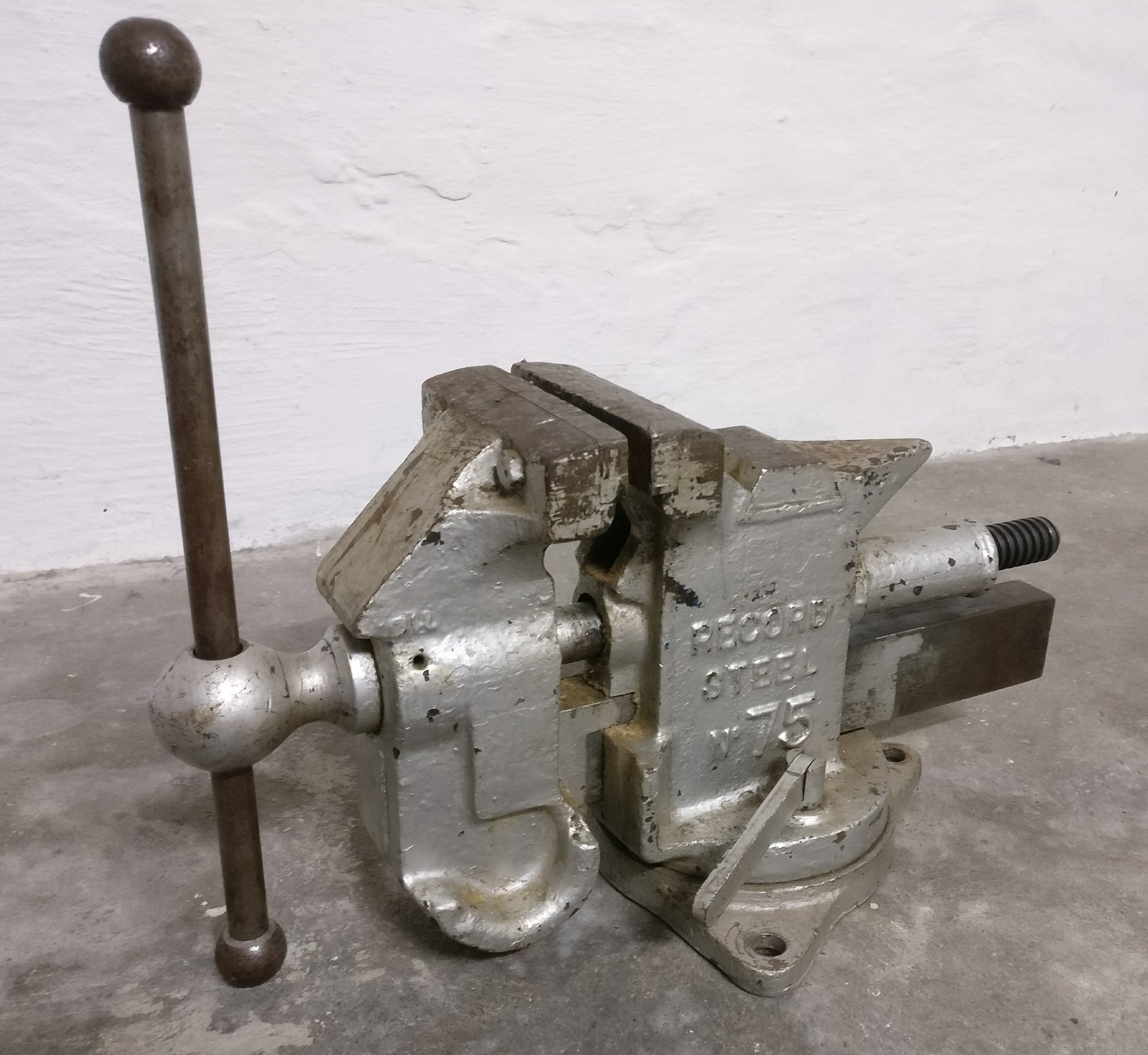

I like the record 34/35/36 but I have seen one on ebay that was broken and one of my 36's was bent when I bought it. I think the broken 36 is posted earlier in this thread.

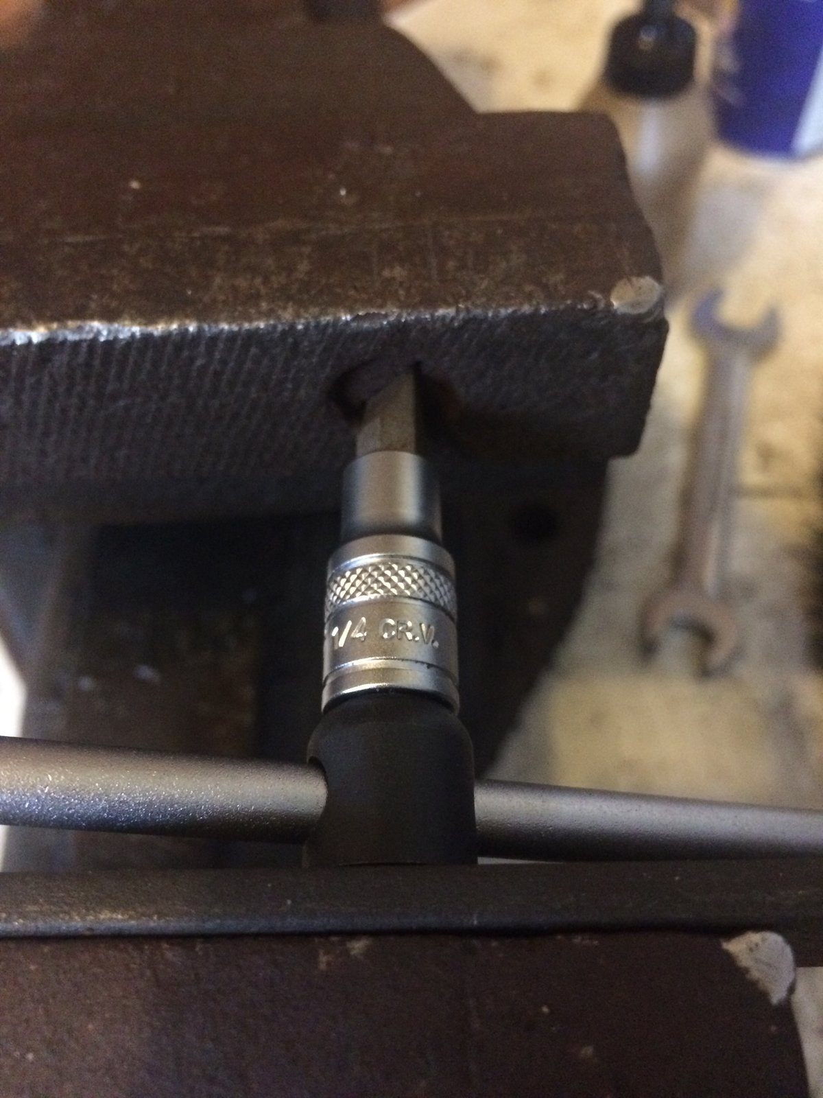

I dicked around for a while with turning those screwdriver bits with an adjustable, and then vise-grips until admitting a 1/4'' AF wrench was needed, so I bought a 1/4'' drive sliding t-bar and a set of AF sockets (although I only needed the 1/4'' size, I thought what the heel?).
