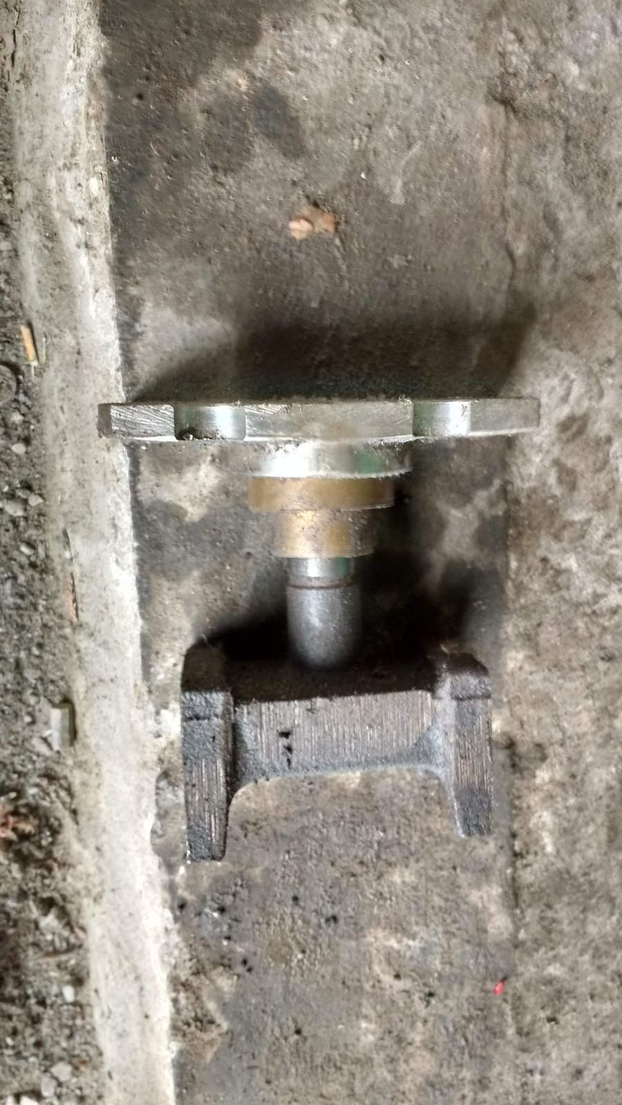

Thanks looking at my photos I do wonder if my half nut has been trimmed down to fit that plate, I will get it out later and have a good look and send a picI'll take a photo when I dig them out, including one of the half nut so that you know what that should look like, as there's a chance they may have cut the bottom off yours.
Thats what I was hoping.Aye, you could join the pin from another half nut. If that existing pin is long enough, you could also just shape, (if necessary), and notch that.
Found those bits, but forgot to take a photo. The lever looks a little shorter than the one on the 112, but if you PM me your address, I'll get the bits, (including the half nut), posted, if the fixing dimensions are a reasonable match on that cradle. Only thing I haven't found yet is the flat bar, but that's just a strip of mild. Easily made.
