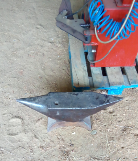

er...@julianthegypsy would you like to explain to this ignoramious what and which are the hardy and pritchelhole and what there use is, much appreciated
er...@julianthegypsy would you like to explain to this ignoramious what and which are the hardy and pritchelhole and what there use is, much appreciated![]()
thankyou ,appreciatedHardy hole is the square one, used to drop bottom tools in - lots but not all tools come in pairs - top tool designed to be walloped with a hammer squashing the metal between top and bottom tools. Some tools don’t have an equivalent top tool - in the photo of my anvil you can just make out a couple of bending forks that are used alone.
Pritchel hole is for punching holes with a drift - the drift can be knocked right through the metal and anvil - just don’t have your foot underneath when you’re using it!

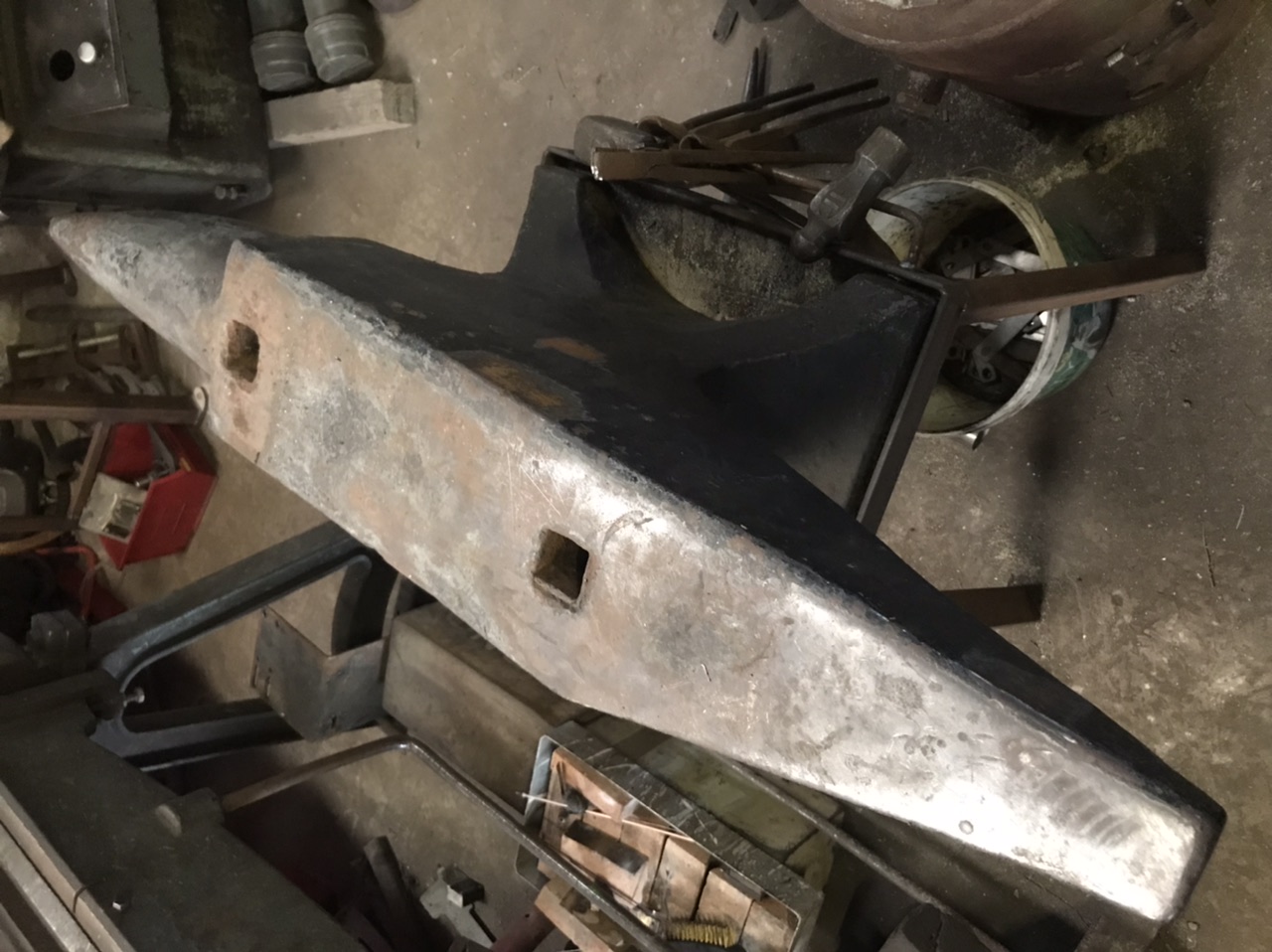

Looks like it says Peter Wright on it and you can see the English weight stamping on it. (164 lbs)Are there any anvil experts on here? I’ve not looked closely at mine before this thread appeared, but it appears to be a Peter Wright, though not seen one with a brass disc before - any ideas?
