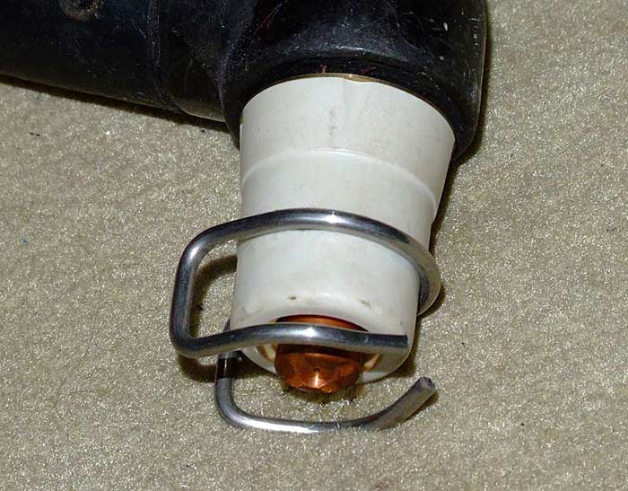

Depends on the tip. If it is flat, then no. If it is a castle-tip (has grooves for gas to escape) then it can be dragged.

It does not have a castle tip. The tip does not stick when contacting the work but I dont want to damage the torche doing it wrong.

Like this one:
