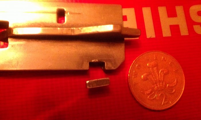

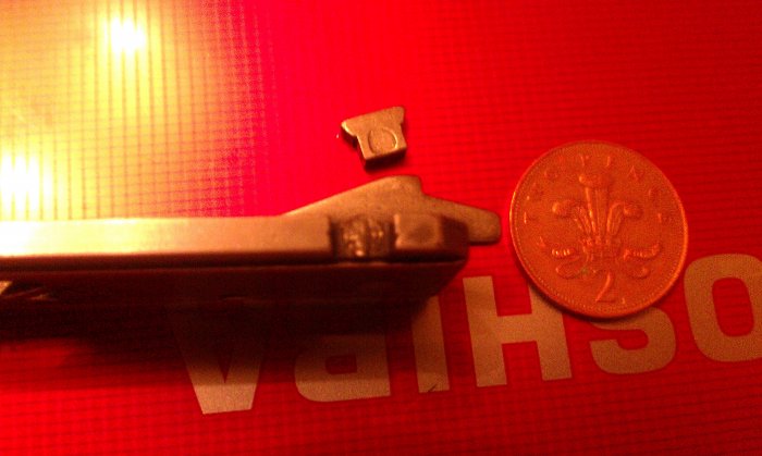

if u can file it it is soft. if it just runs over the top and doesnt cut its hard .oxy acet and braze would be the quickest and easyest and a quck rub up
It marks it ok, the bolt itself is untouched.
. I`ve welded up the action bar as both medway (An american co.) & chambers gunmakers (uk co.) are out of stock. Chambers do have the forend support wich I`ll order, just got to wait before I can test it to see if it`ll hold up.there are numerous massive gun parts warehouses in the USA that have every part known to man, it's probably a cheap part.

the bolt then is hard, and the part you need to repair is soft if ive read the previous post right.
is it magnetic?
