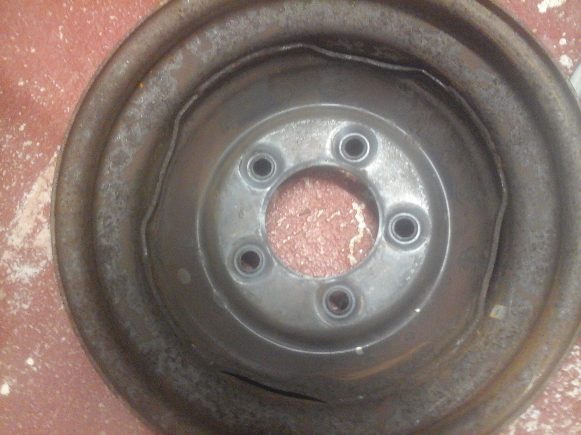

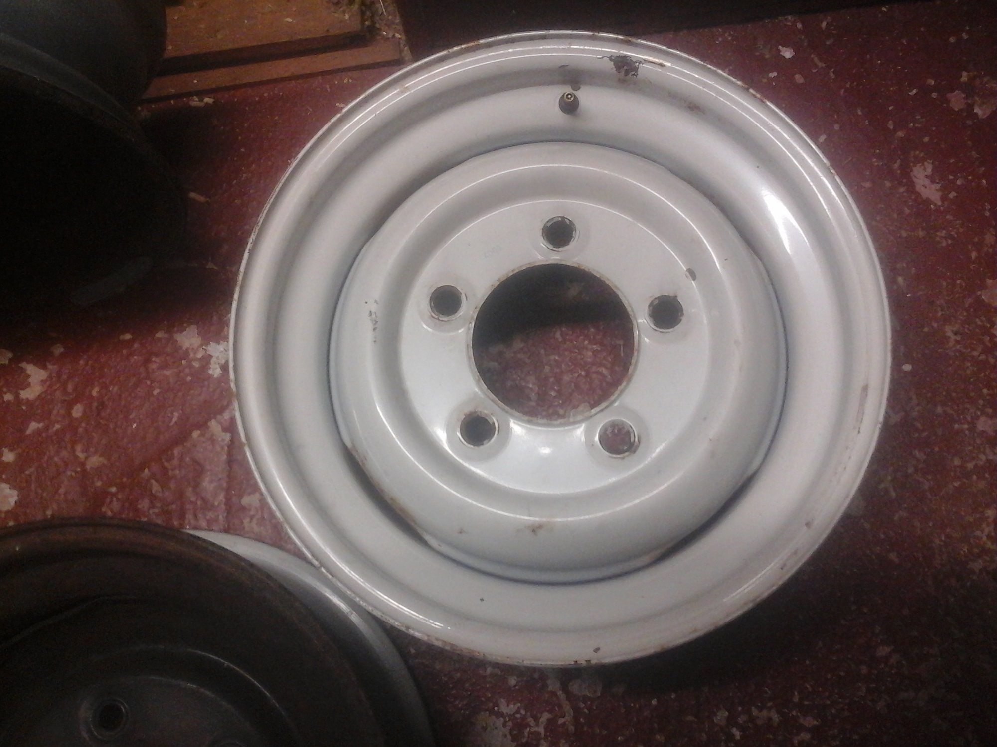

Depends what theyre using to blast it and how much paint/dross is on the wheel..... if theres one layer of paint, not much in the way of rust and theyre simple wheels, you can do them in about 5-10mins each in a cabinet easily, and about half that time in a room. Usually though wheels have been coated more than once, and at least one of the layers will be a bitch to remove, couple that with the fact that most wheels will need hitting from many angles to get it all off, and youre usually looking at around 20mins/wheel to do properly in a cabinet.Hi All , have been in contact with a firm , price depends on time taken , so how long would it take to blast a landy wheel front and back only ....... inside rims are like new,
