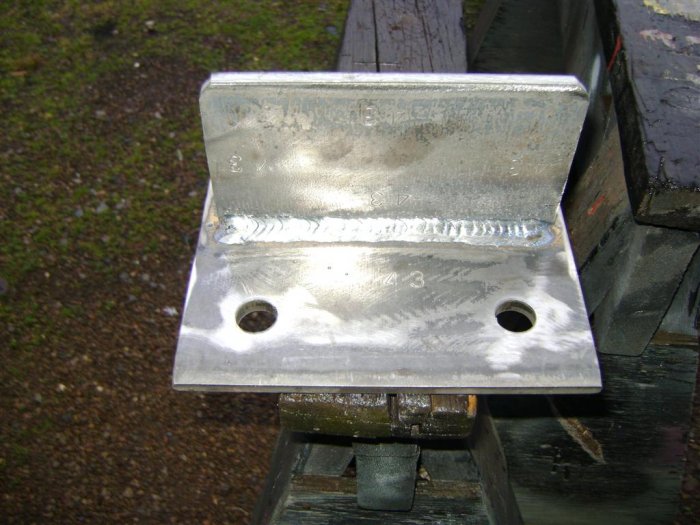

I think it looks like it is steel - but I can't quite tell from the pics - it isn't aluminium visit?

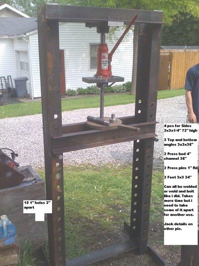

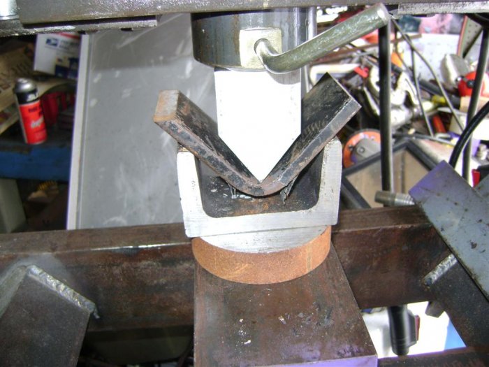

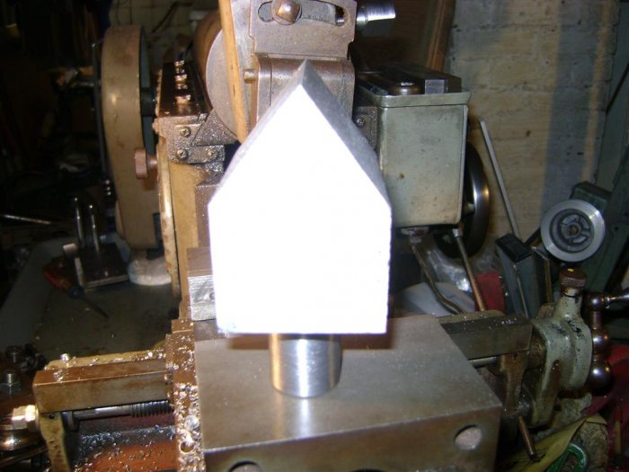

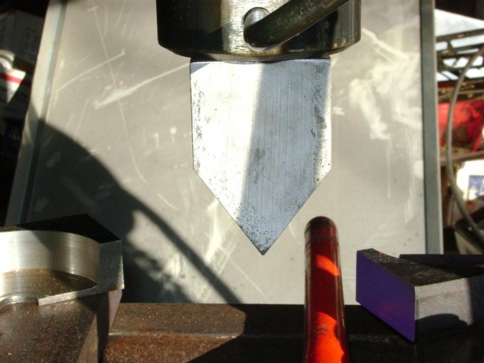

nice work bob,what angle is the point of your bending punch? also what are the rough measurements of your press? i have an old length of 6" channel and a 20 tonne jack so was thinking of having a go,my plan at the moment is cut the side peices at 1700 then 2 peices welded back to back for the top sections at 650
thanks
dave
Thanks for that,does the frame flex at all or do you think it would cope with a bigger jack?
Have been thinking about my design today and think instead of using channel for the side sections flat would be better then there is no sides so would be able to straighten something like a buck rake tine. which was longer than te
press bed.so would12mm x 80 or 100 be strong enough or would 15 be better
