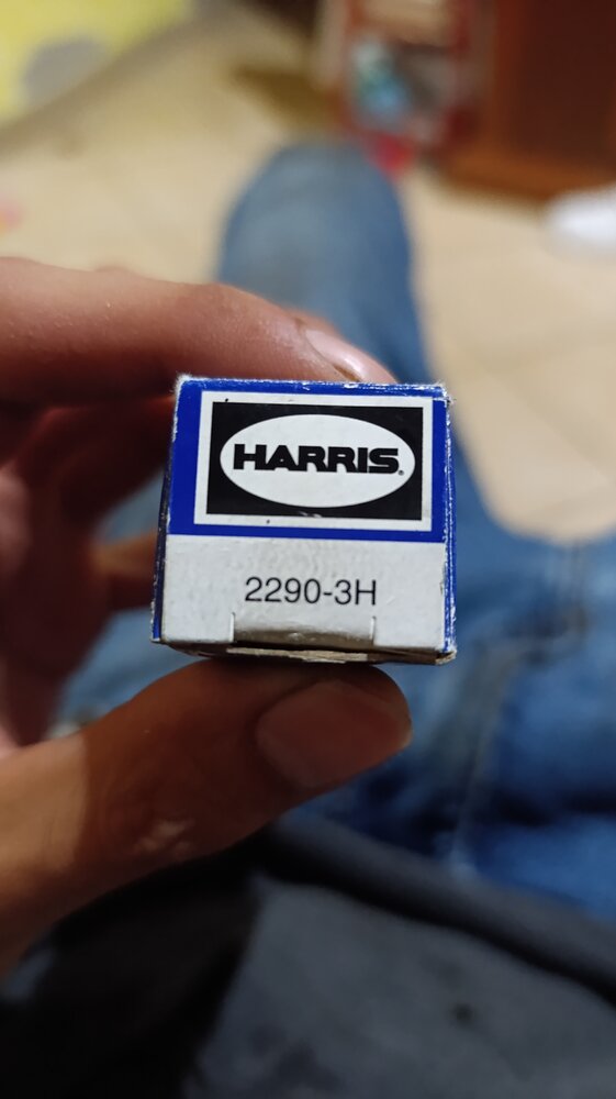

Hi everyone I've got few of those (3+1 I already had and another one coming with the proper adapter)
I need to run them on a model 62 torch.
I've already measured the thread and it's 12.67mm in diameter and fits the 1.25 pitch gauge, translates in 1/2" 20TPI UNF.
Problems comes with good that once typed the Harris 2290 code textually says quote: 1/2" - 25(M)
Wich sounds weird if not stupid cause of the 1.25 like pitch.

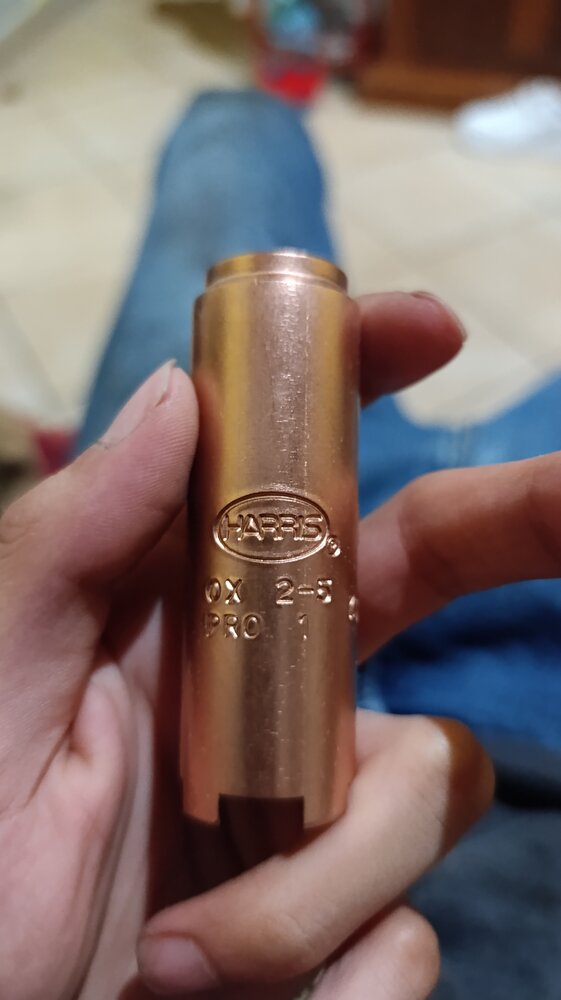

Another picture for reference
The adapter is not for me but for my boss as I'm pretty sure he won't buy the proper (expensive) adapter
