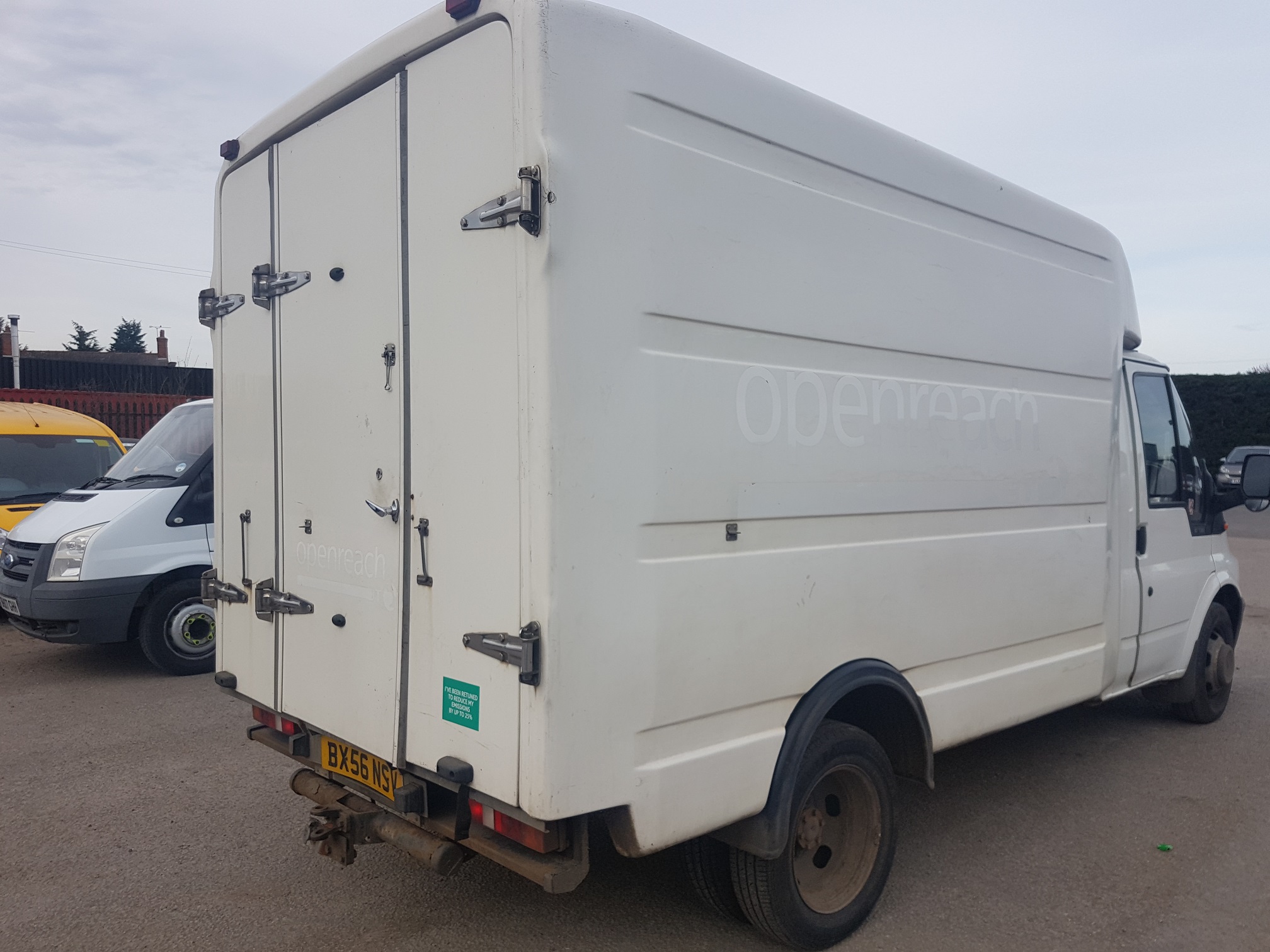

This camper i am after doing in the near future.
I am after a small camper for fishing sessions and also a tow vehicle.
I love the Shogun/Paj and have a fair few now and after a look into converting a van, but then not much use at towing big stuff off over 2ton i am thinking on another idea.
If i was to get a LWB Shoggy or Paj and remove the rear body section and make a camper body for it would it need an IVA?
I am thinking it not need an IVA as it is a chassis not Monq construction.
I have seen pickup conversion done to these but this will be down to the chassis and complate new body made from either a GRP construction or canvas with lower half GRP.
Its all down to axle loads etc then.
I could remove the roof and make a high top for it even, just would like more width if i can.
Any ideas guys n gals ?
