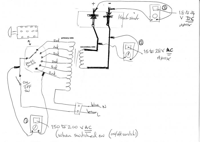

dont know what i touched but she has started working!!!!
wire feed ok gas valve working havn't tried welding yet but i still have no voltage reading between choc bloc blue and any red on the selctor switch! is that right ? i reckon ive got a loose wire somewhere giving a high resistance on a connector somewhere! but i cant understand how that would blow the main 13 amp fuse in the plug?:
It does not help that most oof the wires are (or look) the same colour (could be a bit dusty
