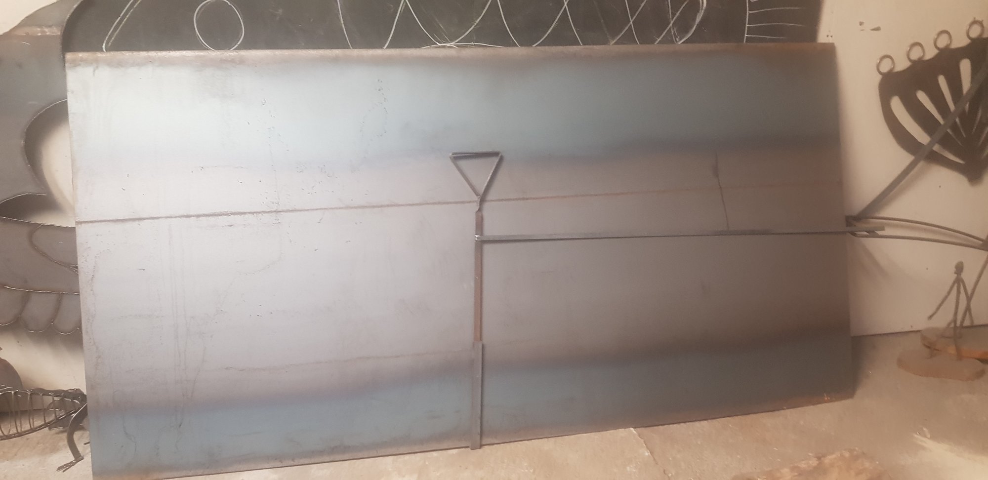

How many years have I fought sheets of thin (usually 1.6mm) steel around my workshop.
Inspired by the thread about long strips and how to move them.
A simple thing, two hooks and a handle.
Bottom hook goes forward of the CofG, long hook snags the far end of the sheet.
It seems to make dragging them around a bit easier and maybe safer.
Time will tell if It ever gets used.
Silly man made it left handed first time.
