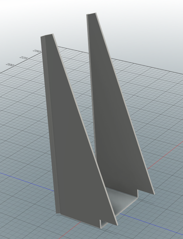

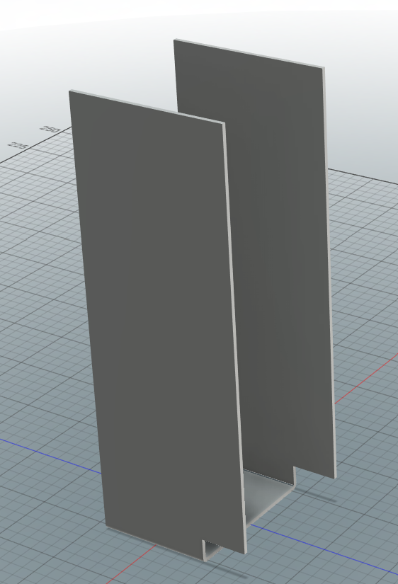

I suspect a very specific / niche problem but there must be a solution somewhere as it is manufacturable. I was pleasantly surprised that some quotes from Fractory for it to be laser cut and CNC bent were not that far off the online prices for the sheet of aluminium so it's quite appealing to just farm out the cutting and bending - thus I'd like to make it as accurately as possible so minimise the amount of weldng / cutting / trimming etc., that needs to be done afterwards.

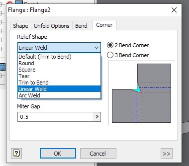

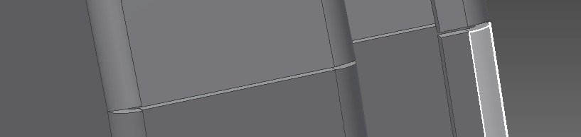

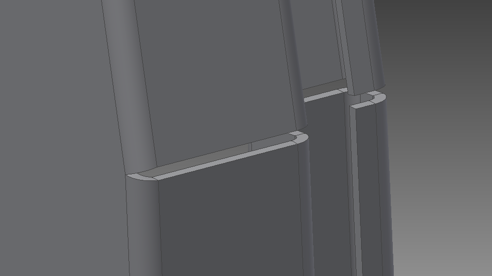

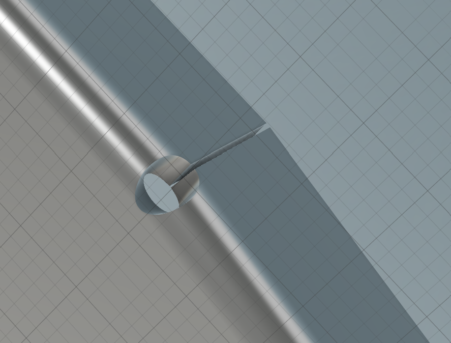

The first issue is on the bend up the side - I've got it this close by choosing "Linear Weld" in the corner options of the bend but it's still a 3mm gap - it will be TIG welded and quite a gap to fill. I'd have thought there'd be a way to close up the gap a bit to allow for a tighter fit-up.

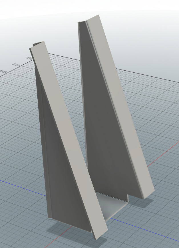

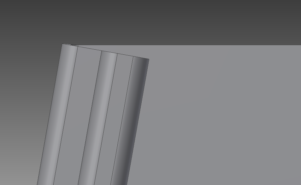

The second problem area is the top corner - ideally I'd like to extend this up to meet or extend past the top of the main panel - if it extends up past it then I can apply a cut across the top to trim off any of the excess (I've tried this in the top-left corner in the image below and it applies the cut to the flat pattern so that would work).
Any thoughts? I should say that I'm currently doing this in an old copy of Inventor Professional 2012 that I have and would prefer it to be done in that if possible.
