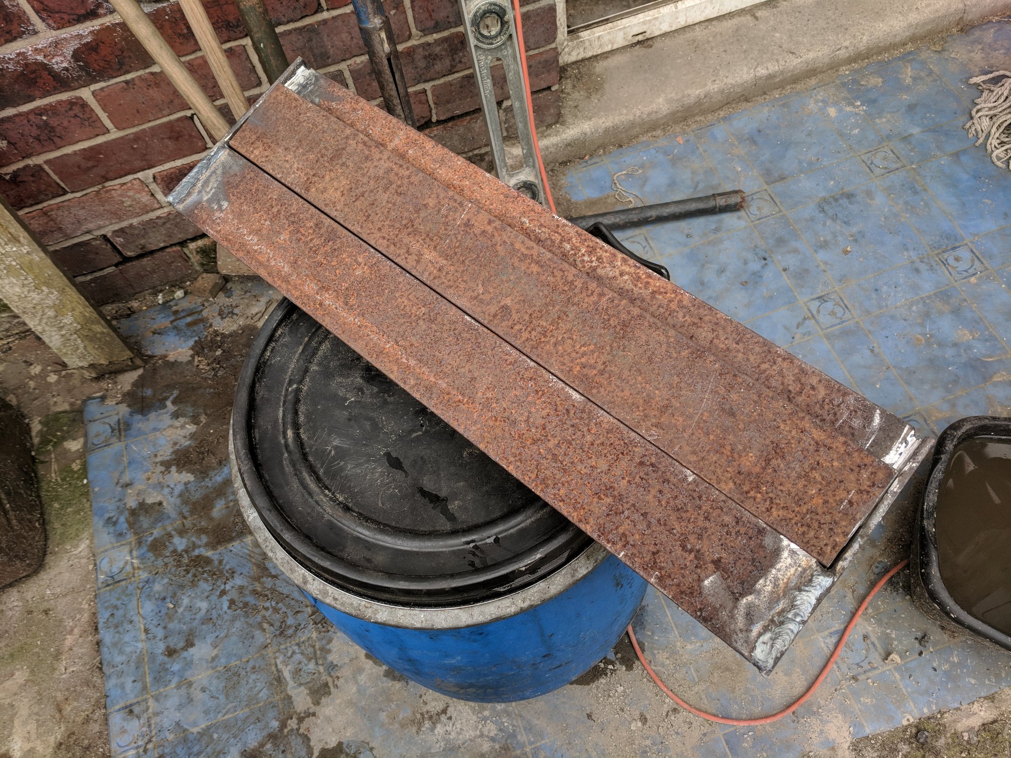

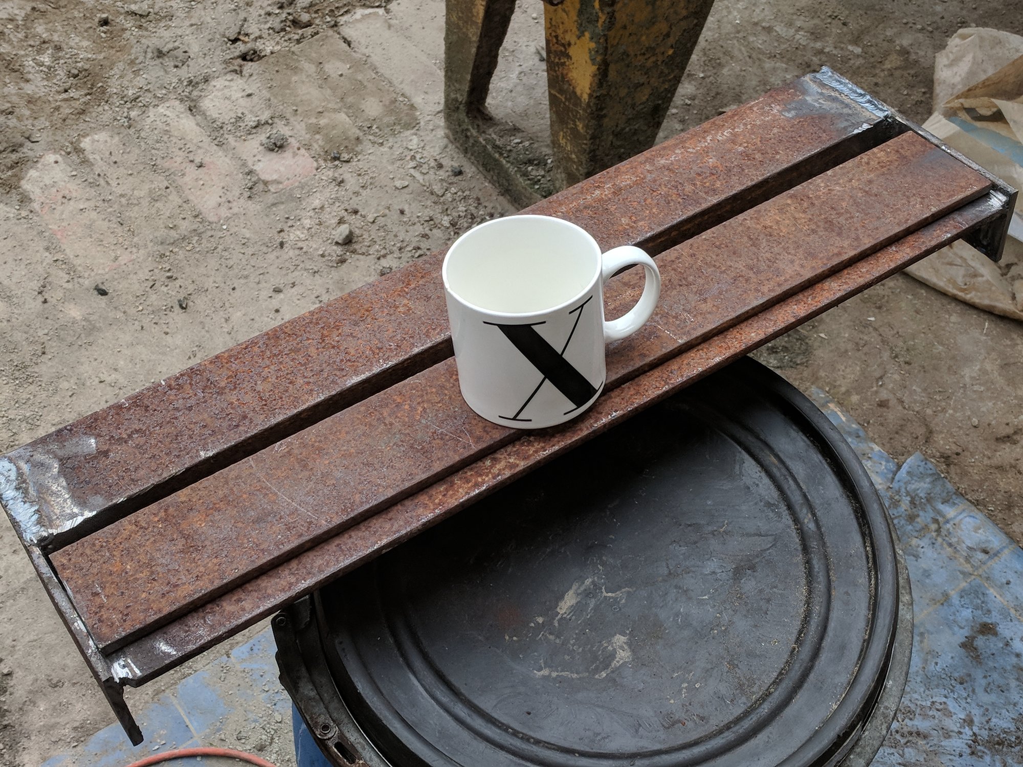

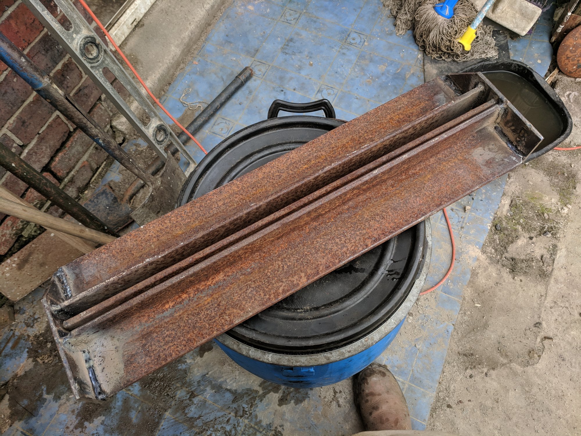

Sheet metal bender based on tonybmw/retrorides design.
24" capacity, and it's made from 75x50x8mm angle - cos I *like* heavy and over engineered...
Going to add either 3, or 5, M10 bolts to clamp the moving arm, and I've made sure there's enough clearance for some 13mm "fingers" for box bending.
I also realised that it's nearly 4 years since I did any stick welding! - over three since I welded anything at all.
