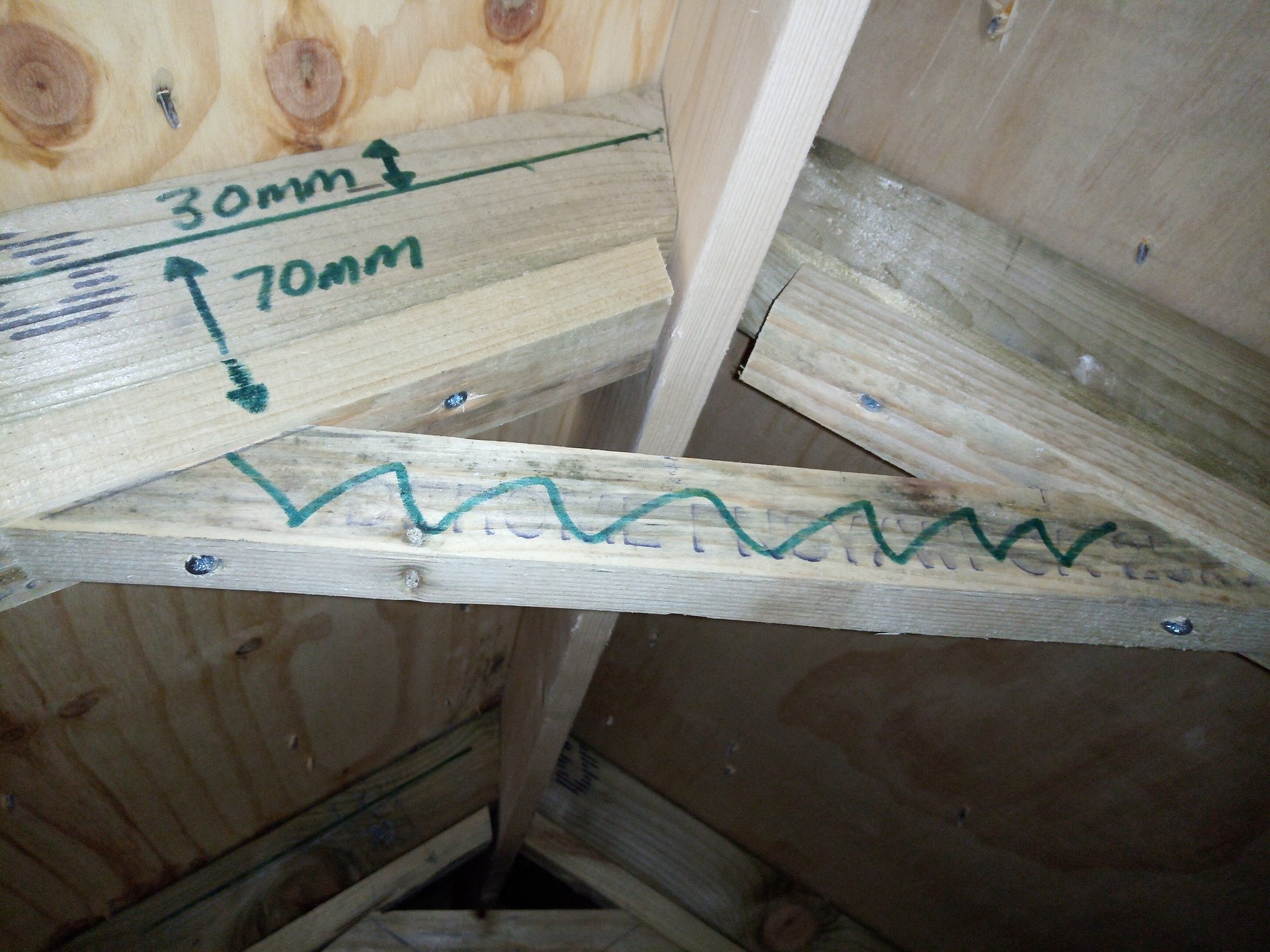

cold roof method needs 2inch and allowed to breath if a flat roof design
if apex roof 1 inch or less
Mine is an apex roof with felt shingles.
just one hole on your ridge board is enough to allow air to go from one side to the other
