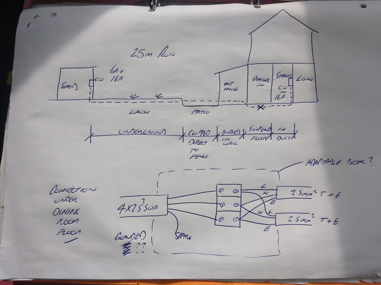

I'm looking at an existing shed electrical supply that currently has a 25m run from the house. It's a bit unusual so thought I'd "do the maths" here.
More interested at the mo in seeing the max load I can have at the shed. I'm alright doing this really just one question really, me being pedantic!
The 25m total run is roughly this:
- Supply is TN-S
- Small cu next to the main cu currently has a 16A breaker feeding the shed.
I think this is preceded by the main cu 30mA RCD but can't be sure until I take lids off. It might be the small cu is simply fed from the main switch in the main cu. Immaterial at the mo as it will be "done right" now.
- The unusual bit comes next. There's two pieces of 2.5mm2 t&e in parallel coming off the 16A shed breaker. These run through two ducts under the stairs that has the floor concreted.
Under the dining room suspended floor is an adaptable box (galv?) that I can't quite get to to inspect. (The floor is coming up there soon so I'll get to see properly). I don't know if the swa is glanded etc. Guessing it's all in a choc block.
At the adaptable box it changes to a 4-core 2.5mm swa that runs to the shed. 3 cores used I think, L,N & E with one left spare.
At the mo I can't change the swa as it's buried in the wall / floor of the outhouse.
I'm hoping the best I can do is replace the 2 bits of 2.5mm2 t&e with a bit of 2.5mm2 swa. Properly jointed under the dining room.
So I've then a "consistent" 25m of 2.5mm2 swa. It's a combination of direct in the ground, ducted and clipped direct so looking at table 4D4A a mix of Reference Method C & D.
It's actually a 4x2.5mm2, 3-phase swa being used on single phase.
Looking at the table I'm thinking to treat it as "1 two core cable single phase AC or DC" which says 29A. That's the question, 29A?
Volt drop then is 18mV/A/m.
Doing the volt drop calc I get 11.25V volt drop if I assume a max load of 25A at the shed which is usable.
VD = (mV/A/m) x lb x l
1000
So:
11.25 = 18x25x25
1000
Assuming 5% max volt drop is 11.5V all's good.
I can put a 25A MCB in to feed the shed then a 6A & 16A in the shed.
Cheers
