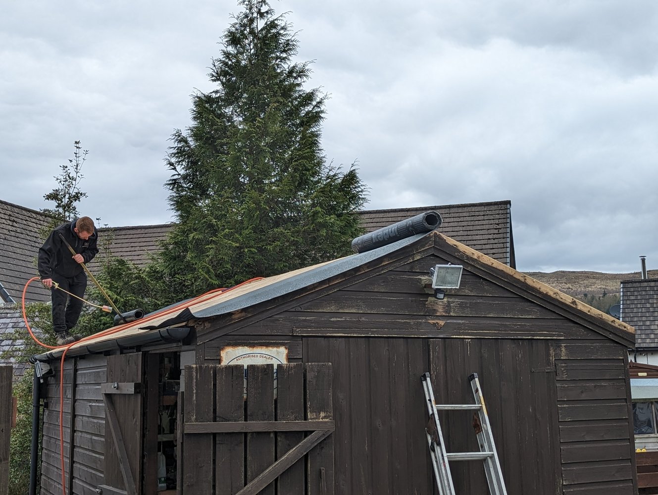

The guy doing the shed roof is no tradesman either or he would of put a drip edge in 1st and the cap sheet over the top, plus while i am on a roll,that felt he is using is not a full SBS and is very low end in the marketplace, That's it i have cleared my throat so carry on
