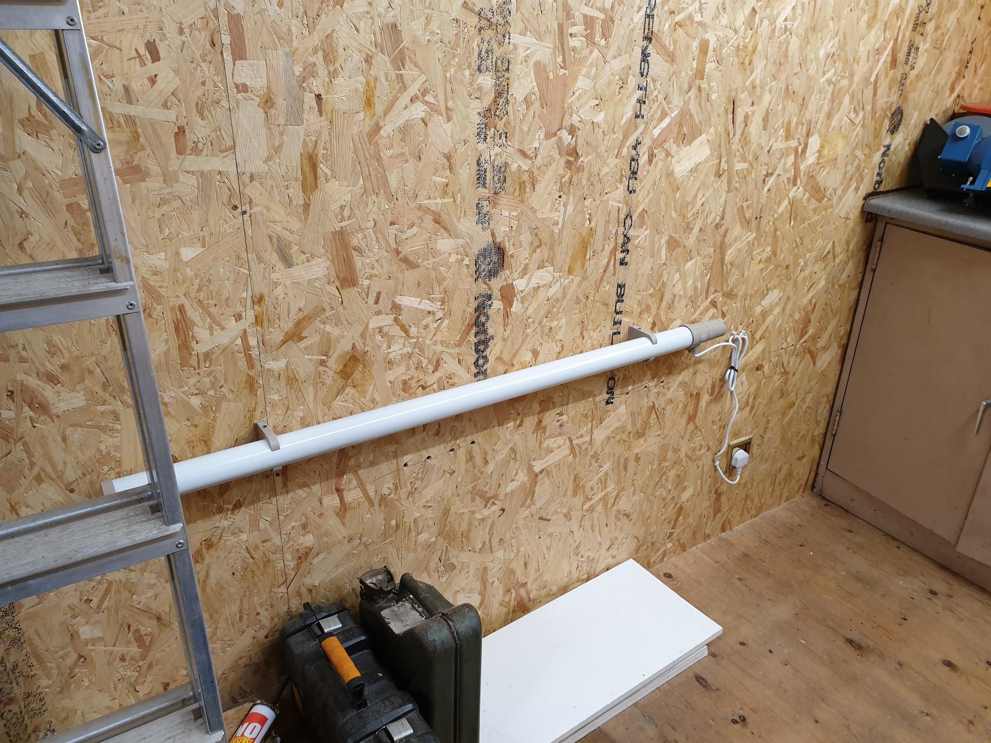

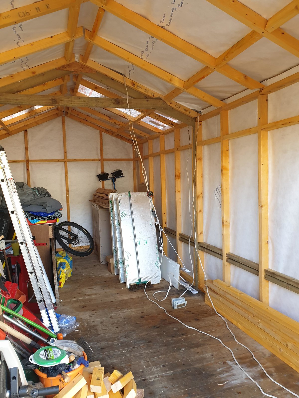

put a lathe either side on the slope then wood it between the lathes
gives 2 solid points to fasten too and also you can wire in the apex of the void
if you got an osb board left use that instead for fixing light to it but id rather fasten lights to the slope of the osb board
2/3 lights down each side controlled by a double switch socket
as gives one side or the other with light when needed or you can have all lights on
