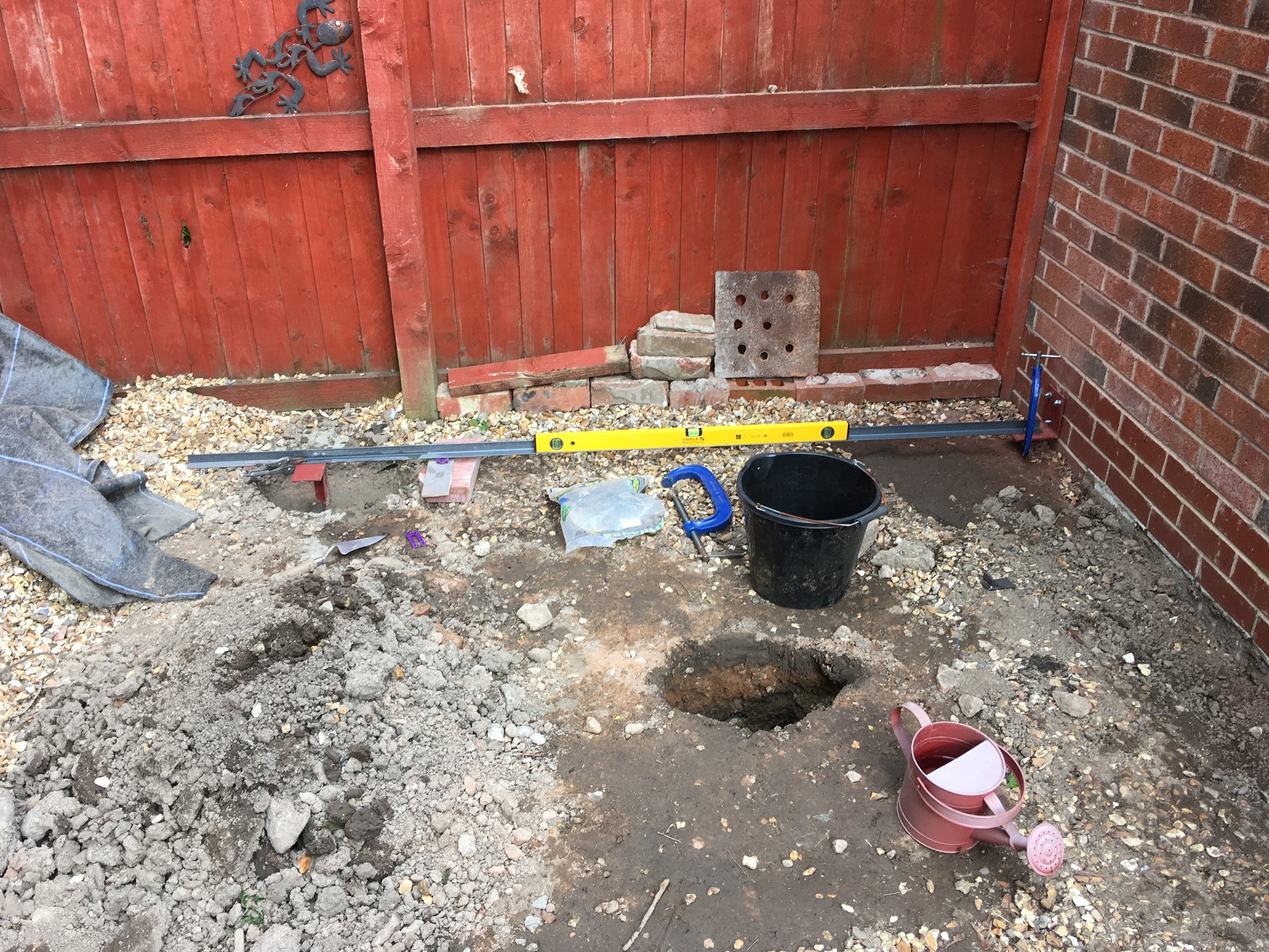

Another problem was I wasn't forking out for a proper base or footings so I was worried that if my pile foundations decided to sink it could put an outwards pull onto the single skin garage wall, not good.
I did want to use the garage to bear some weight though.

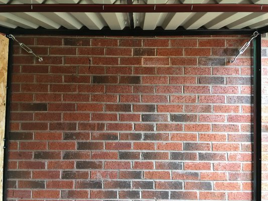

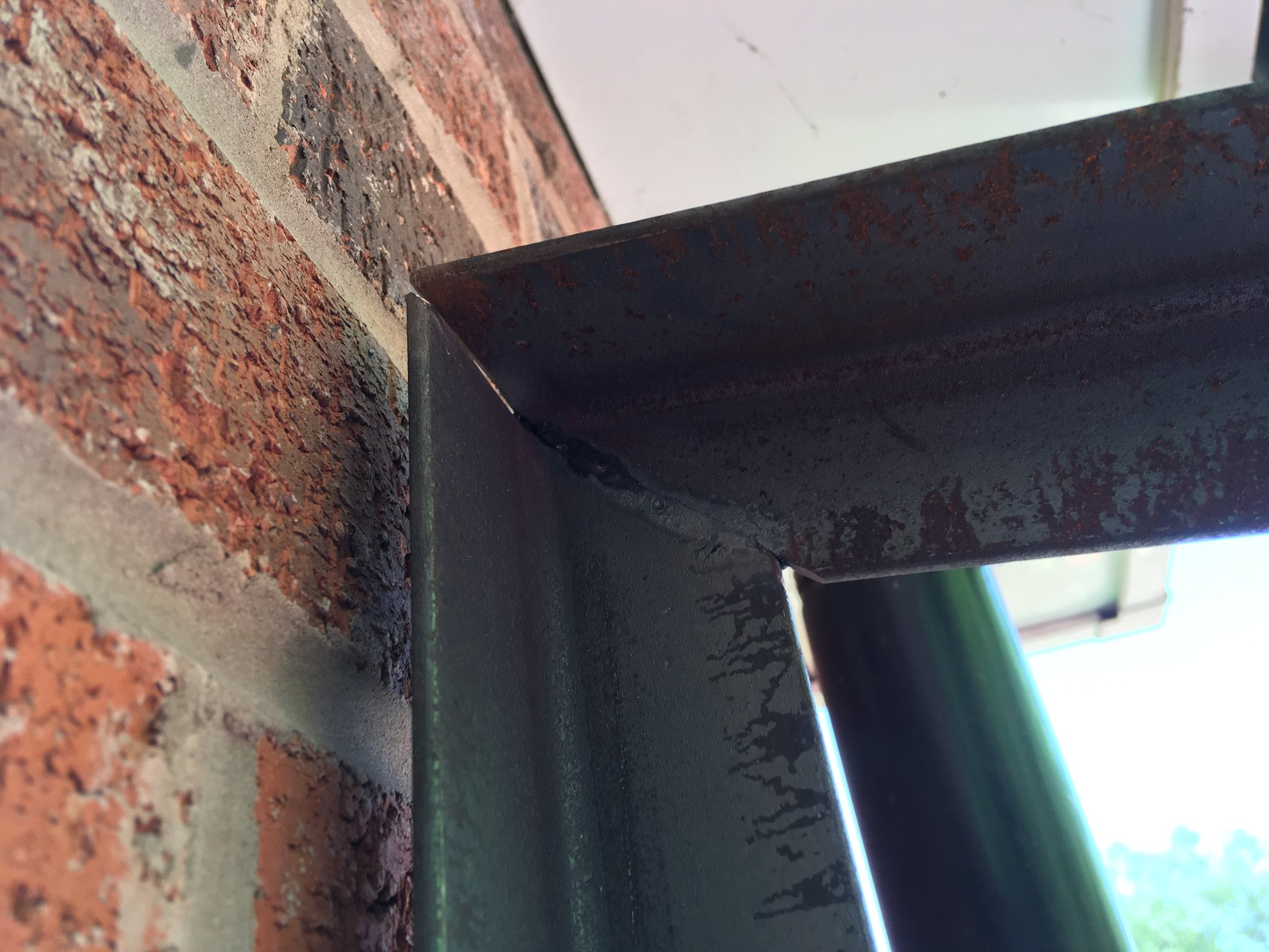

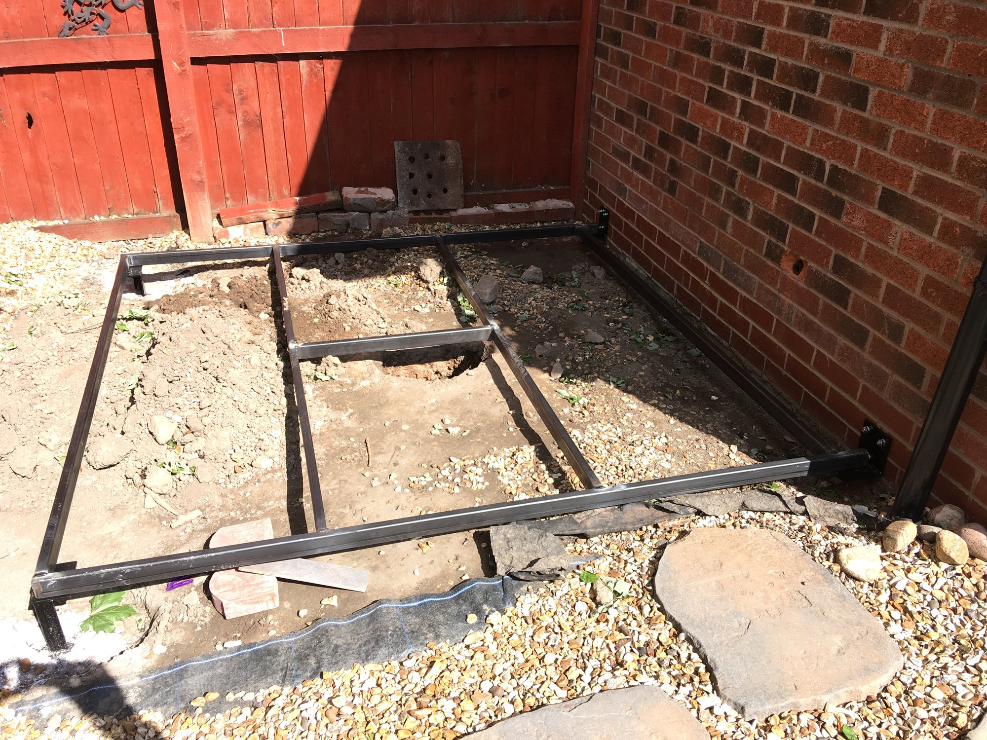

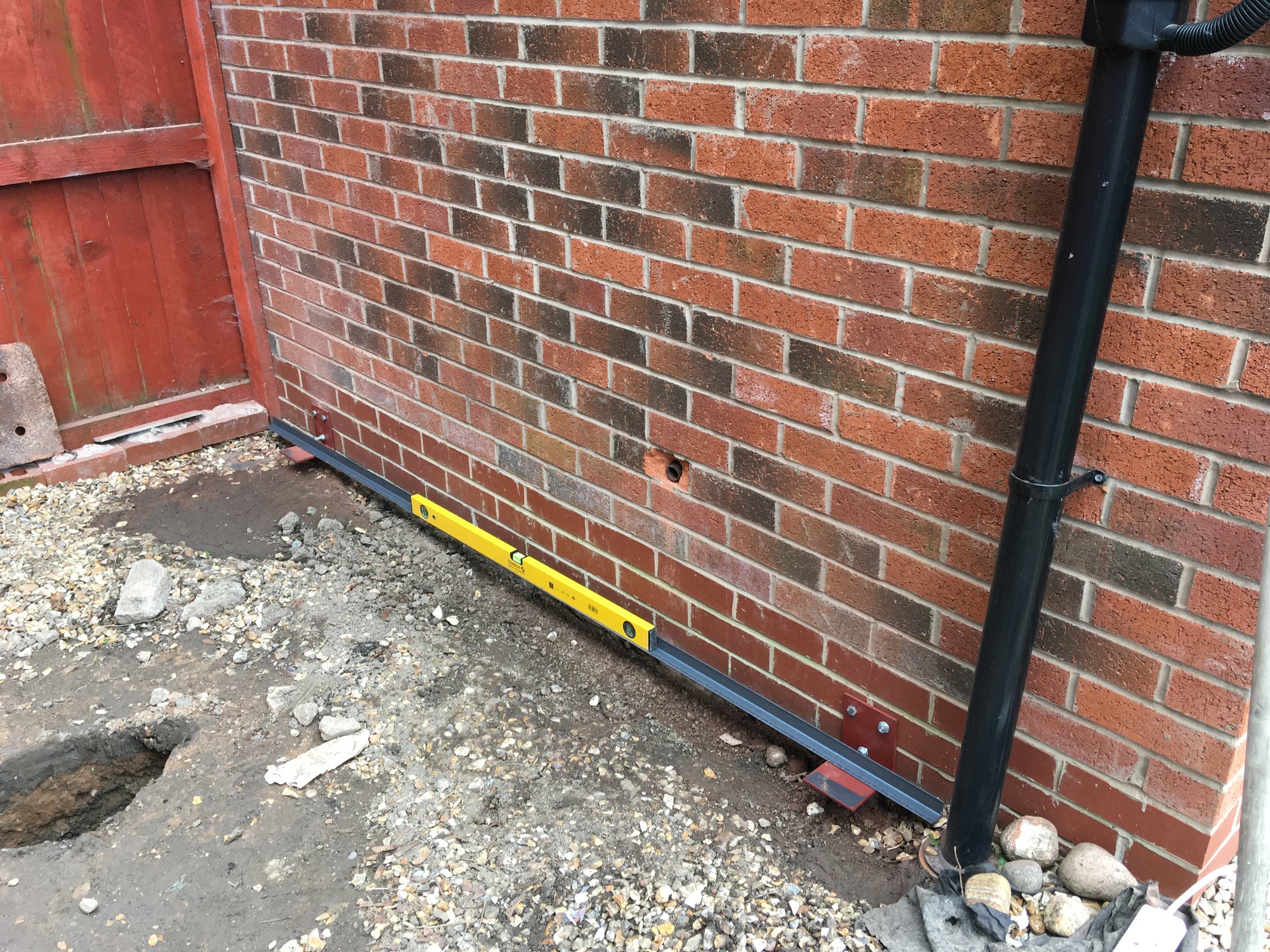

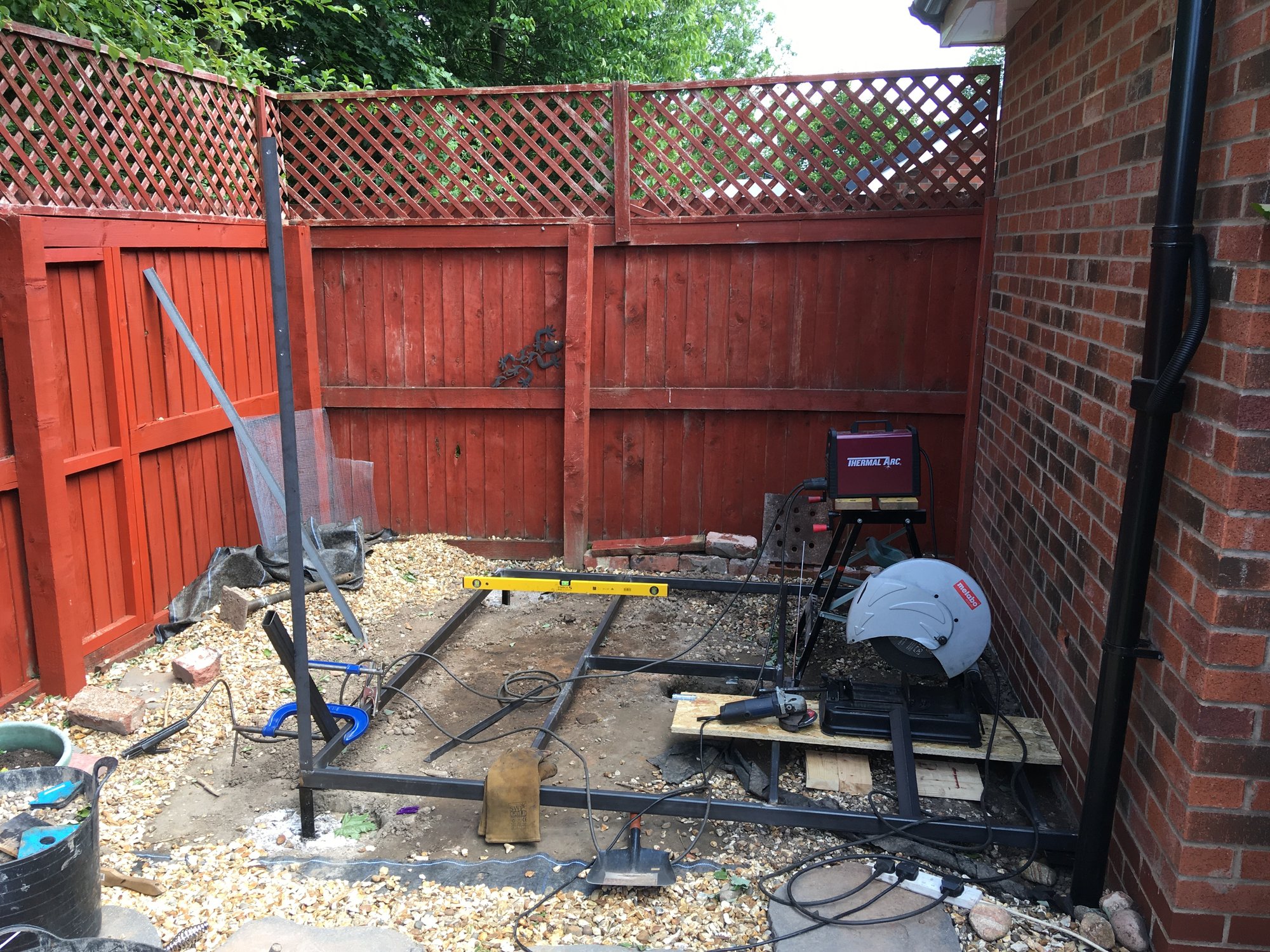

Made some large angle plates and resin bolted them to the wall. The idea being that the shed base would just sit on these but not be fixed to allow some movement and act as a pivot point.

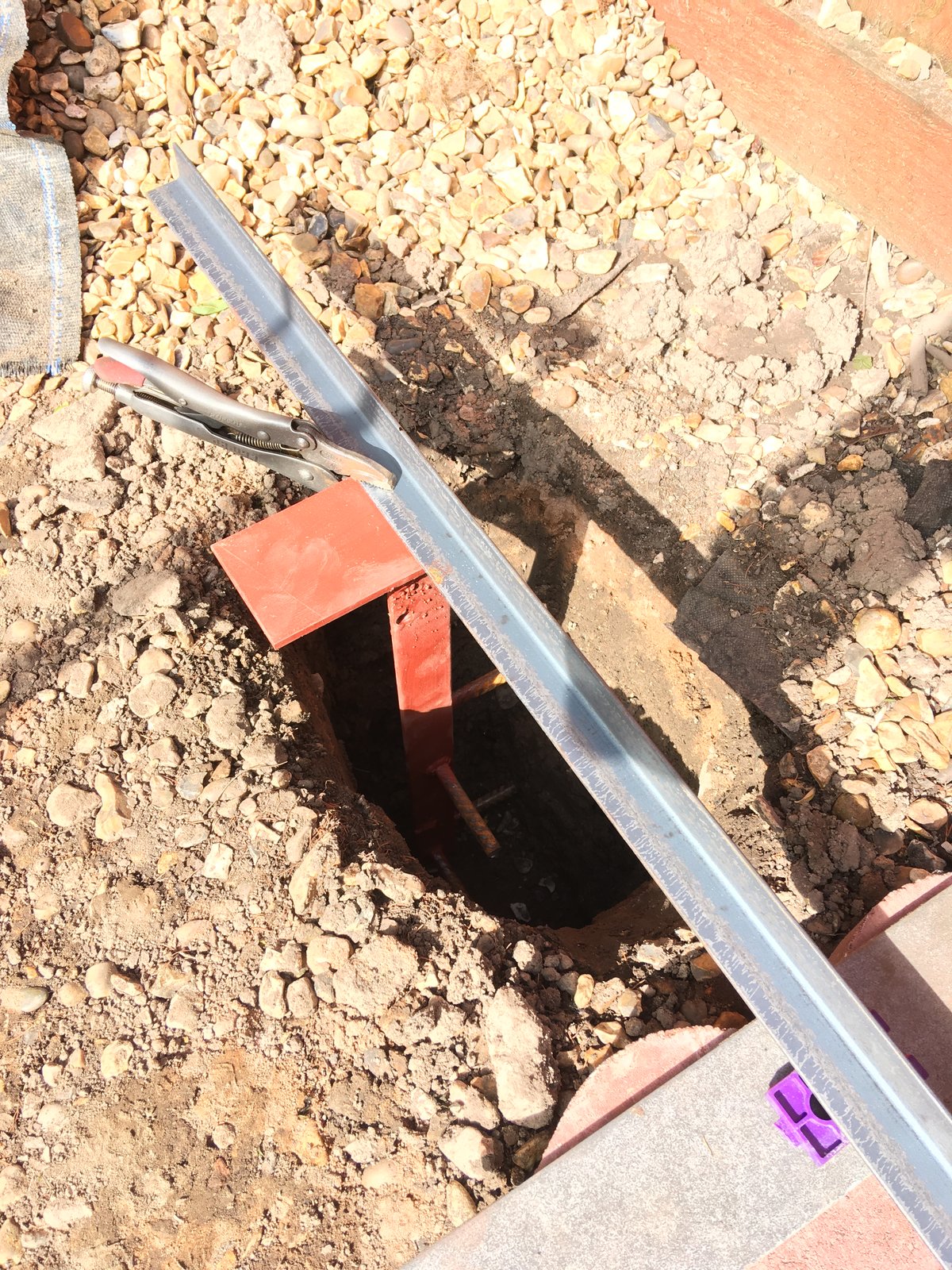

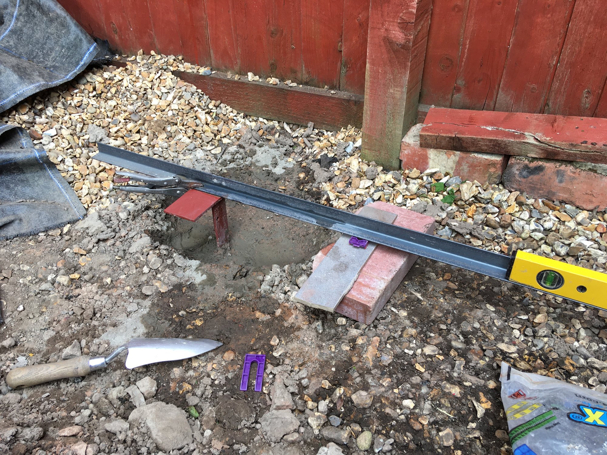

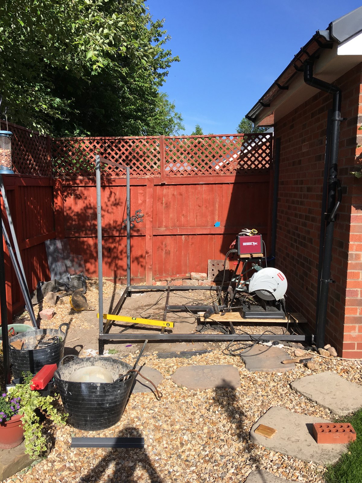

There would then be 3 piles into the ground. I dug down till I hit clay, about 500mm.

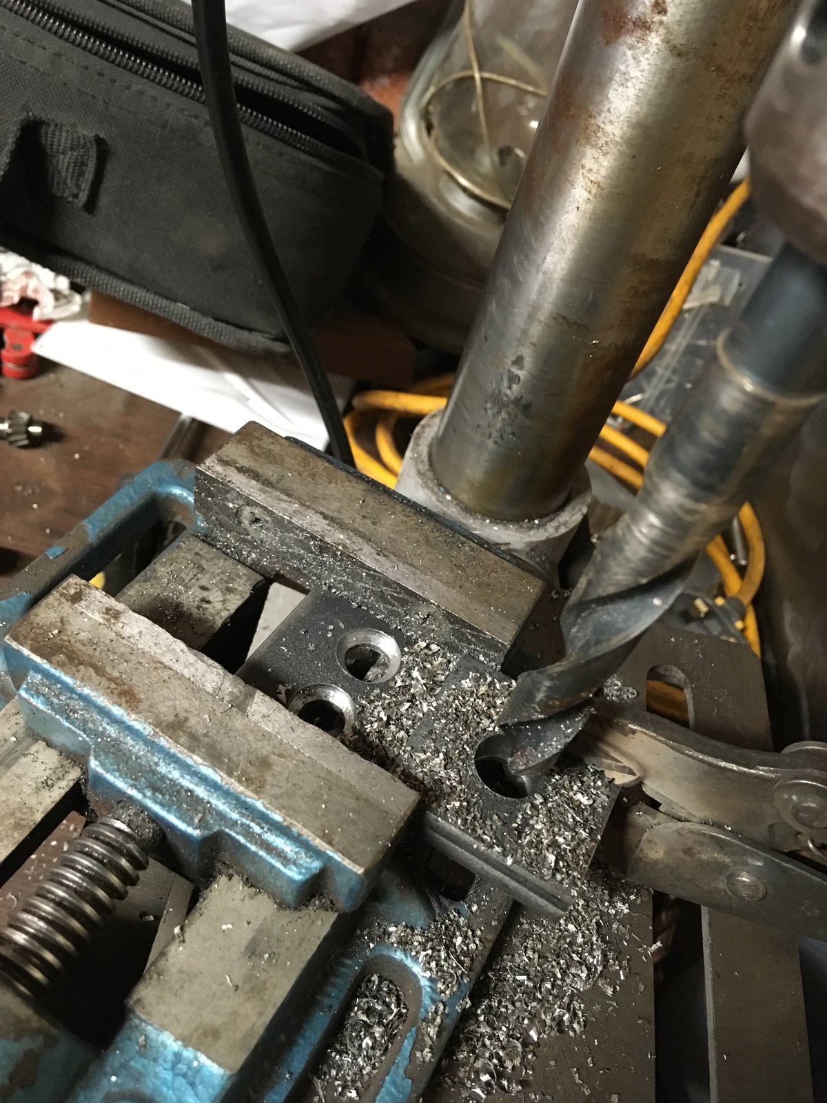

Made some angle iron pieces with rebar welded to them and a plate ontop that the base would bolt to.
Levelling them up I then postcreted them in

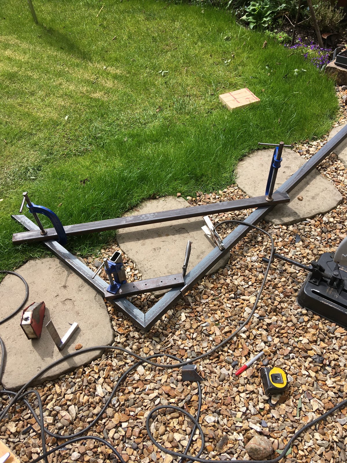

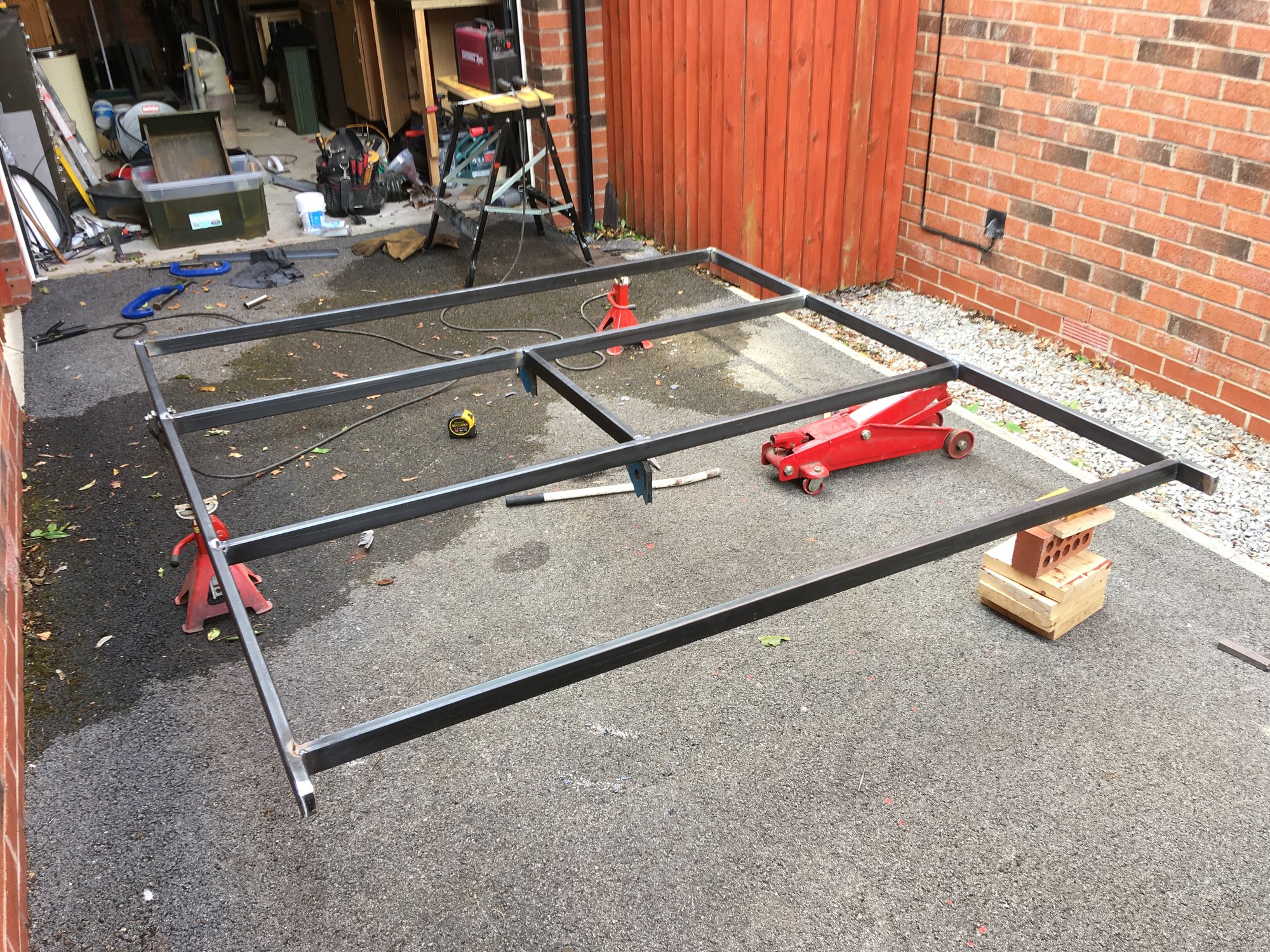

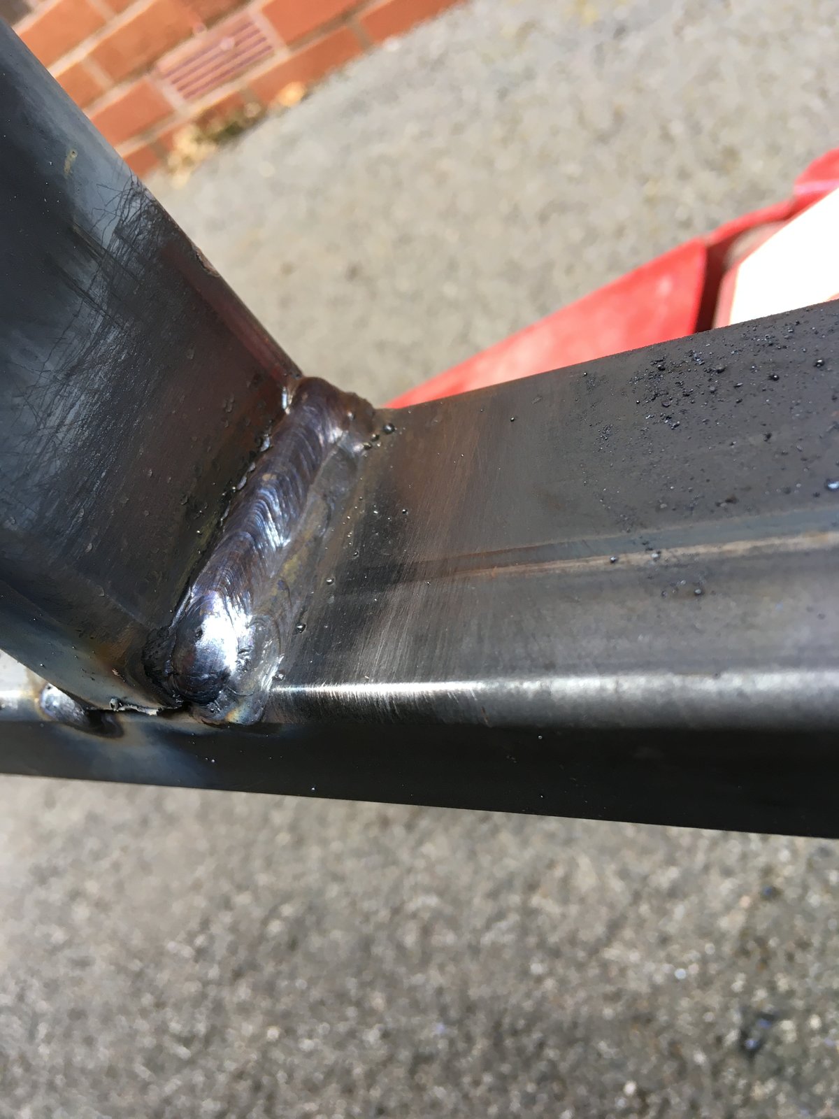

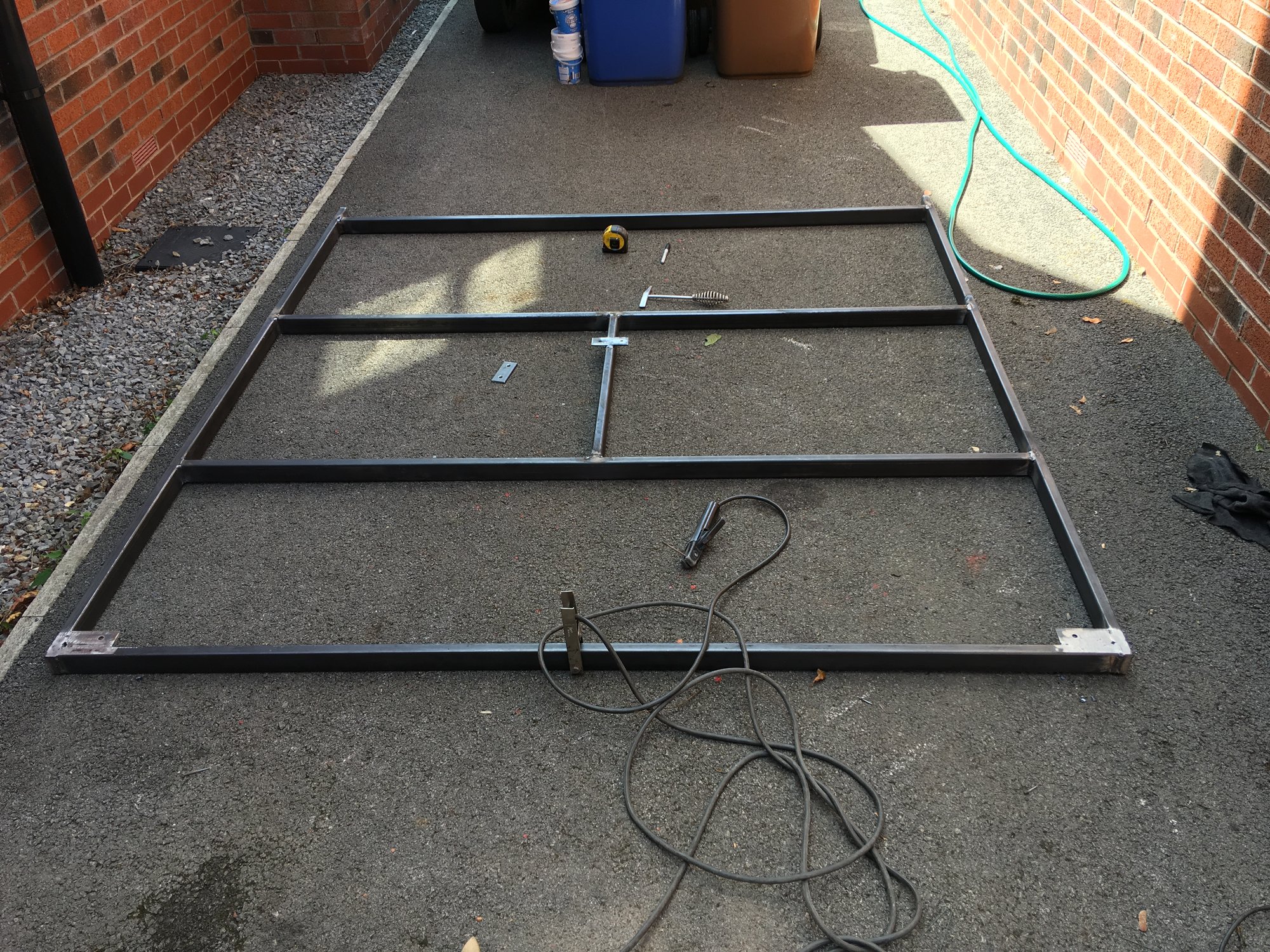

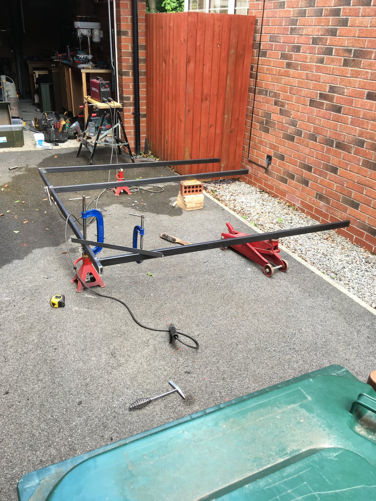

With those in place it was time to make the base. It measures 2m x 2.1m and is 50x25x2.5mm RHS.
You can see the two ends closest to camera that will sit on the wall plates.
Despite how sketchy the fabrication method looks it did turn out perfectly flat, I was more surprised than anyone
In position. The middle pile isn't in yet. That was going to be done when I could bolt it to the base for a level.

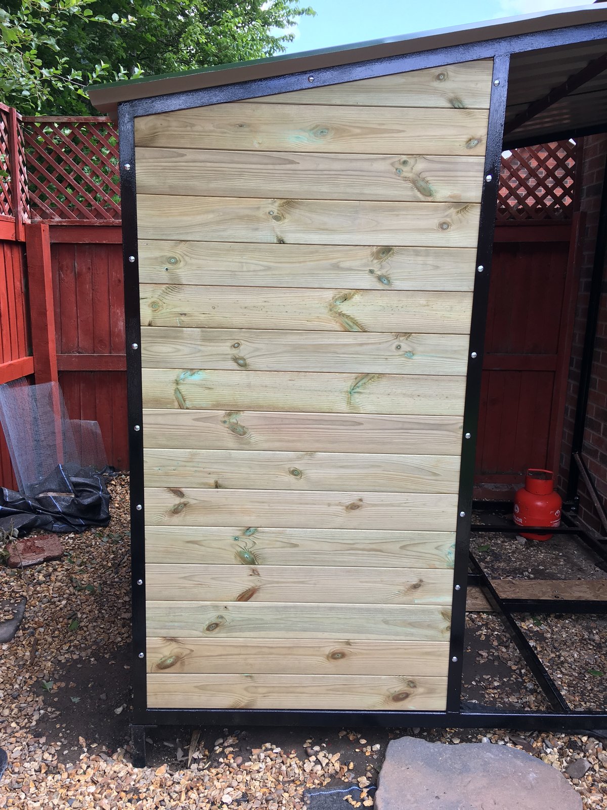

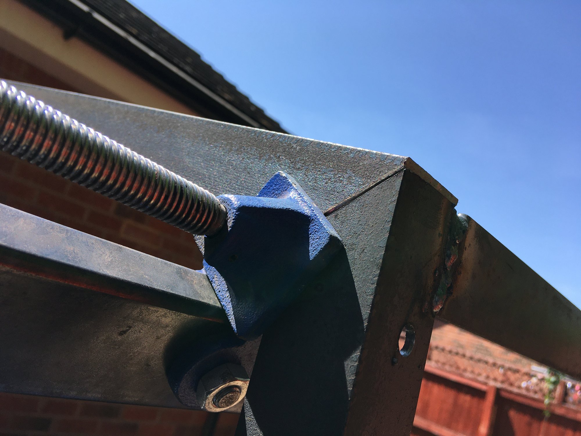

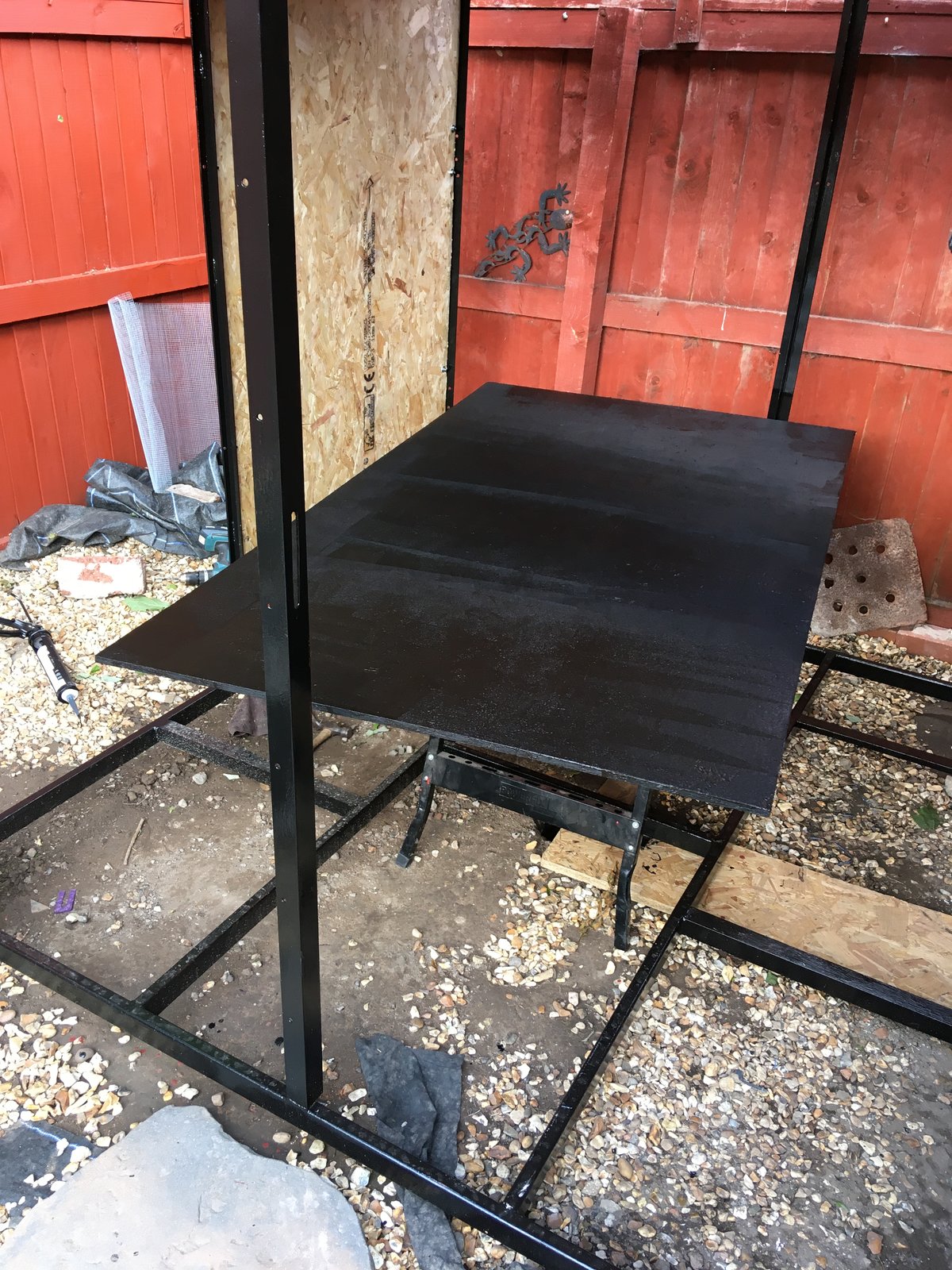

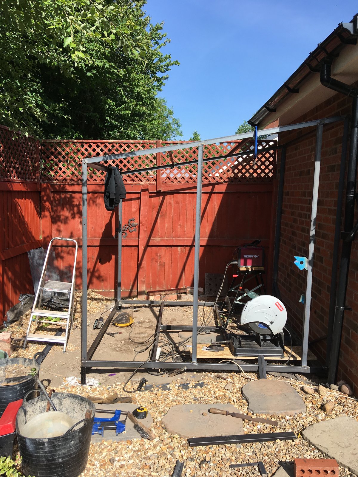

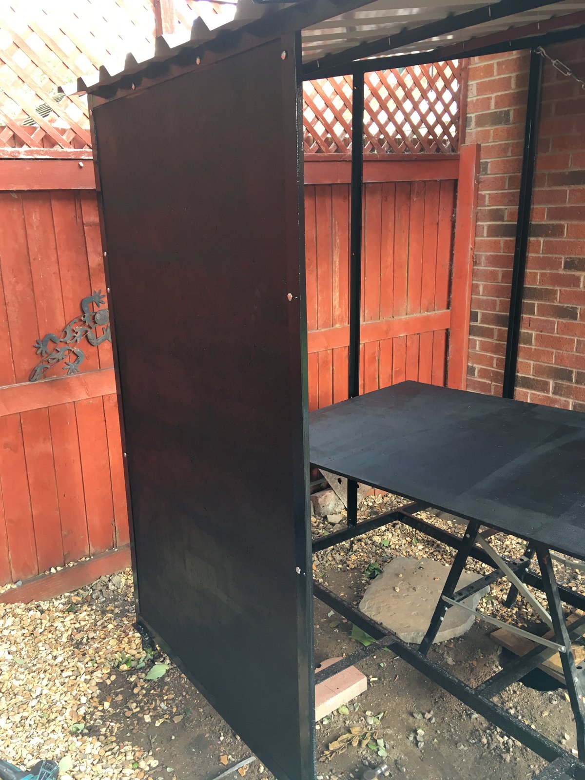

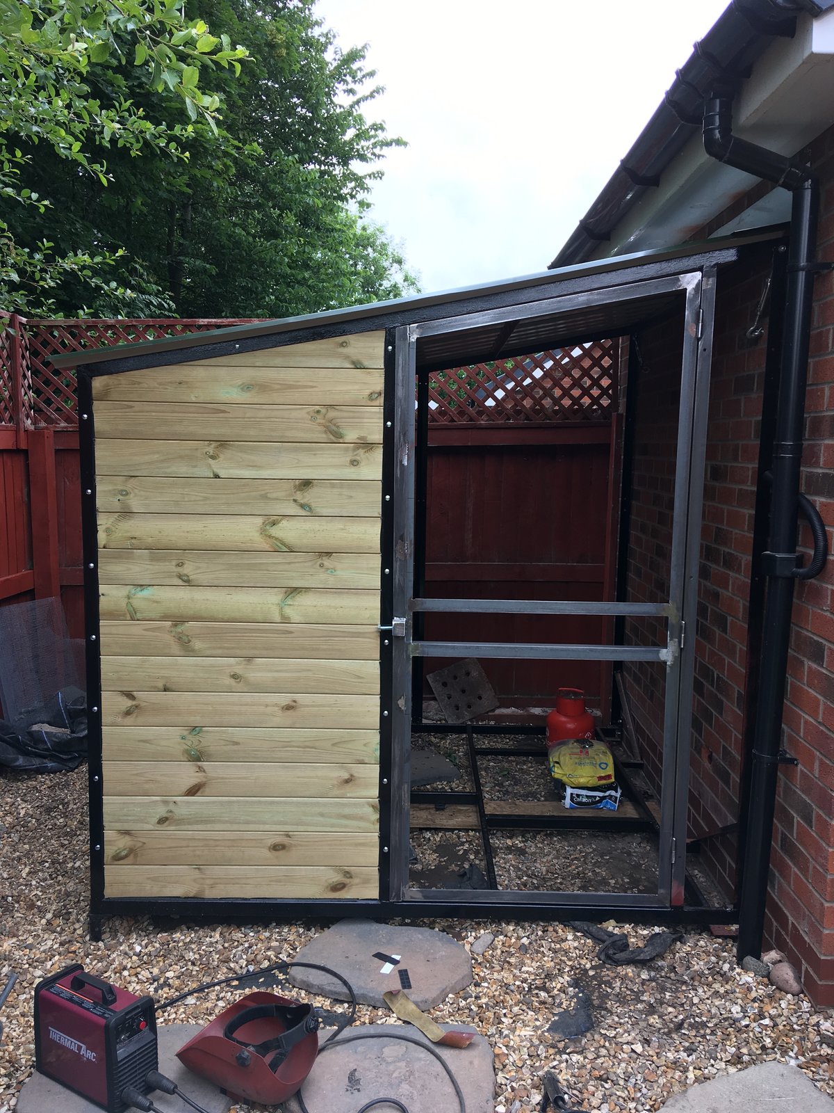

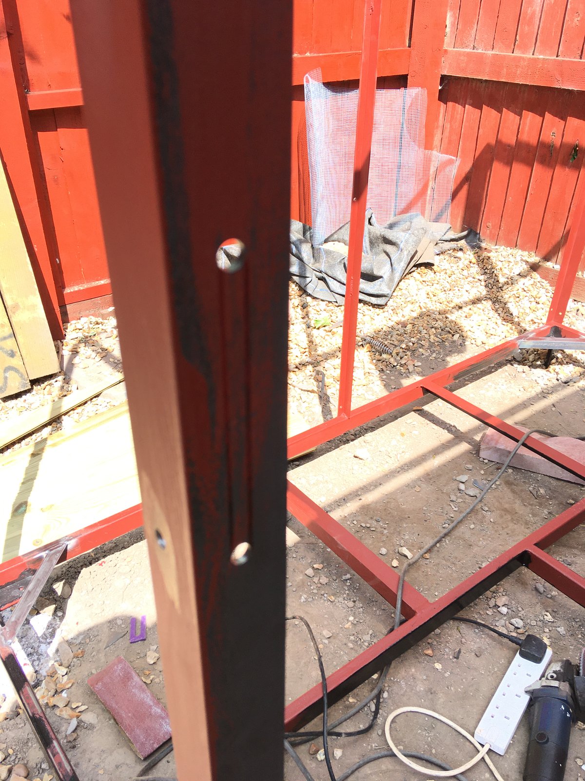

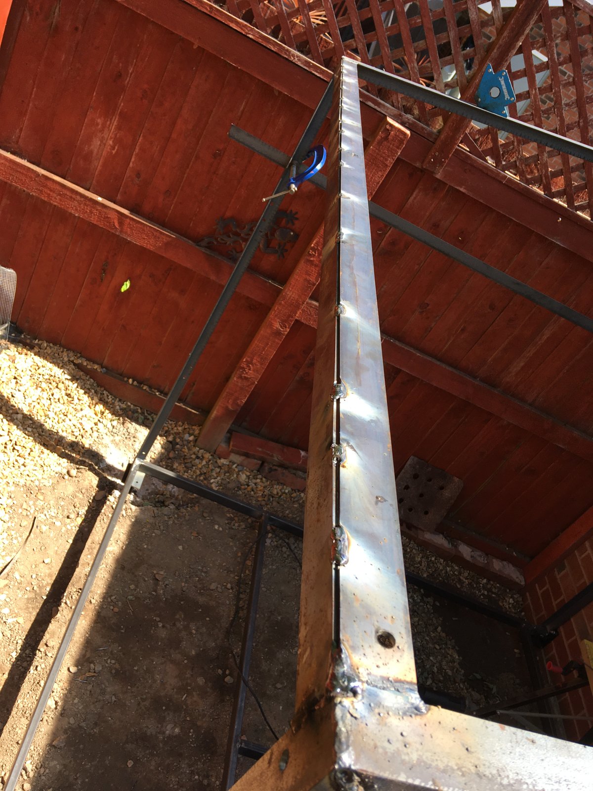

Next stage was some walls. I decided to go for angle so I could easily bolt in some wood infill and went for 40x40x3. This would prove a mistake.
Continued...
Continued...

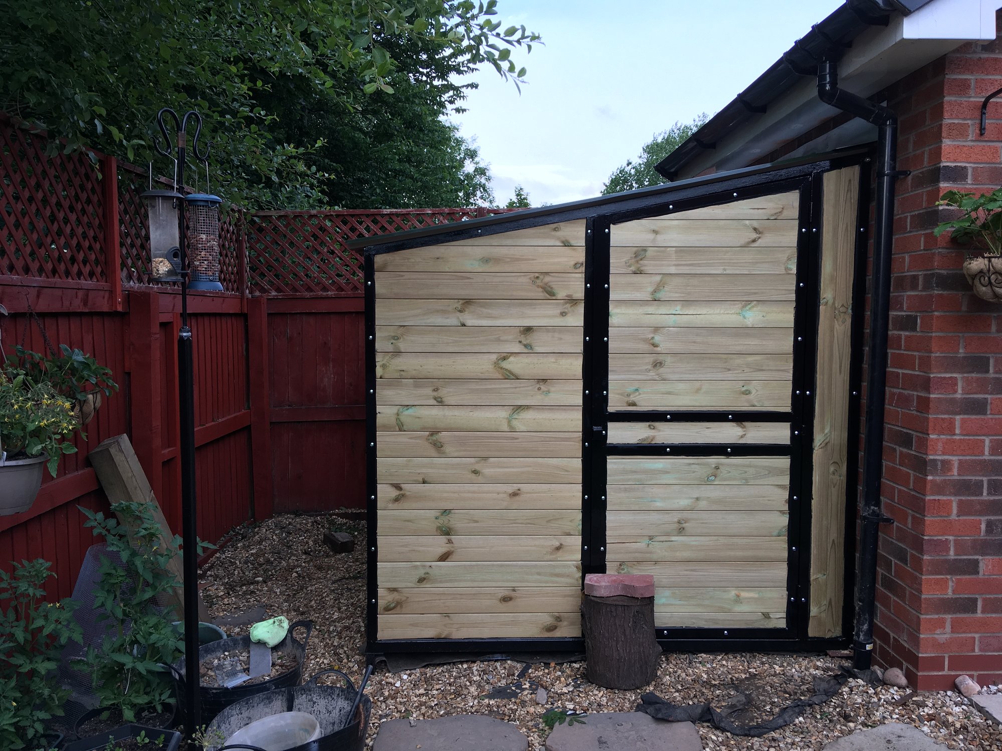

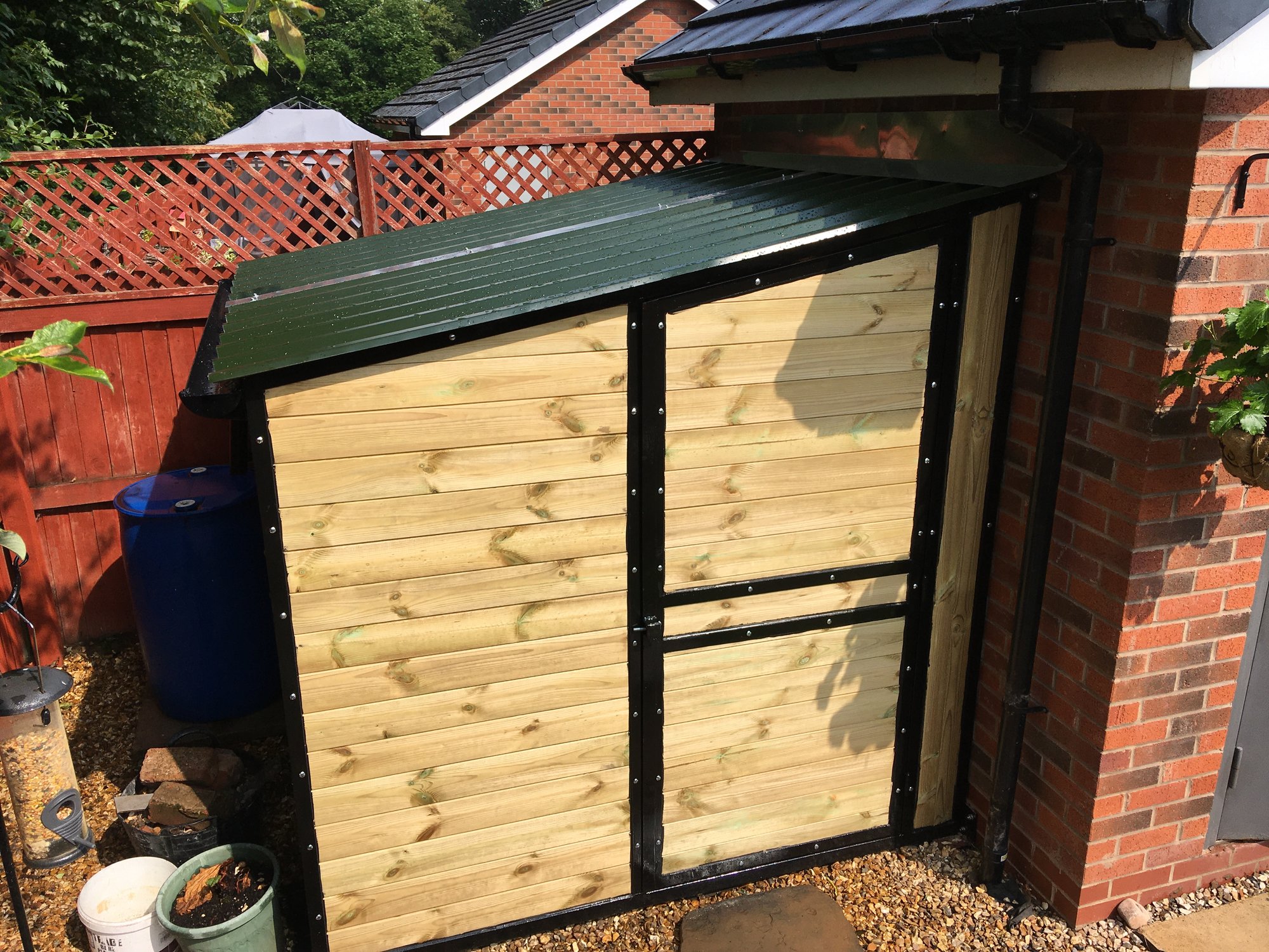

will continue the write up tomorrow.

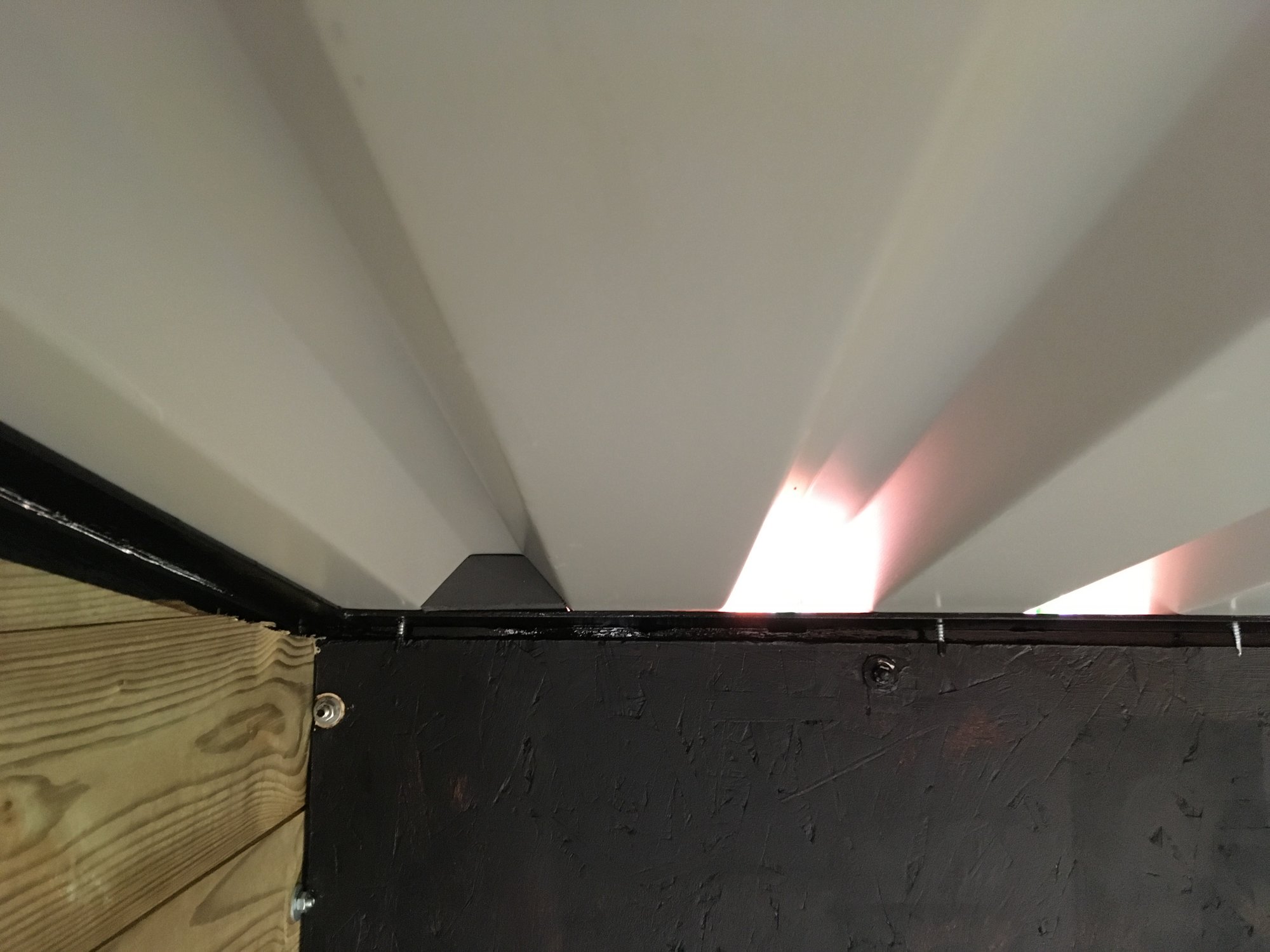

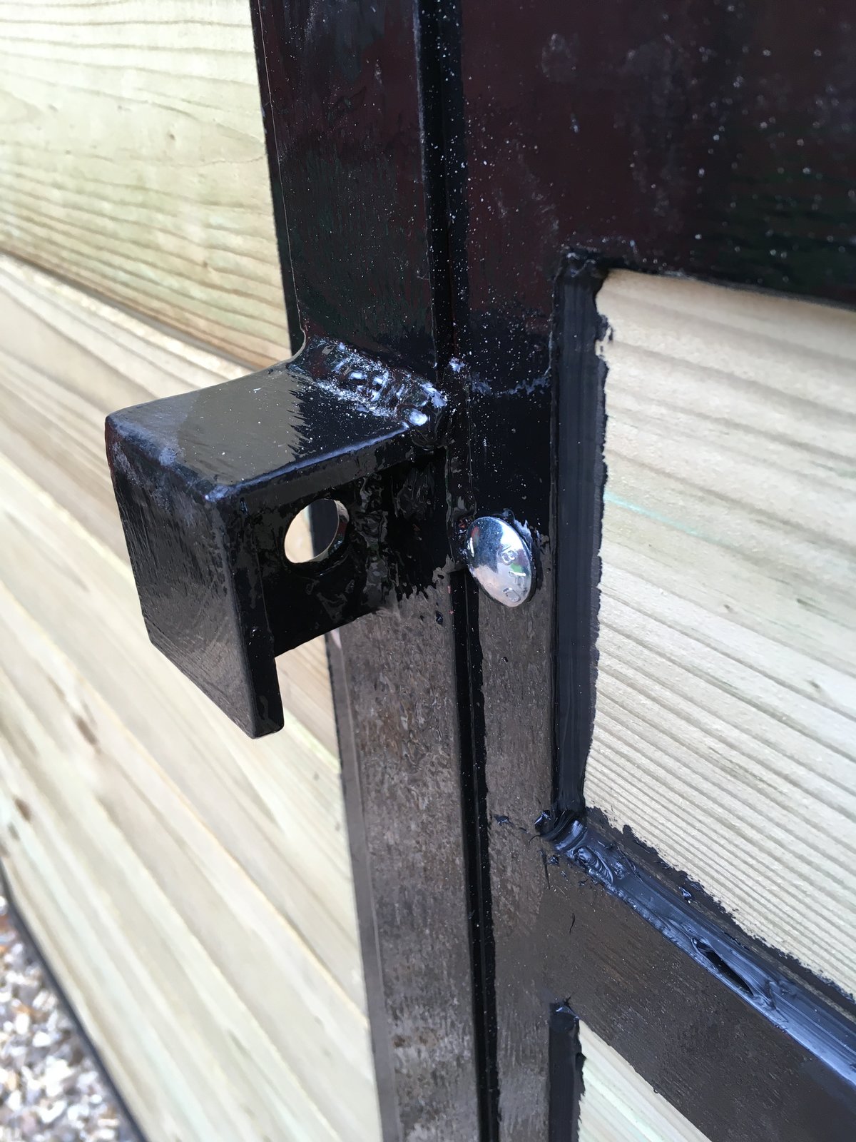

. Out with the grinder to grind them back. Door finally on and closable.
that there is room to bolt this plate into the slot using some countersunk heads. A padlock can then be put through the holes to lock it closed.

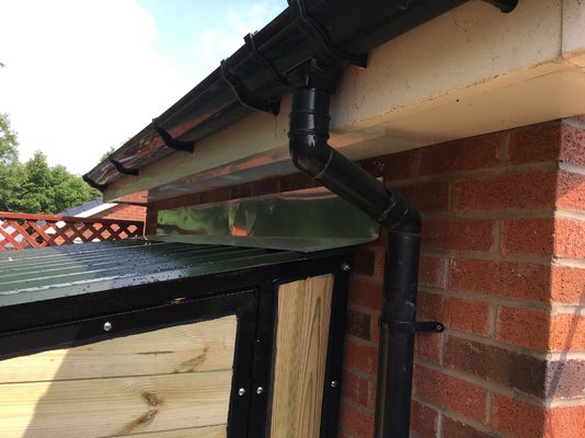

I've got all the tools for it but have just never been any good at sealant. Again hindsight I should have used clear instead of black but hey ho.
