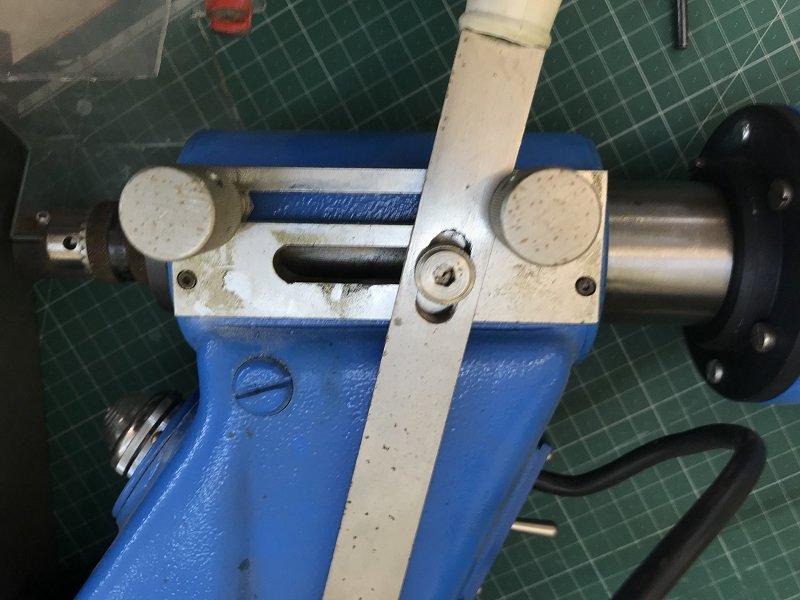

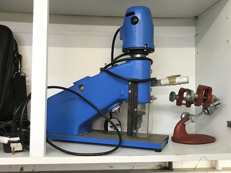

I will of course. I have started it actually, it's a scratch-built unit rather than a spindex conversion. I've spent a couple of evenings reading up and come up with a plan for a small distributed-orifice unit based on some induction-hardened rod in a cast iron liner but I don't have a sensitive drill to drill the tiny holes so I might have to go for bigger holes and suffer the extra air consumption.
Getting rid of that green wheel for a nice AlOx wheel will make a huge difference for you.
