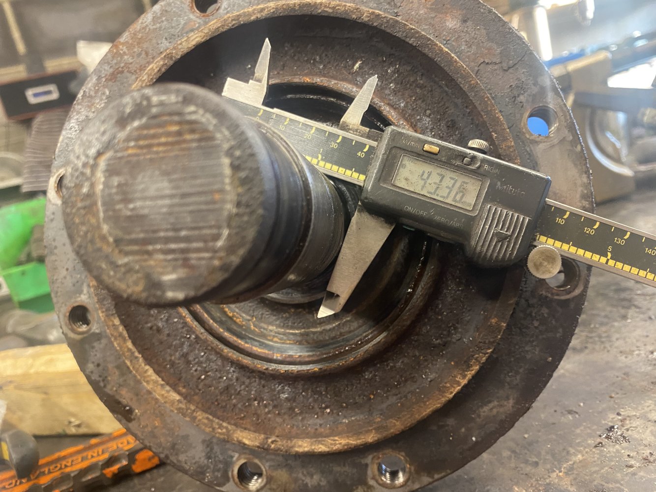

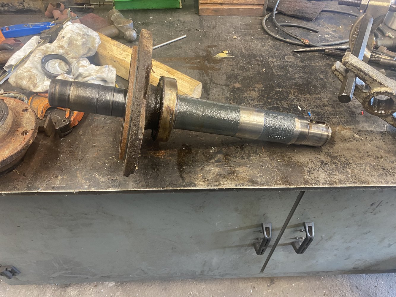

I’m in the process of repairing a tractor drum mower, one of the bearing seats on a drum shafts is badly worn:
Where the callipers are the shaft should be 45mm for a 6209 bearing, at the end of the shaft there is a 40mm bearing seat which is ok. The shaft appears to be cast steel, I have looked at replacements but these are into 4 figures
