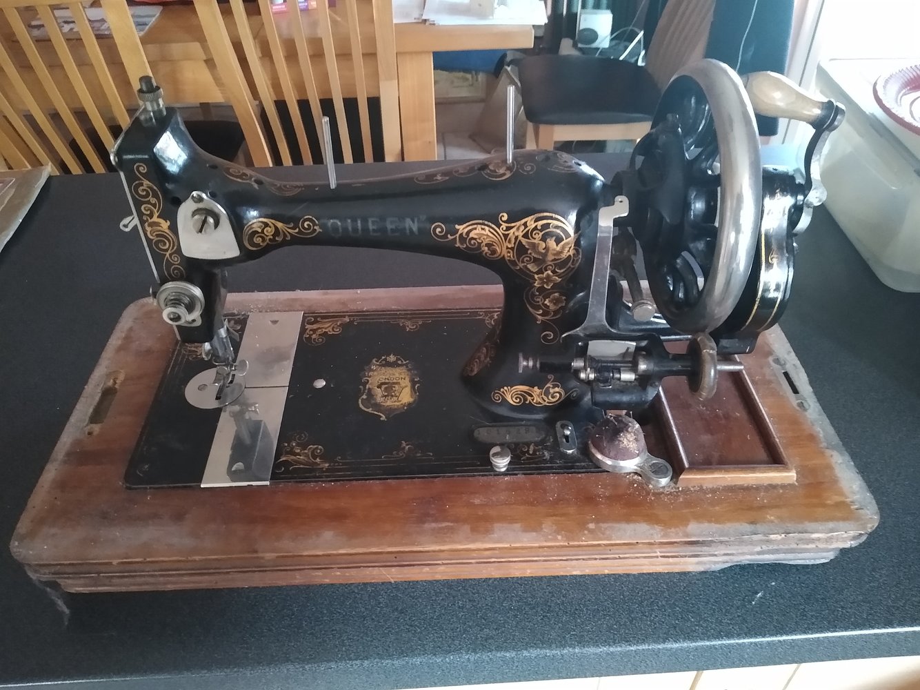

I didnt realise one was supposed to?
That is likely to be your trouble then! If you don't the threads will pull out of the needle and likely cause the bobbin to foul up. You can either hold the tails when you start, or hold the tails and do a manual stitch to hold the tails, then carry on as normal.
