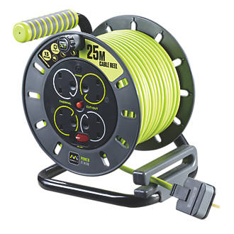

Nah, wrong colour, you need a different oneAh i sussed it to make it sooooooooooooooooooooooooooooooooooooo easy this, dont even need to get the wiring signed off.
Ill get one of these things, i used to use one many moons ago for many years and worked a treat.

All tis sounds OTT, i am not saying its all cods wallop but in a way this is just ashed with a welder that runs from a 13amp plug. two 300w pillar drills and lesser watt bench grinder and buffer. i have seriously for years used and extension lead for these item with no problem. Just now as it is i have a good size workshop to me i want all fixed in place.
are folk over thinking it or is the regs that serious now ?

See OTT there ha haWith the added bonus that in the winter that extension lead can be laid along the path to the garage to keep it clear of snow...
See OTT there ha ha
