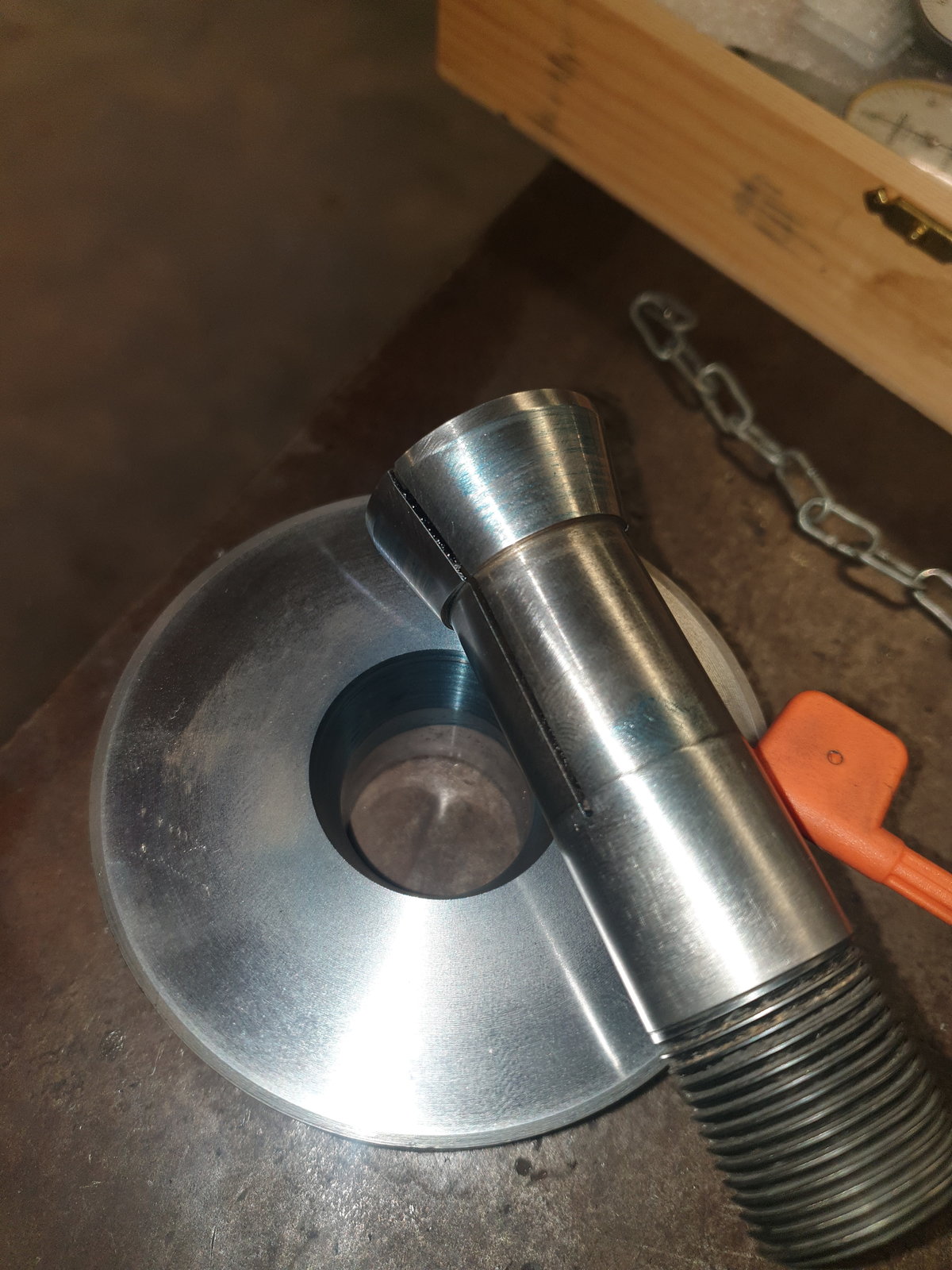

Thanks for all the info!
Had another go and now used the radius DRO setting instead of the diameter setting and victory
, did a test with prussian blue and very happy with the result on the test piece! Blued the chamfer in the testblock and then seated the collet, got blue marks nearly all the length of the taper.
