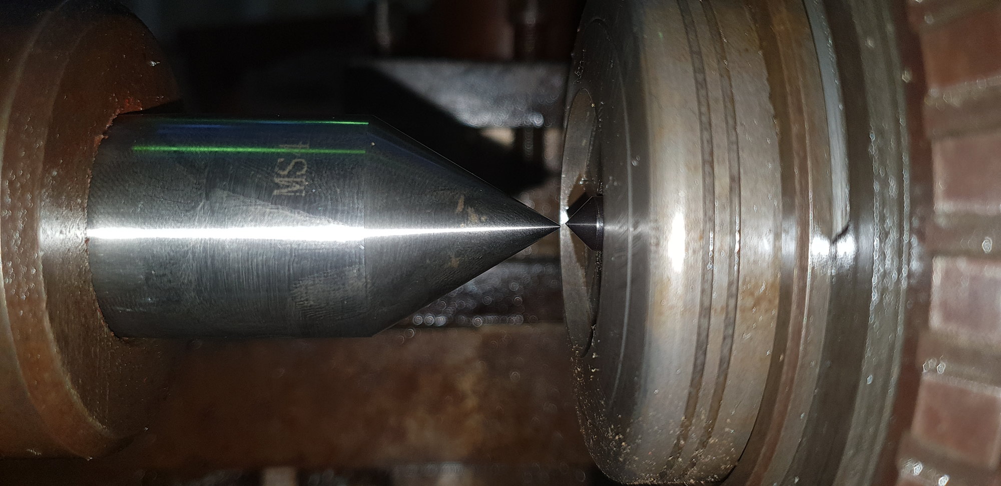

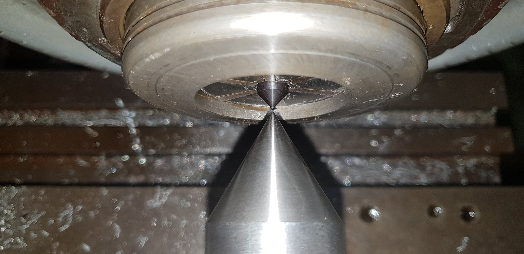

Same as Brad and Clive here I turn a part to mirror the tailstock ram and run a dial across. You can do the same on the top and check the heights at the same time.
