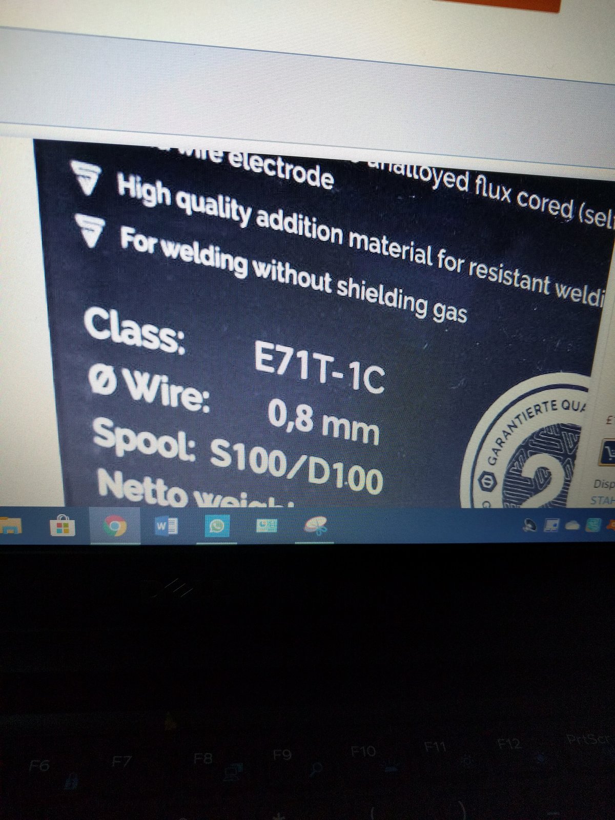

I was looking for some self shield flux core and found the following:
3× MIG MAG Fülldraht E71T-1C Ø 0,8 mm / 1 kg D100 Rolle
Item #: 5520
- Bright, layer wound
- High current carrying capacity and low spatter
- Unalloyed self-shielding flux cored wire electrode
It can be found on Amazon and ebay - however doesn't the 'C' in E71T-1C mean that you have to use CO2 gas with this stuff?
Item #: 5520
It's also the only one of the "hobby" type fluxcore wires that actually gives you proper weld data.
