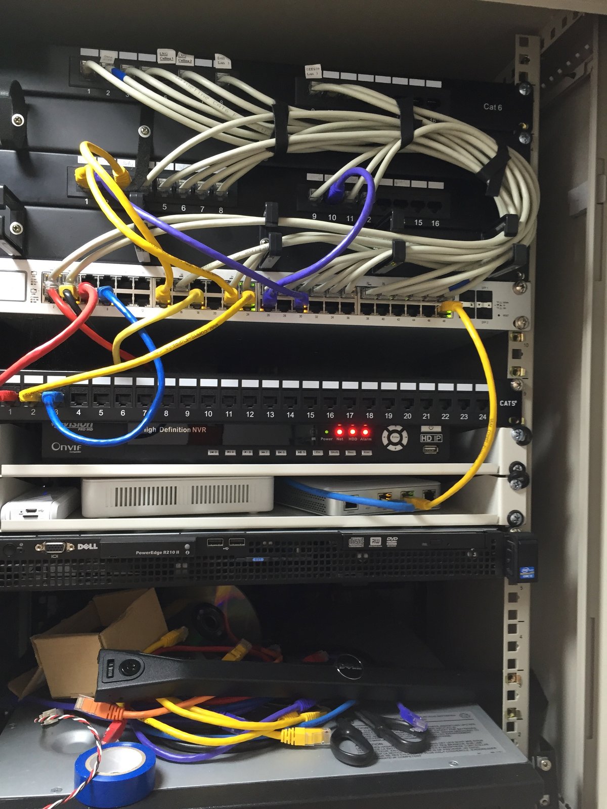

Some people run a setup like RDR, lots of Hikvision fans and NVR fans but generally outnumbered, or at least out shouted by the Dahua and Blue Iris crowd on that forum.
