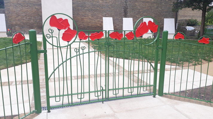

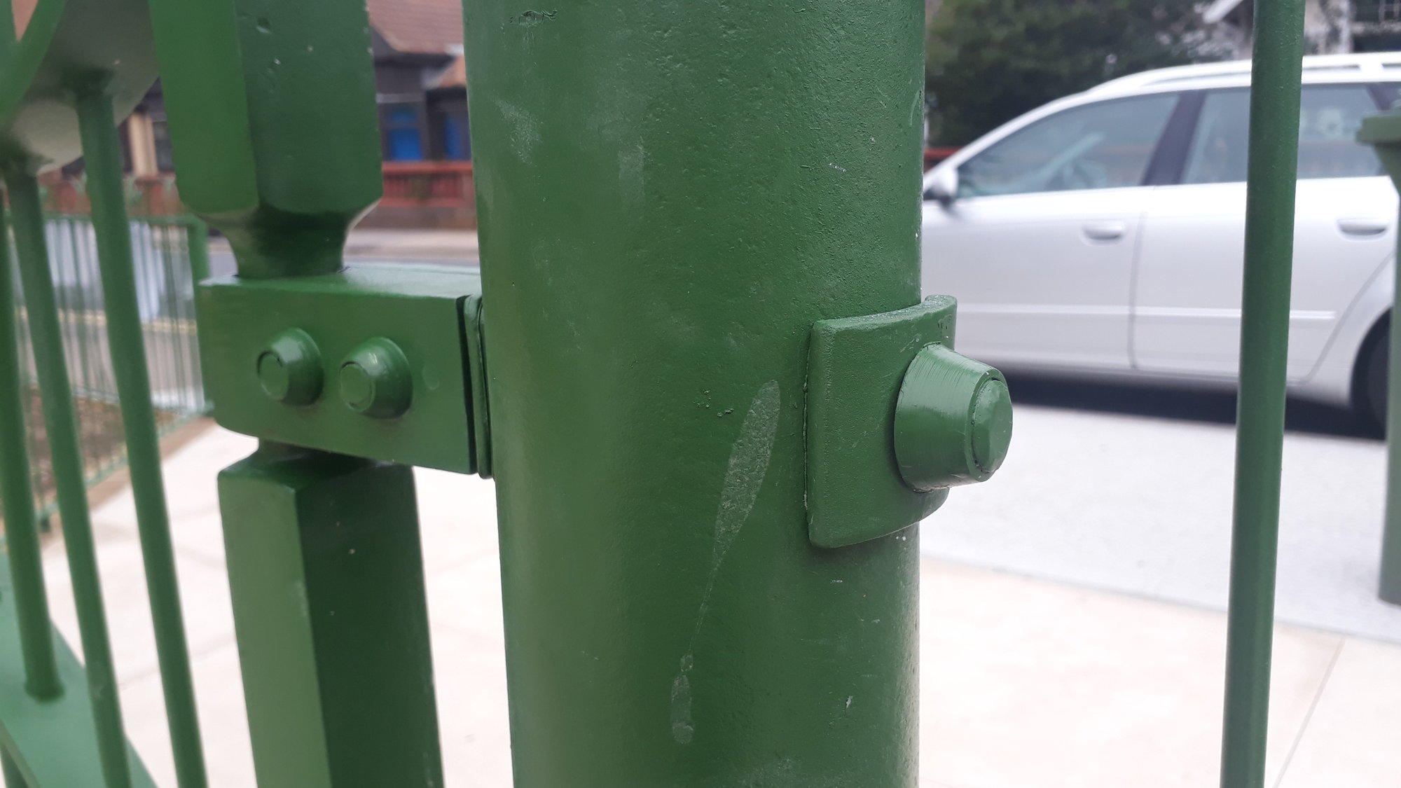

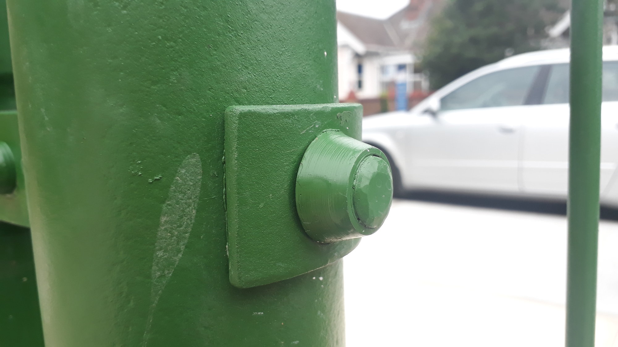

In fairness I never secure my gates from theft.. It's incredibly rare here to have gates stolen. Scrap is low and second hand gates no matter how nice are hard as heck to sell for decent money and very identifiableDo both? Shear nut + pein. That's what I did on some gates I recently finished, though I didn't first cut the thread as Kent does.View attachment 148609 View attachment 148610 View attachment 148611
