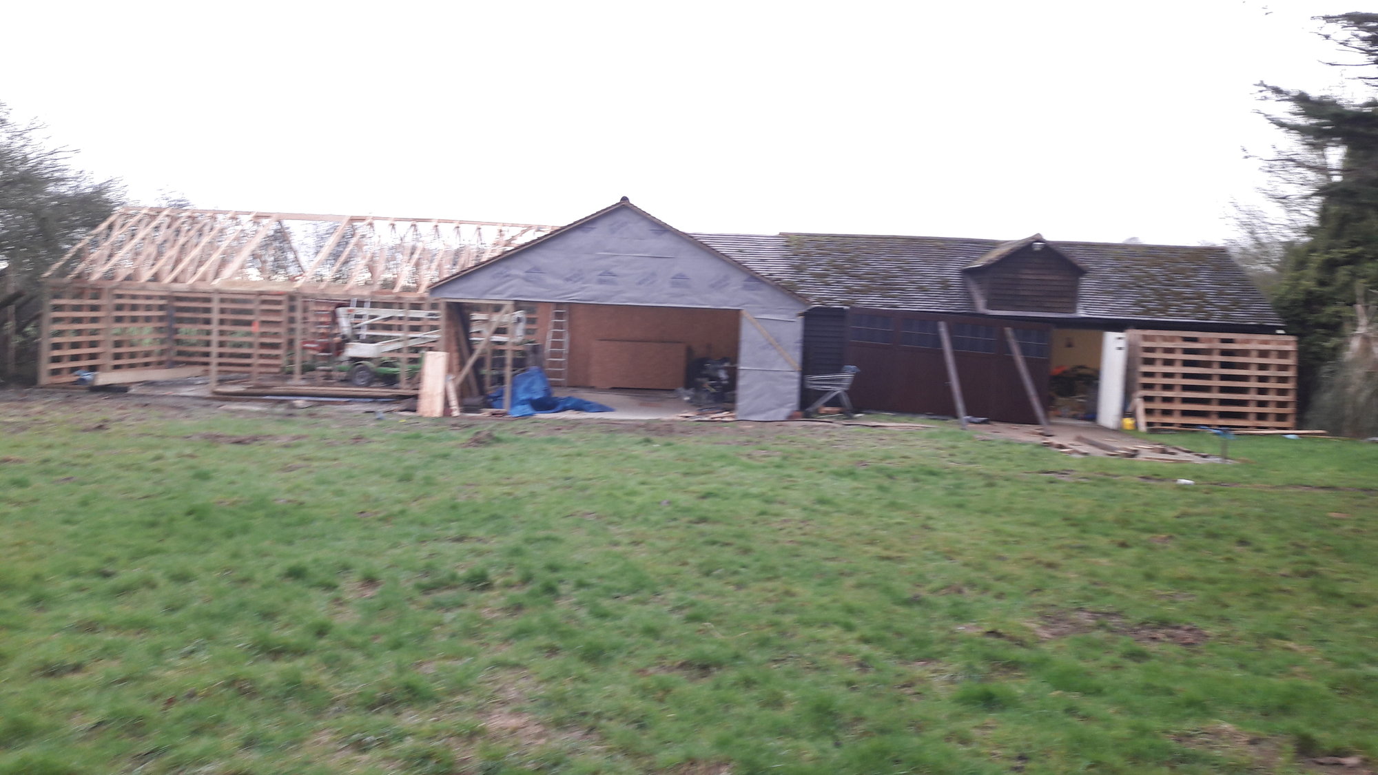

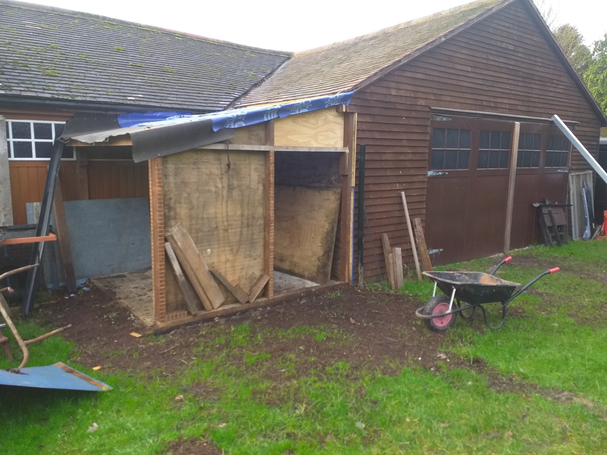

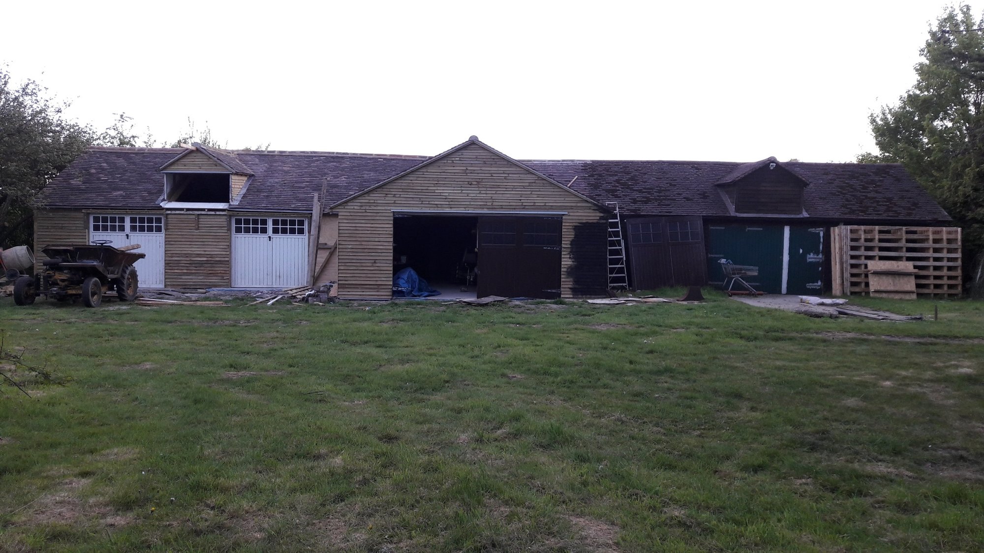

out of 3 mtr x 2 mtr wooden pallets, look for a plastic sheet roofing sheet wholesale place, got mine from TBS plastics in Cheshunt, free, ring of treated fence post timber round the top and bottom, uprights between pallets, slipped rockwool slab down between the gap, breather membrane outside covered with feather edge, ex building site fence ply inside or when that ran out stirling board, roof trusses from ebay modified to suite, second hand clay tiles, £1.00 ebay bid for a whole bungalow roof but I did have to remove, it was four miles away! it did cost me a bit but now have a dry, noise and heat insulated shed that I can heat with an oil filled radiator, and no one can hear me tin bash, just added a sandblasting extension,
