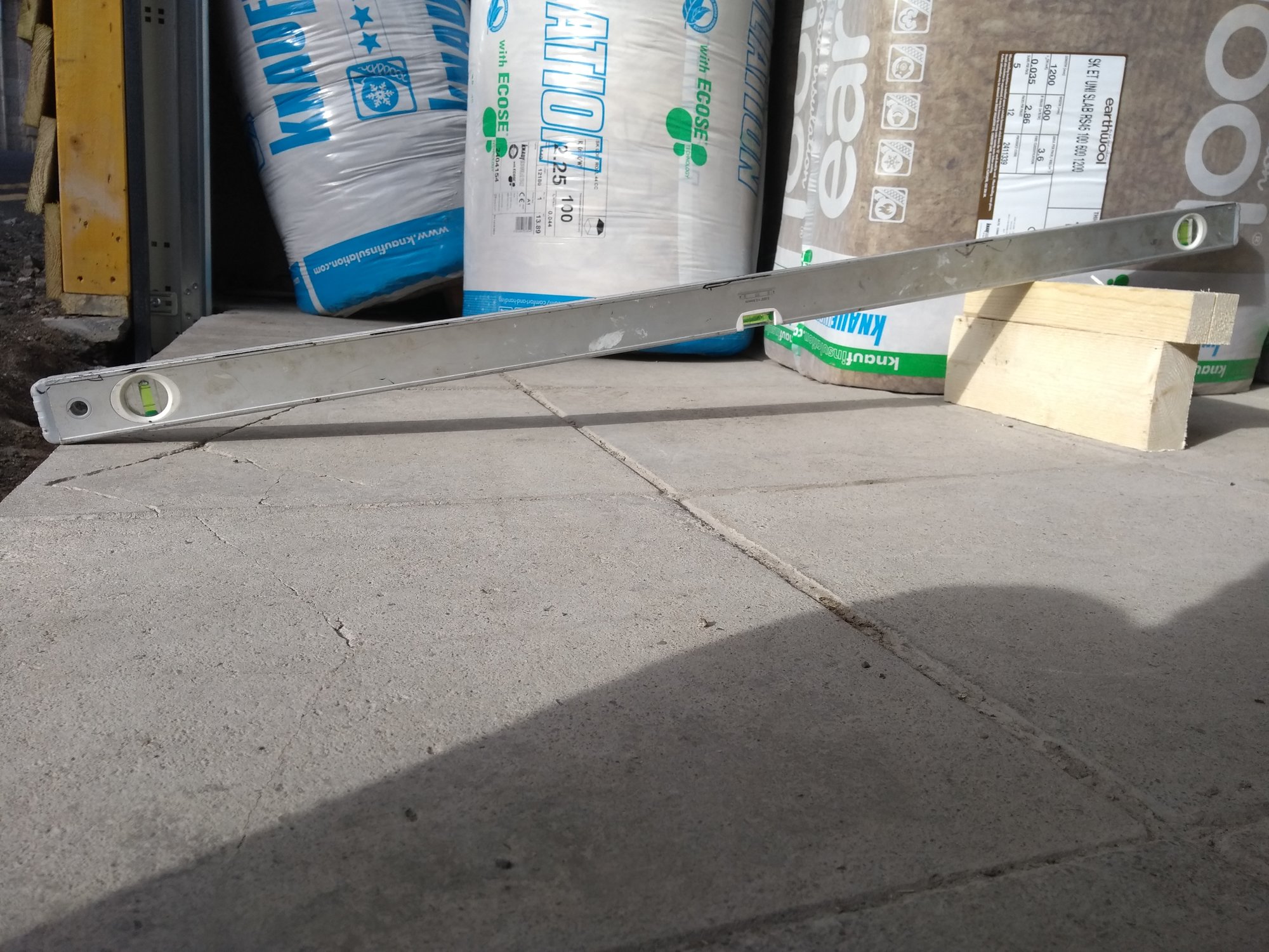

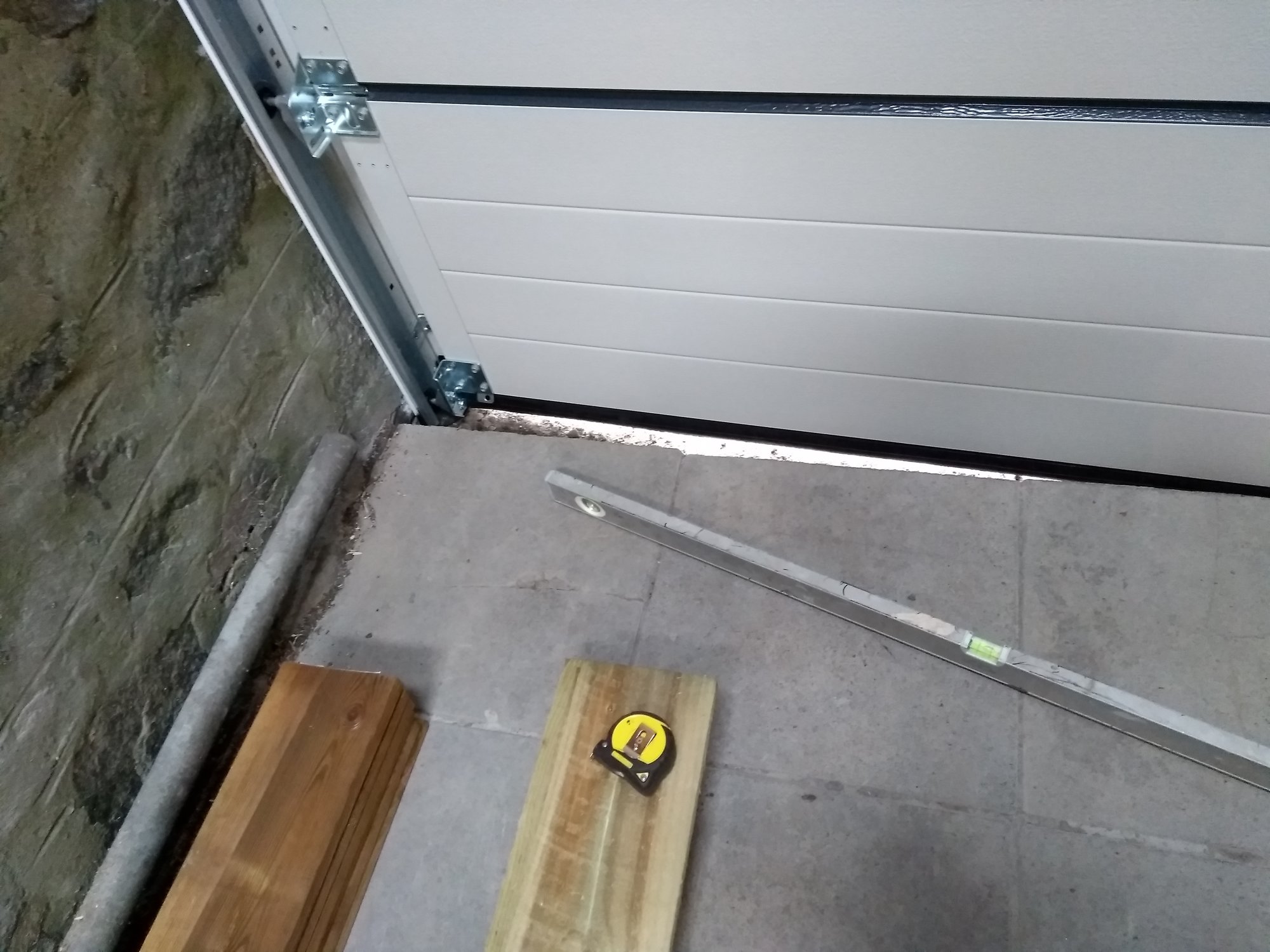

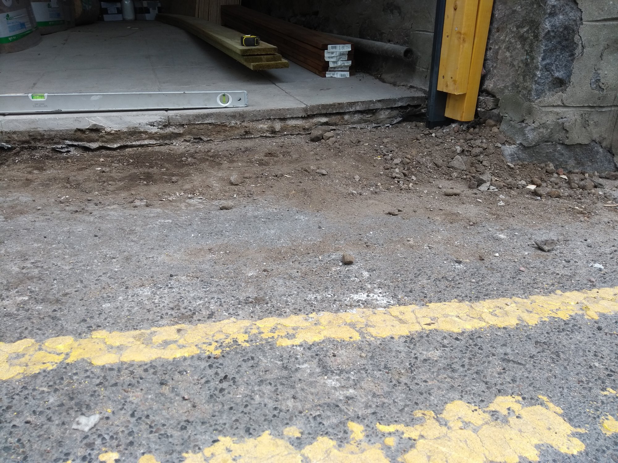

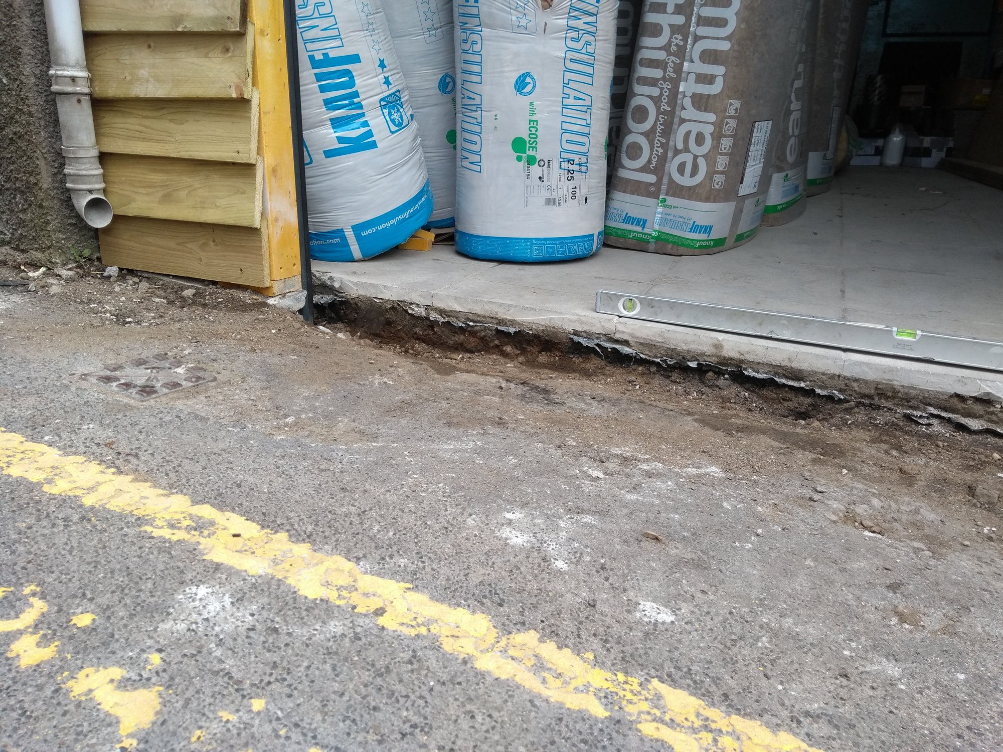

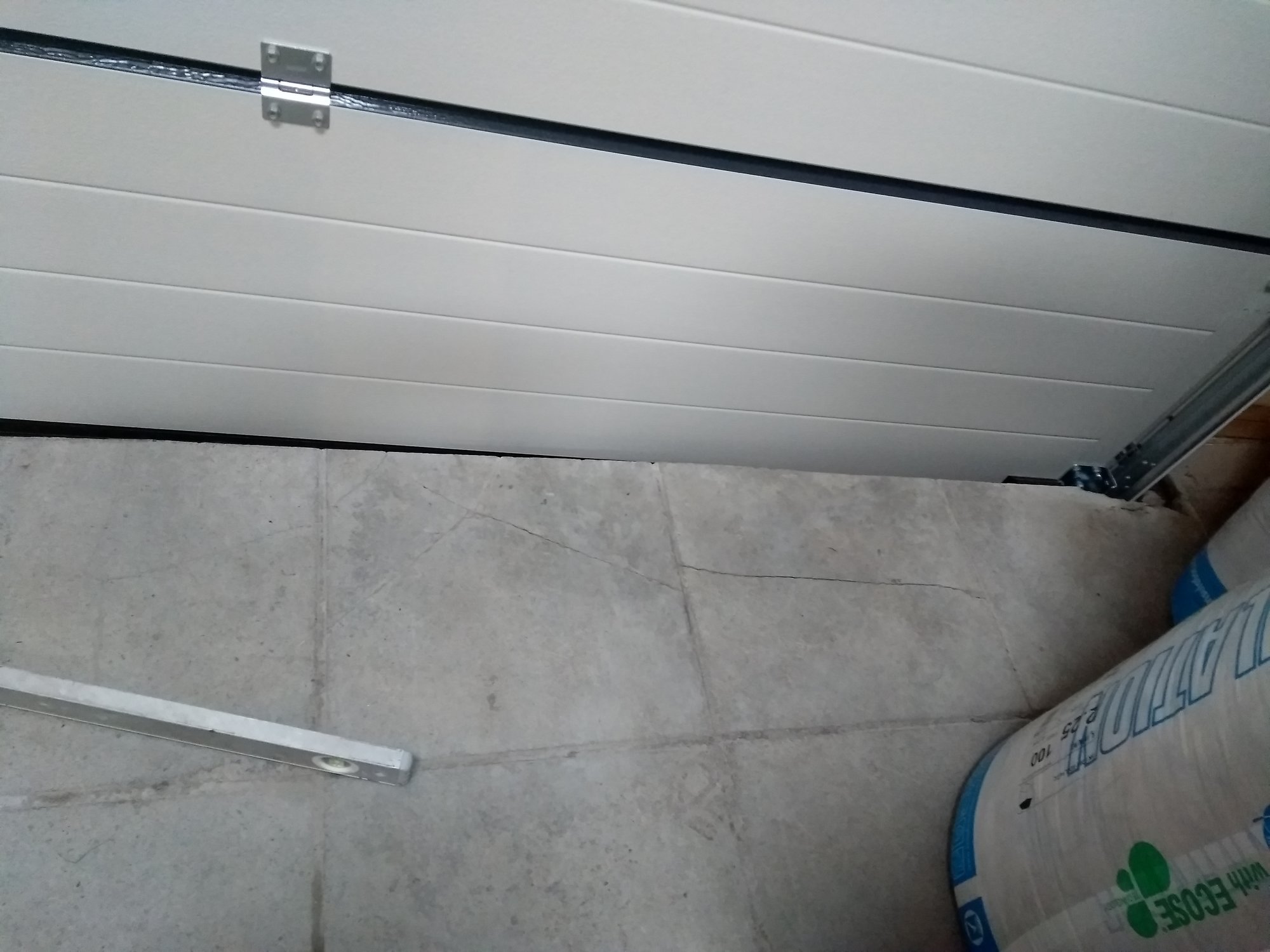

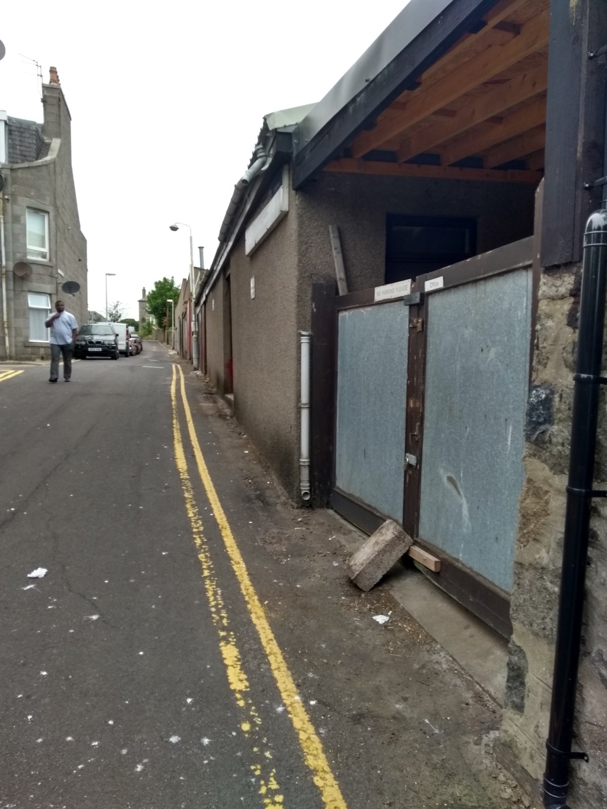

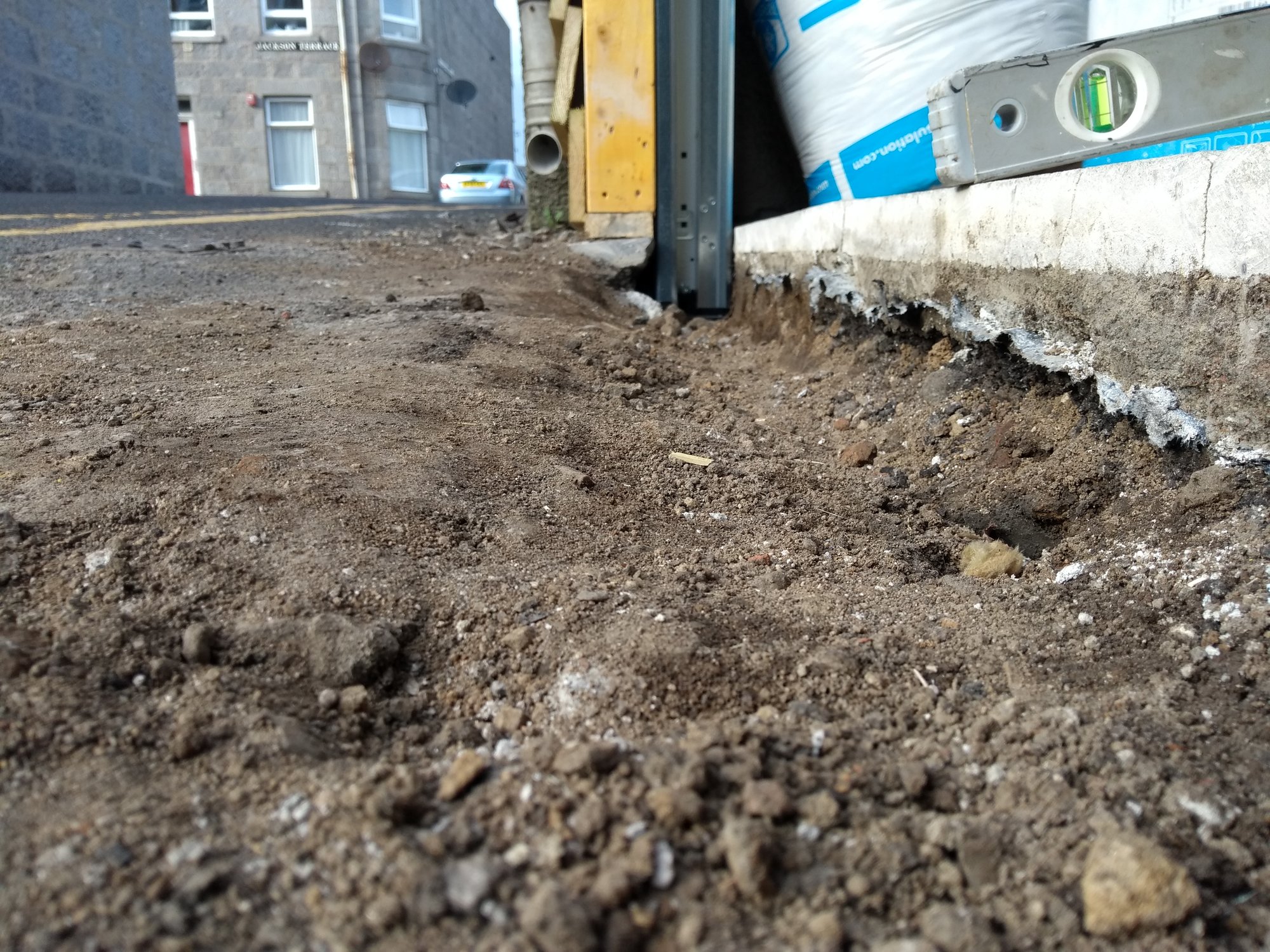

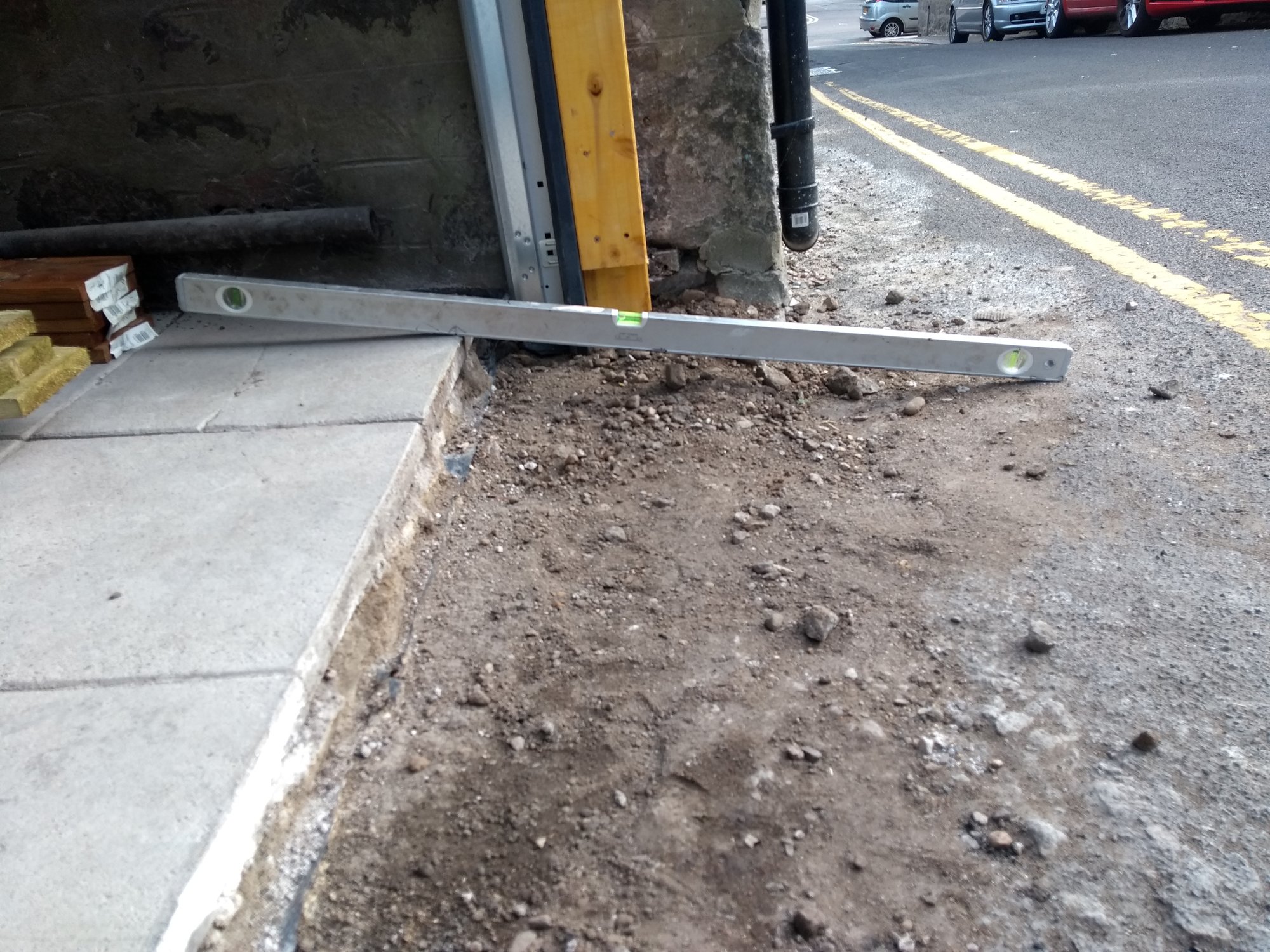

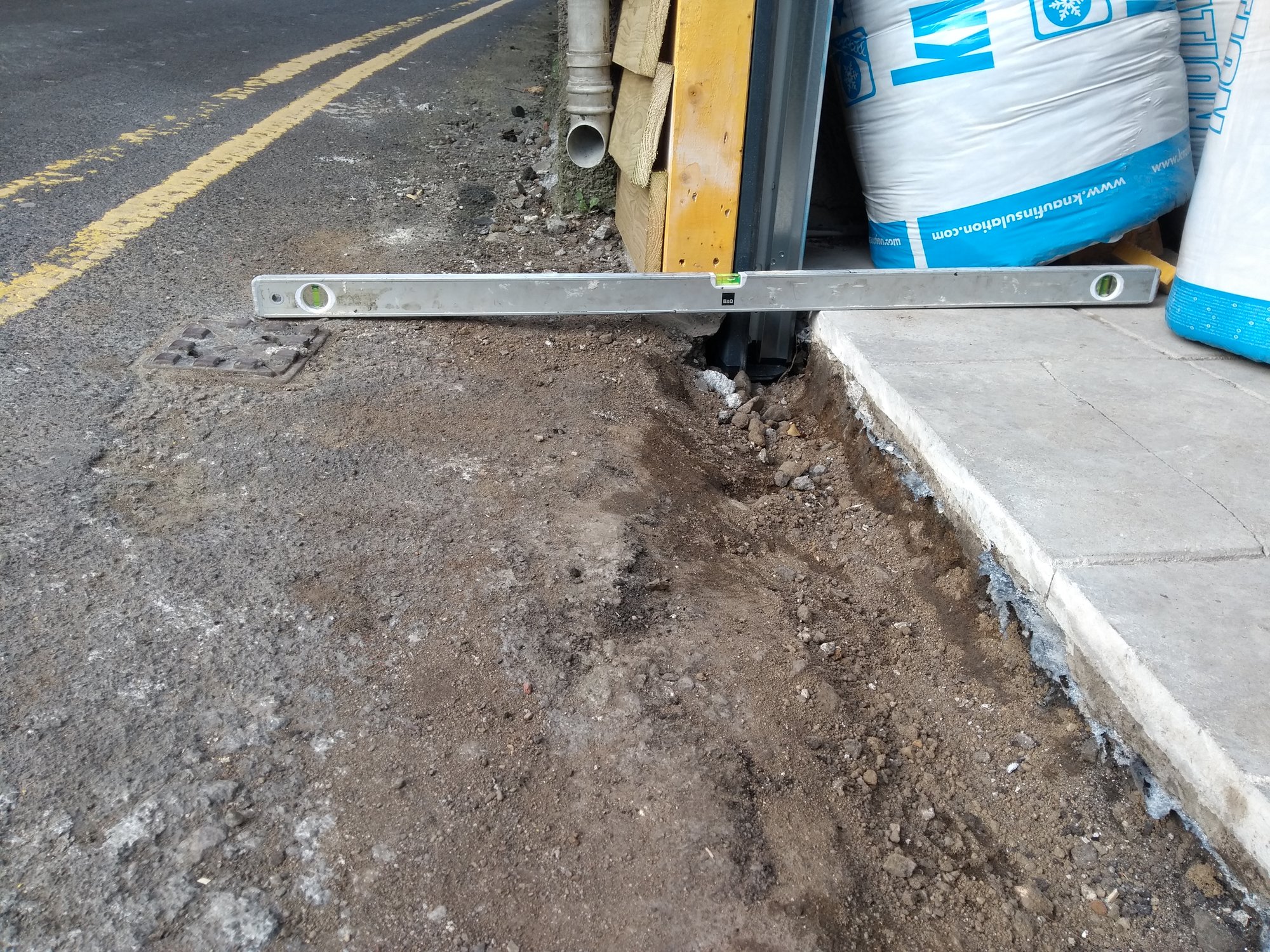

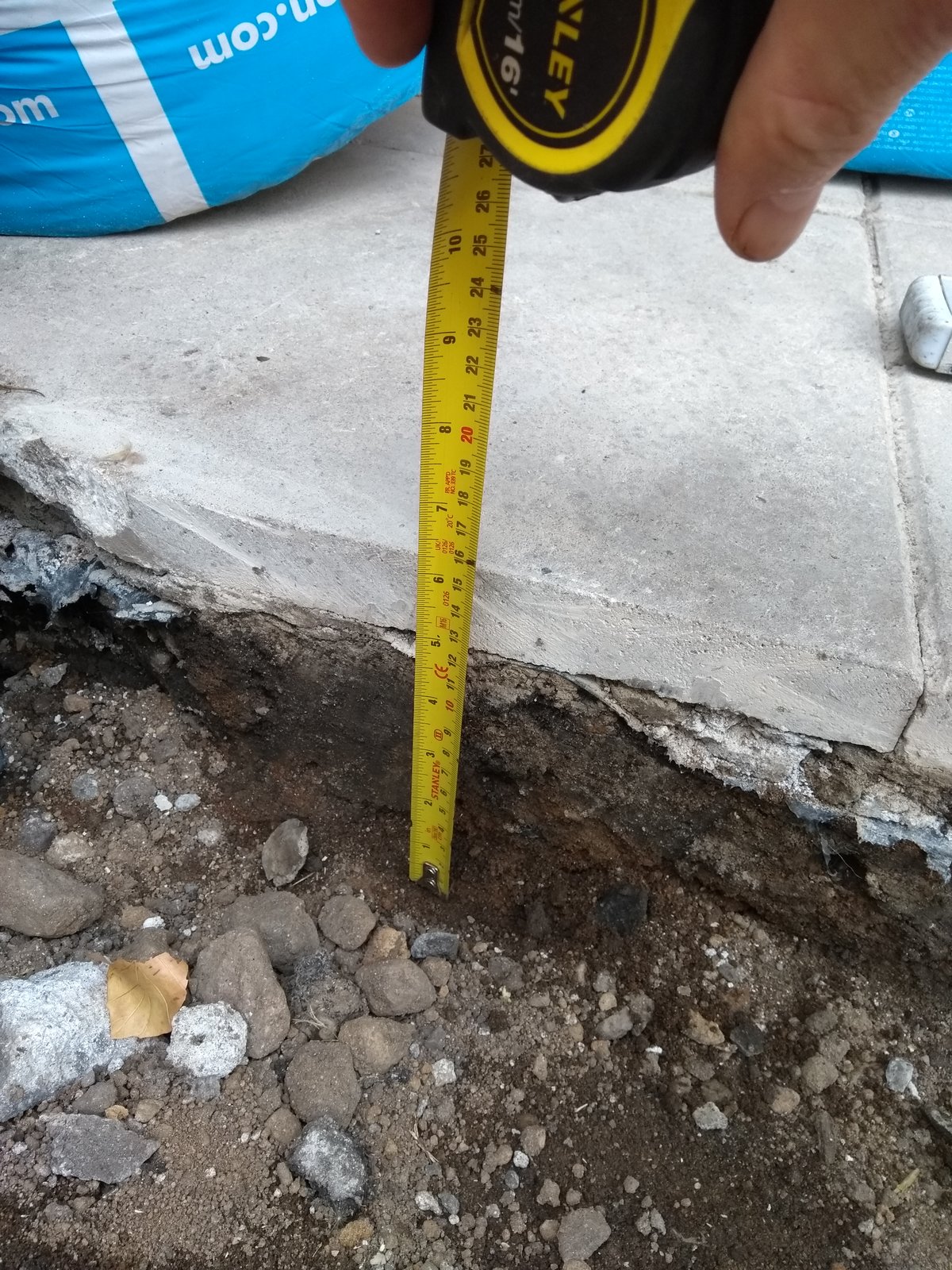

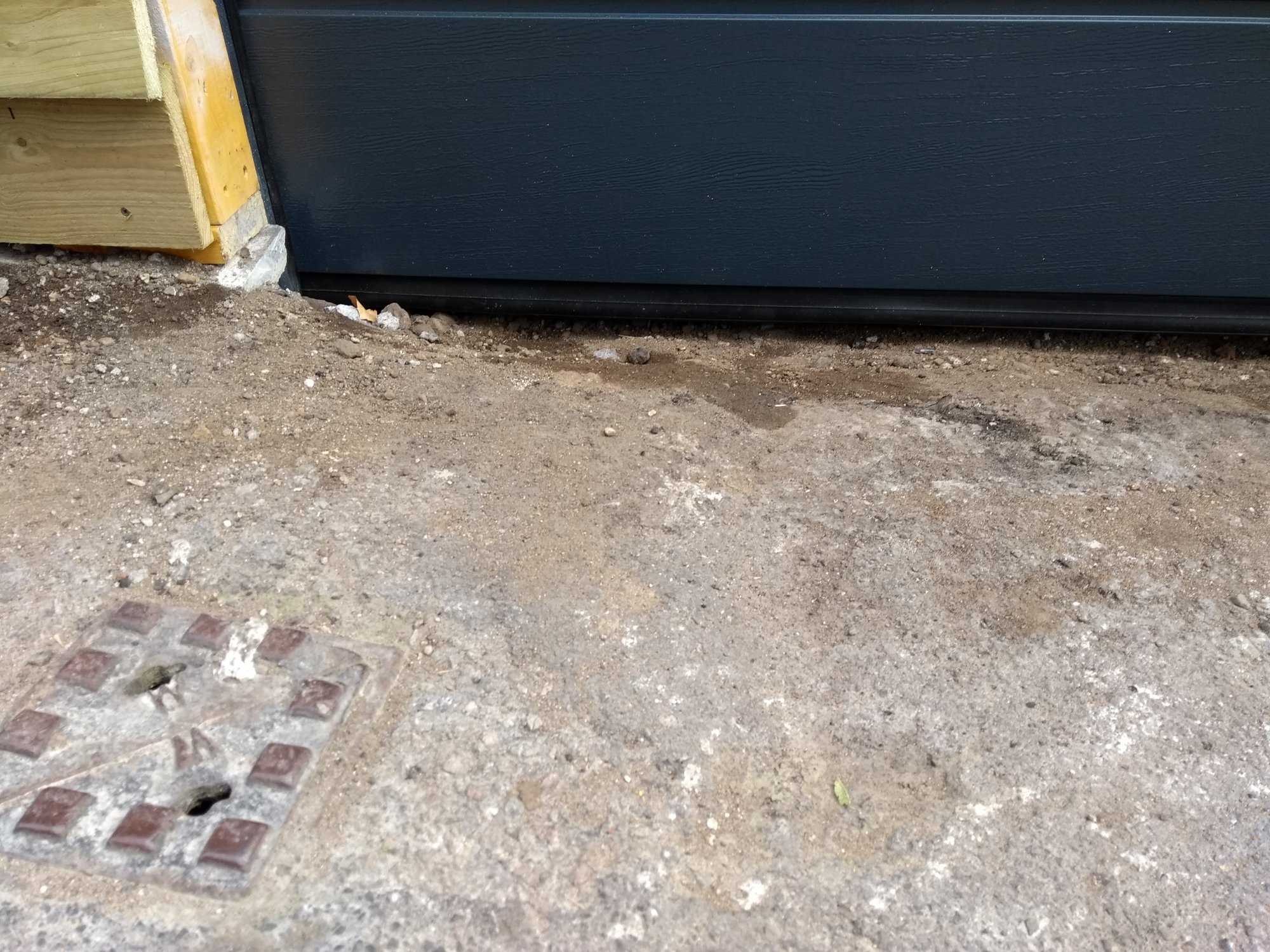

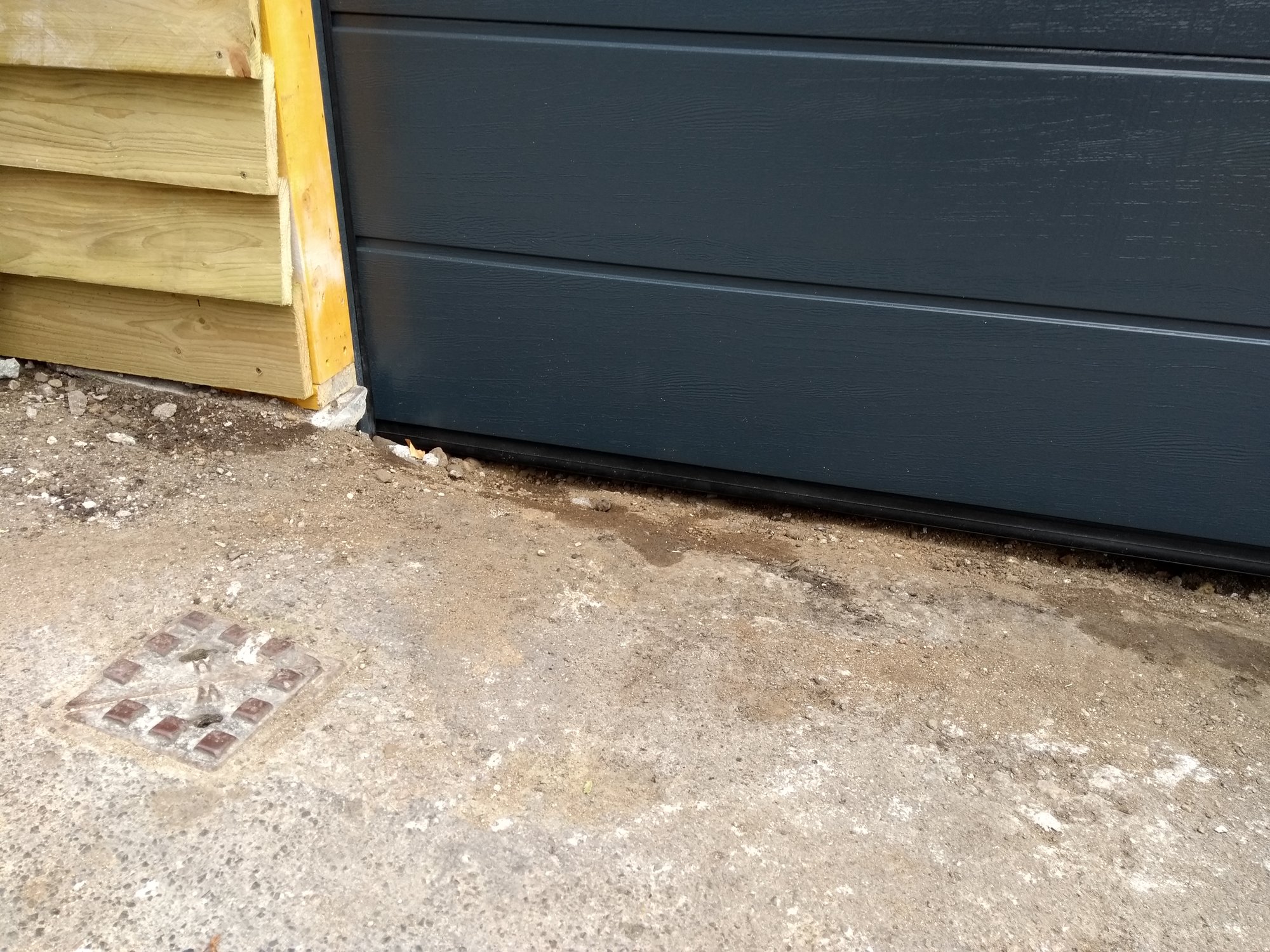

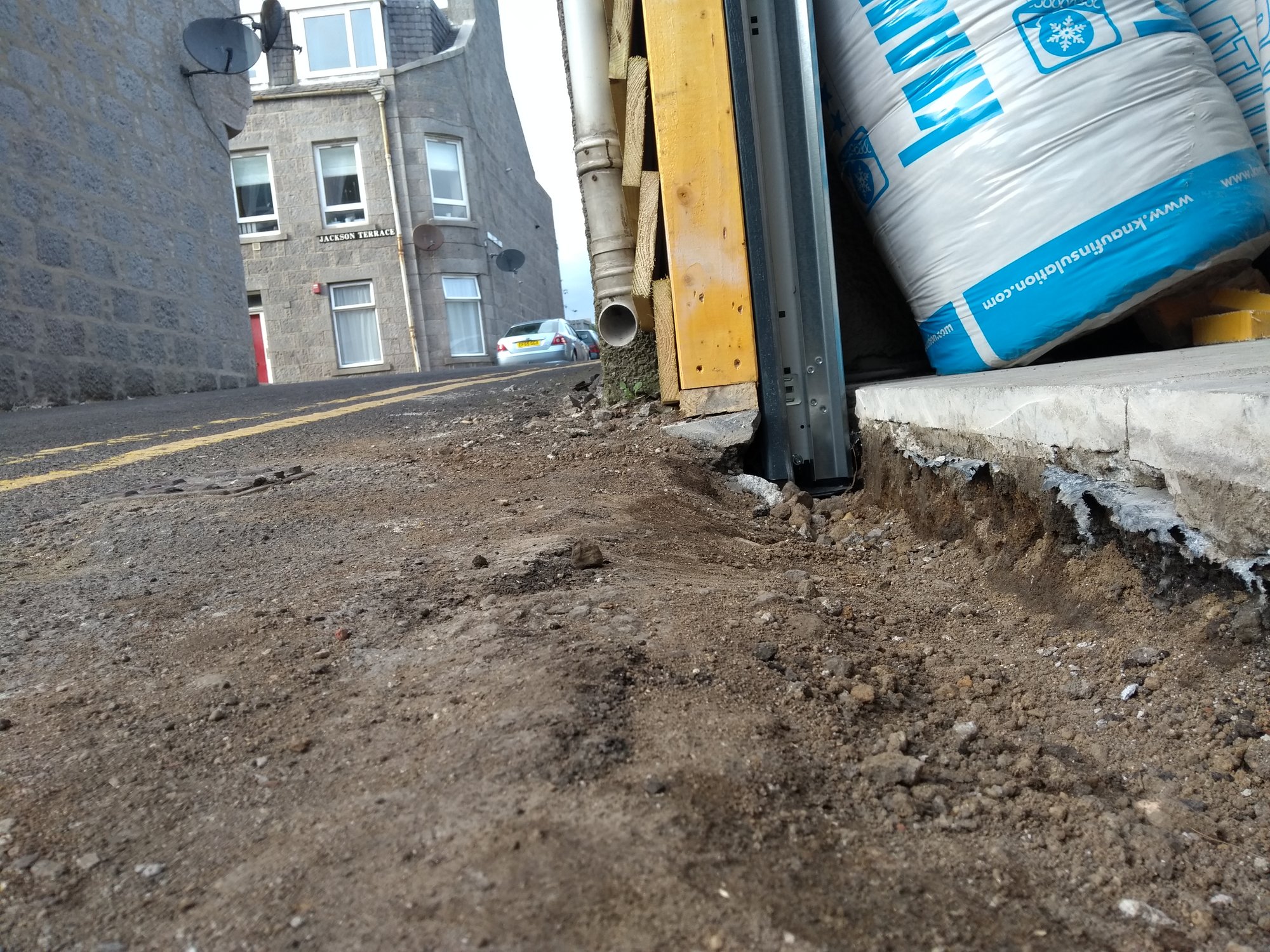

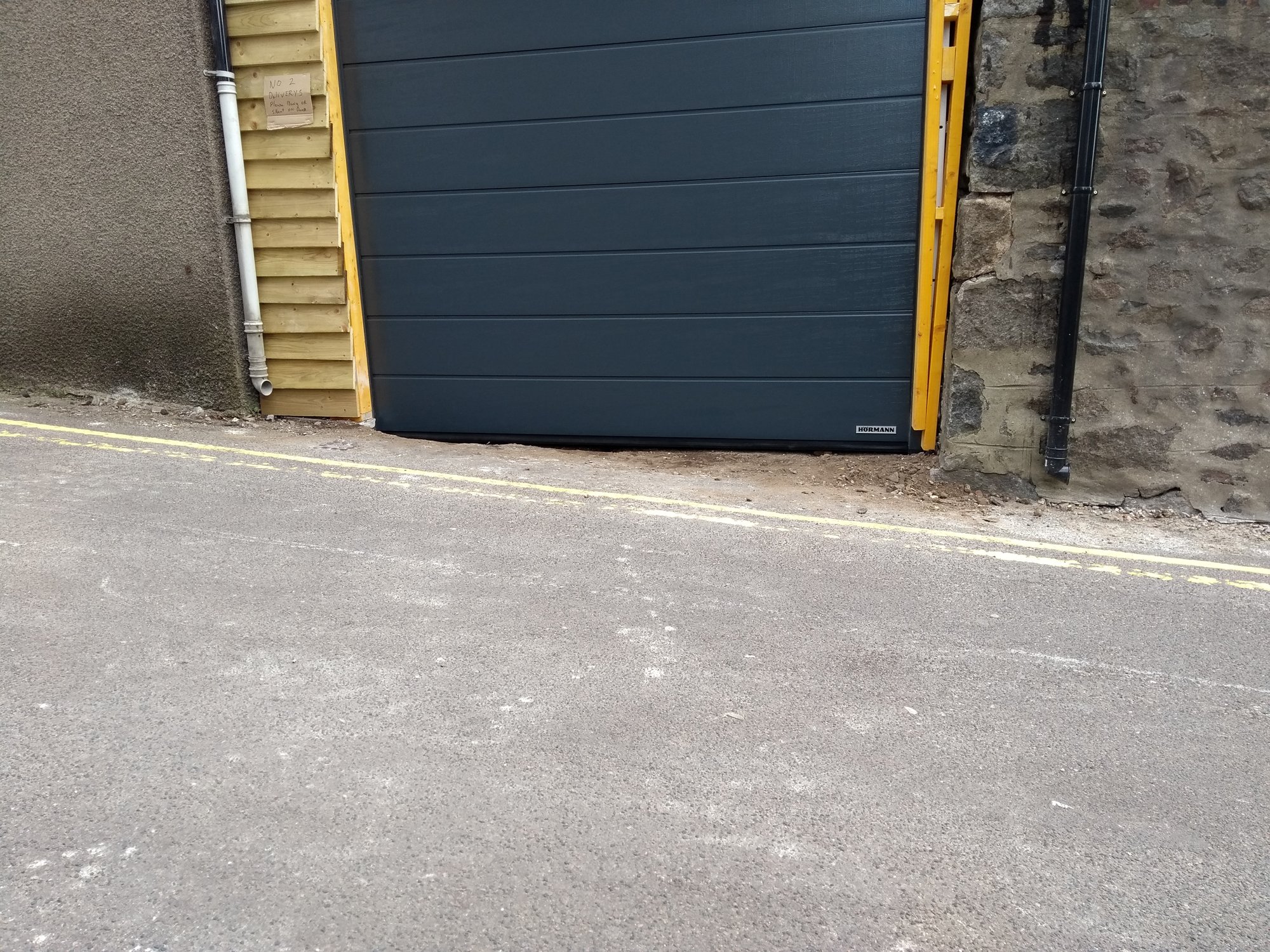

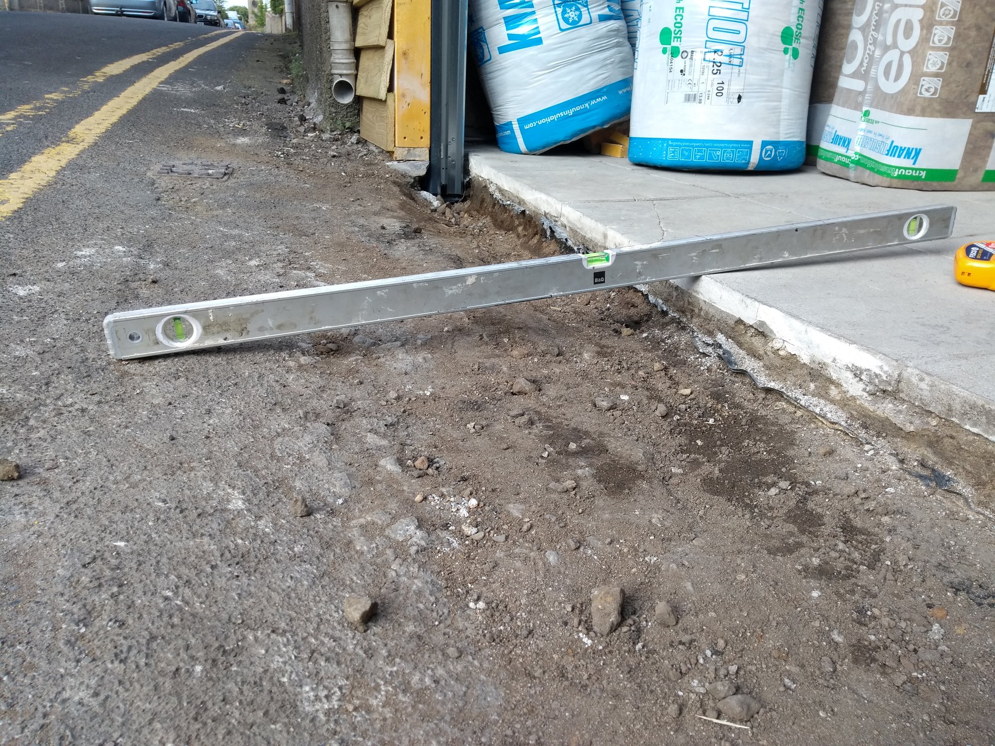

Looking at the pics I would build up a ramp outside the door to about one inch below the inside floor but level.The door will not need cutting and will sit on the ramp and water shouldn't get in the garage.
I agree here, shutter just outside the bottom of the door and pour a good self leveling product. Door should close down on to it. Closing down on a flat surface is part of the security.Looking at the pics I would build up a ramp outside the door to about one inch below the inside floor but level.The door will not need cutting and will sit on the ramp and water shouldn't get in the garage.
