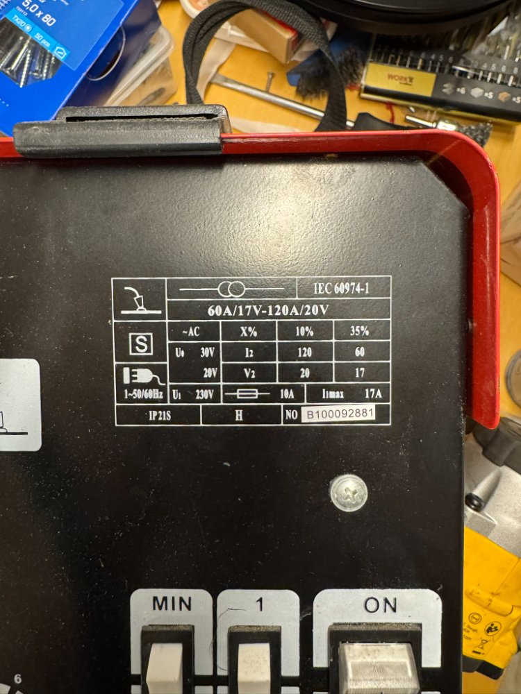

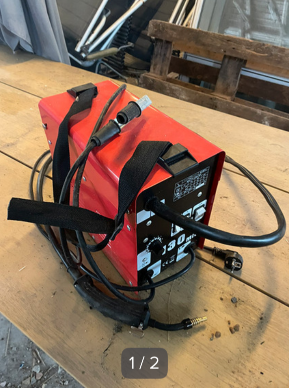

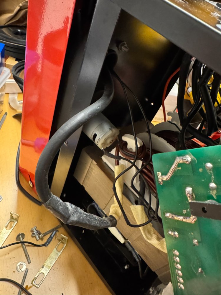

Took a chance and bought a known-defective generic MIG-130 Flux Core welder today for toying around with. Looks a bit like a Rossi (but isn't, no branding other than MIG-130 visible). Relay clicks and the primary coil seems to "humm" when I pull the trigger but the wire doesn't feed.

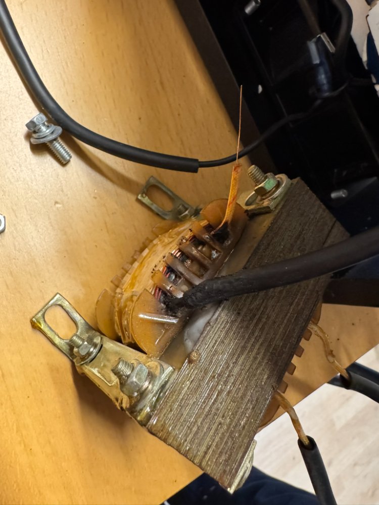

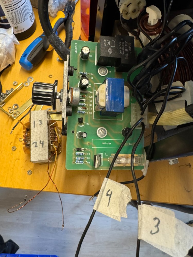

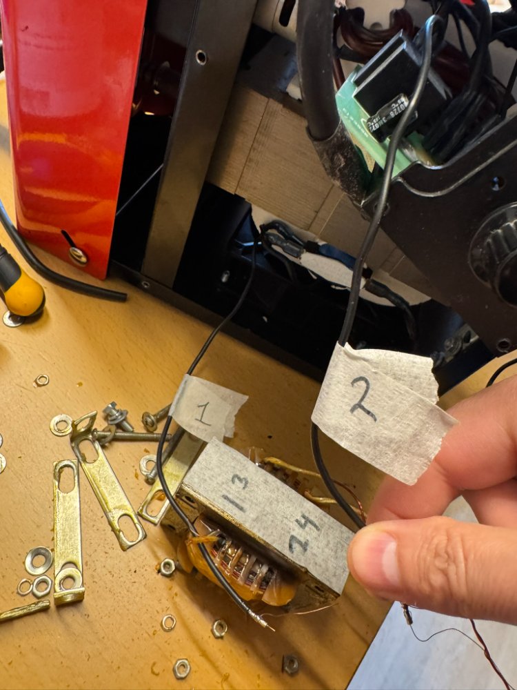

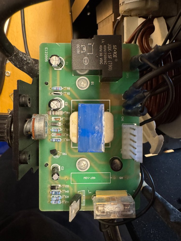

Turns out that the secondary coil has been "a bit" hot. Pulled the coil out to see if I could see any specs on it, but unfortunately not. No visible damage to the PCB which seems to be in good condition. My thought was to buy some cheapo coil to see if it'll bring it back to life. From what I can see on the wiring it's a 230volt primary side, but the secondary side of the coil is unknown. Anyone in here knows if it should be 12v, 24v or maybe something else? And what should the specs (amperage) be?
Attached is a pic of the welder, and pics of the secondary coil and the control PCB, if that's of any help.
