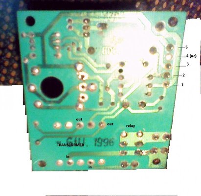

Done some checks no shorts ?? Must only be when getting hot?? Maybe the rectifier???
Need a new pot as well showing 18.1v on wire feed motor
And from negative on the fan to fs1 is showing 230.23v and where I have it connected
Show 0.4ohms across transformer output
And shows 1.8Mohms from earth clamp and tip on the tourch

) I noticed that the corner of the pcb that the spade connections attach to has a copper track that goes over the mounting hole and IF no insulator is used when the board is mounted it could short. Bottom right of pic.
