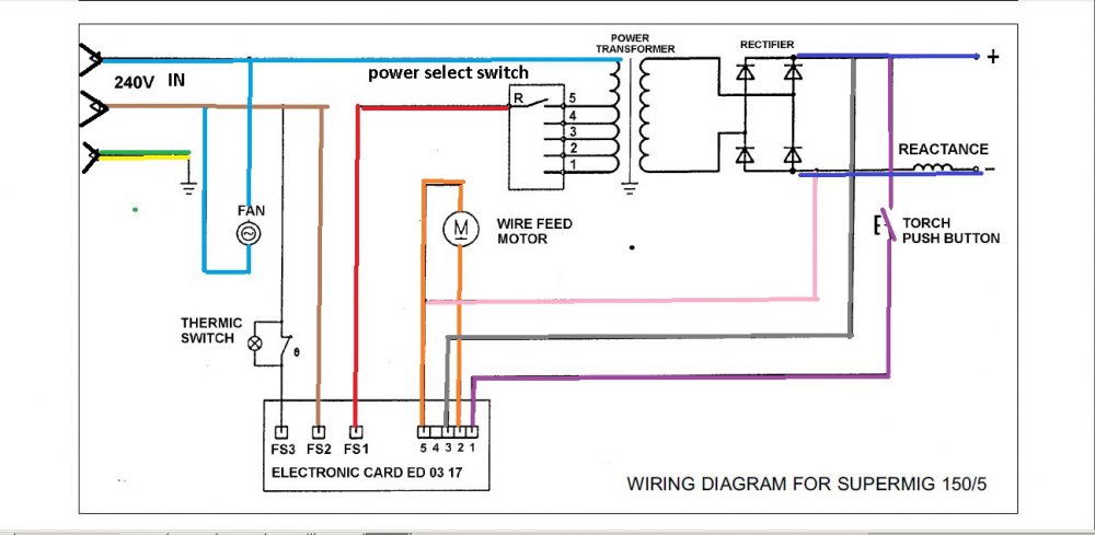

Some pics
Torch
heavy black wire crimped and soldered onto base of connector
Red wire connect to same place as heavy black wire
Red on to existing blue wire
Solenoid
Blue onto power adjuster/switched 230v
Blue onto negative wire
Green/yellow ground
What I done on the conversion is that all good??
Also changed relay on PCB
Now when used for a bought 5 mins the relay clicks and the light flashes then allow to cool and all good also won't work at high power trips the electric which it didn't do before??

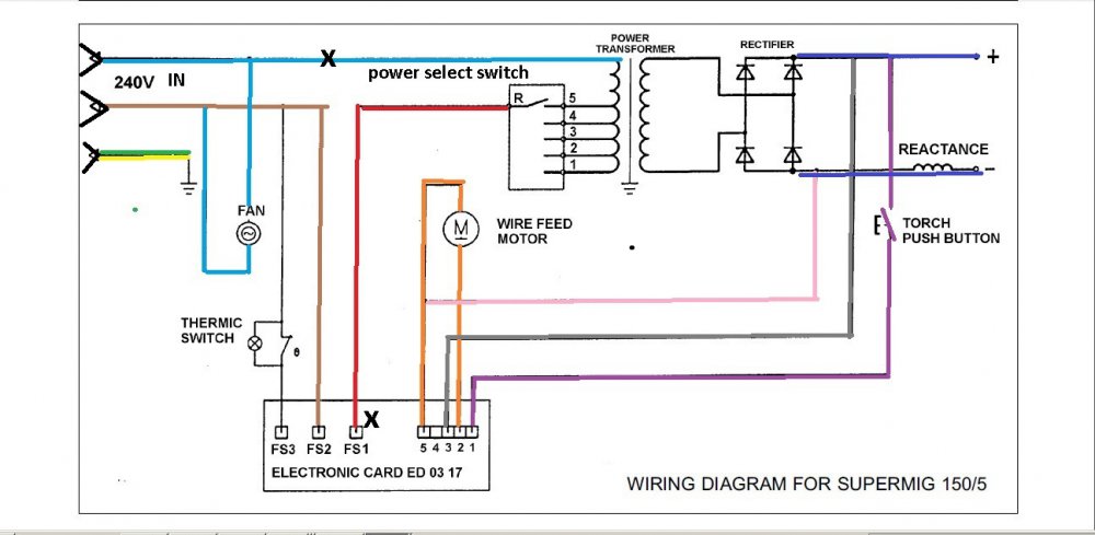

Torch
Solenoid
Green/yellow ground
