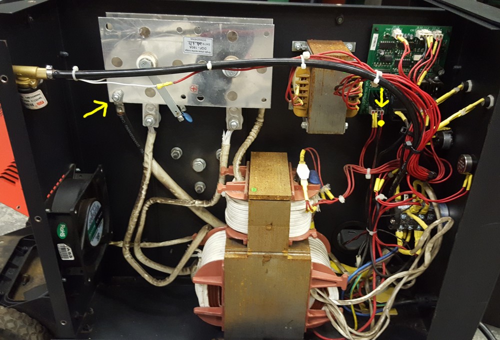

Looking for a little advice, Just picked up a Supermig 230 today, the machine powers up, light on, fan running etc but nothing happens when you press the trigger, no clicks, it does absolutely nothing.
So far I've tried two different torches on it from a friends machine that I know work and still nothing.
Have just removed the 24v wire feed motor to test, so first question is do I have to check it with two batteries wired in series to give 24v or will a 12v one do but just make it run slower?

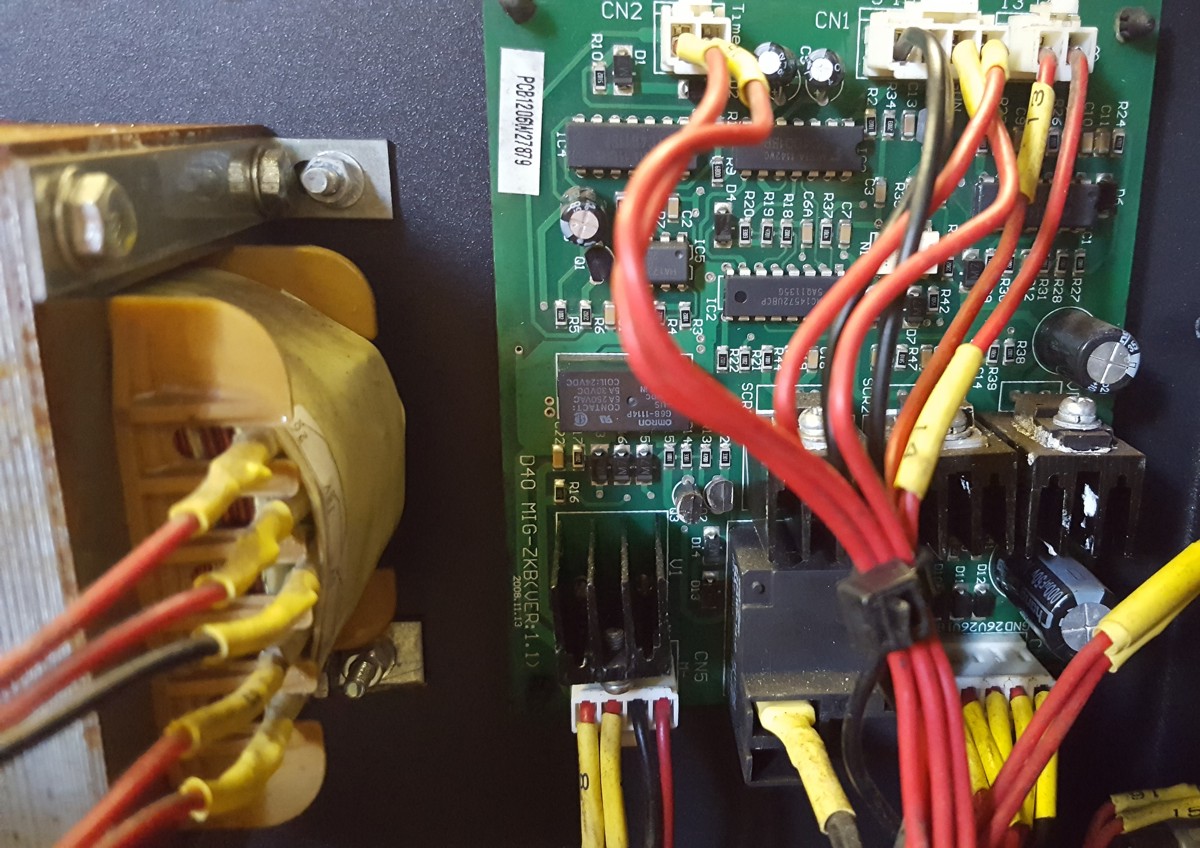

Next question is, as there is no clicking at all when pressing the trigger does this point to something else being wrong? PCB?

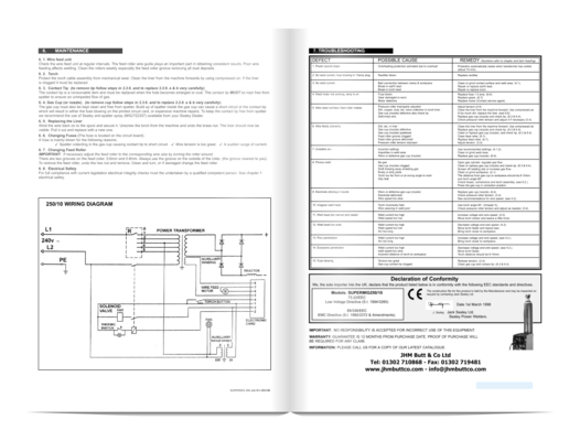

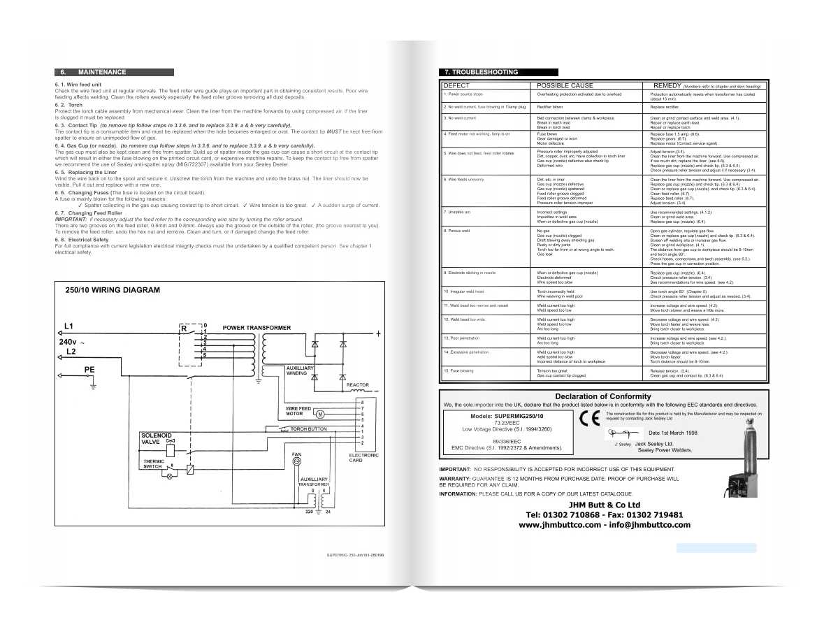

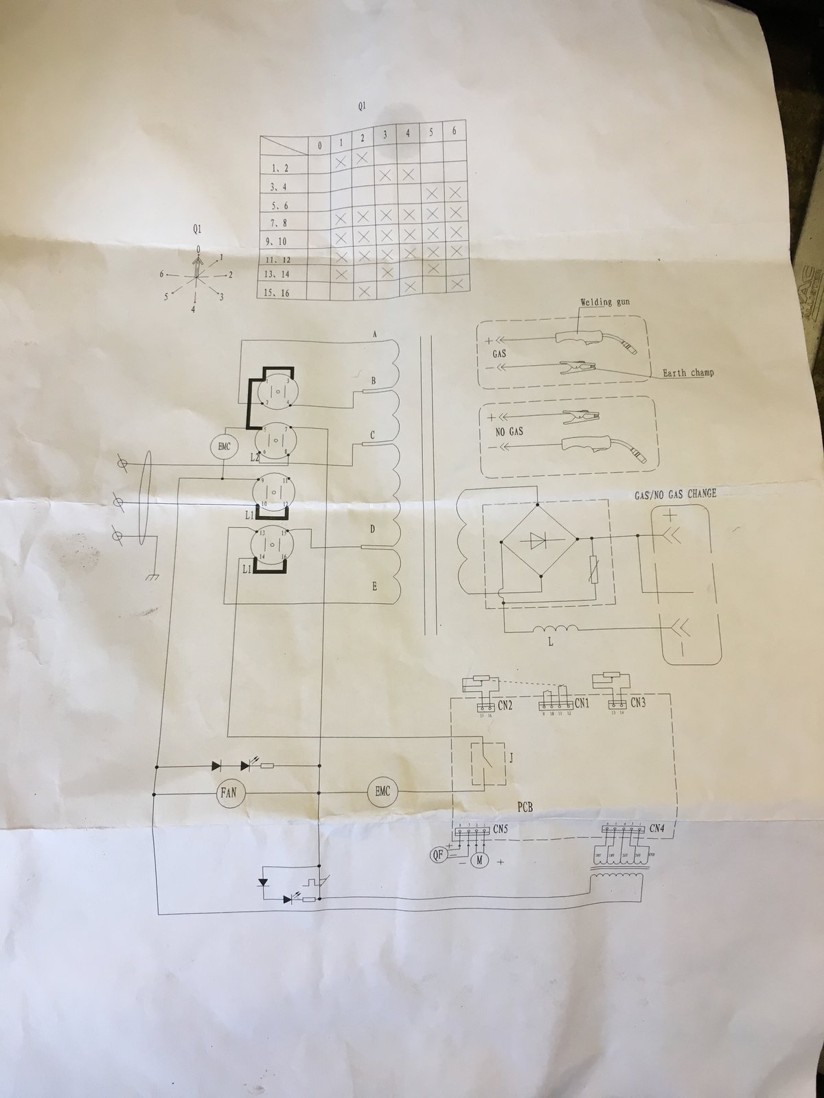

but trying to get a parts diagram for the machine just now so that I can at least identify what is what.
The white 4 wire connector bottom left on the PCB has the red and black wires that go to the wire feed motor
