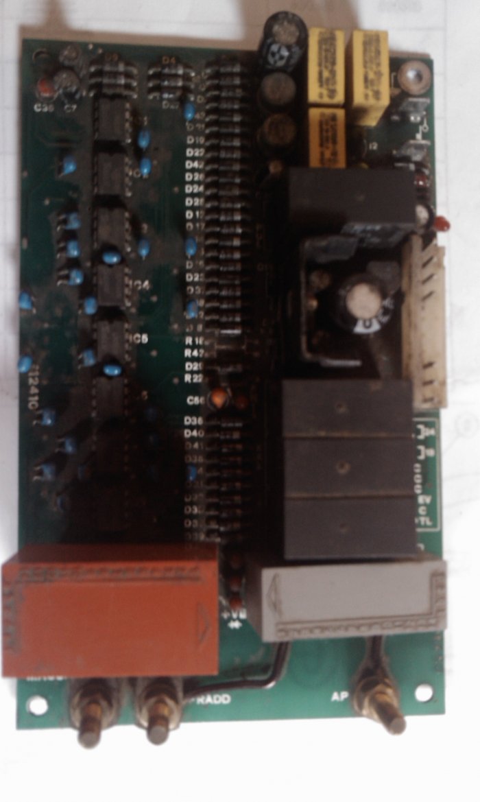

the red and grey things look like relays to me

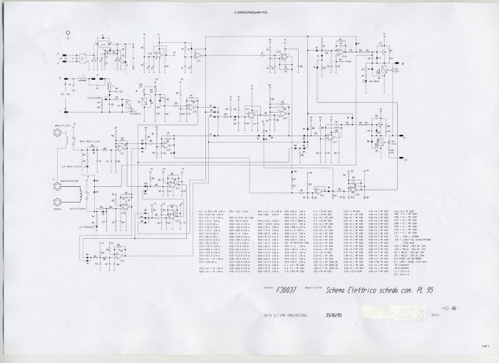

IC9 is an LM317 - this is an adjustable voltage regulator (adjustable as it's output voltage is set by the resistors R1 & R2) it's output appears to be marked as '+19' on the diagram. IC9 therfore controls the power for this board & hence the LED is a power indicator.
So it would appear that the transformer on pins 3 & 4 is most likely OK.
