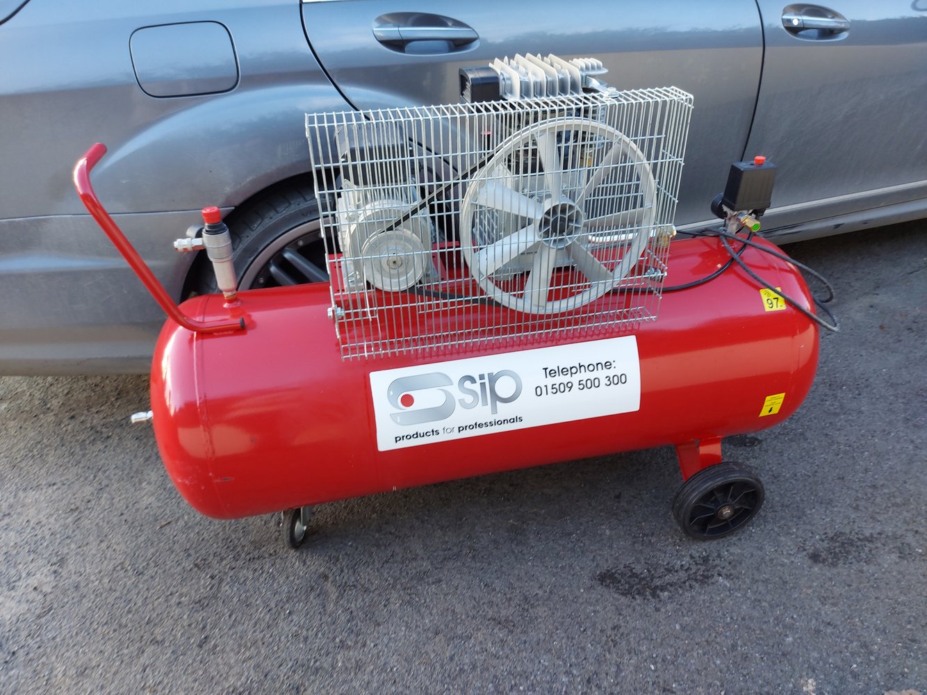

I went ahead and bought a 200L SIP compressor - will collect it Saturday. This should finally give me a half chance at DIY blasting! The 100L one is good but no match for a shot blaster.

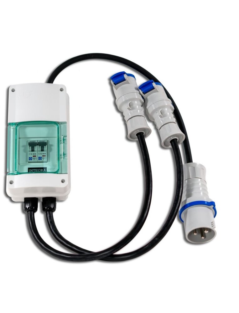

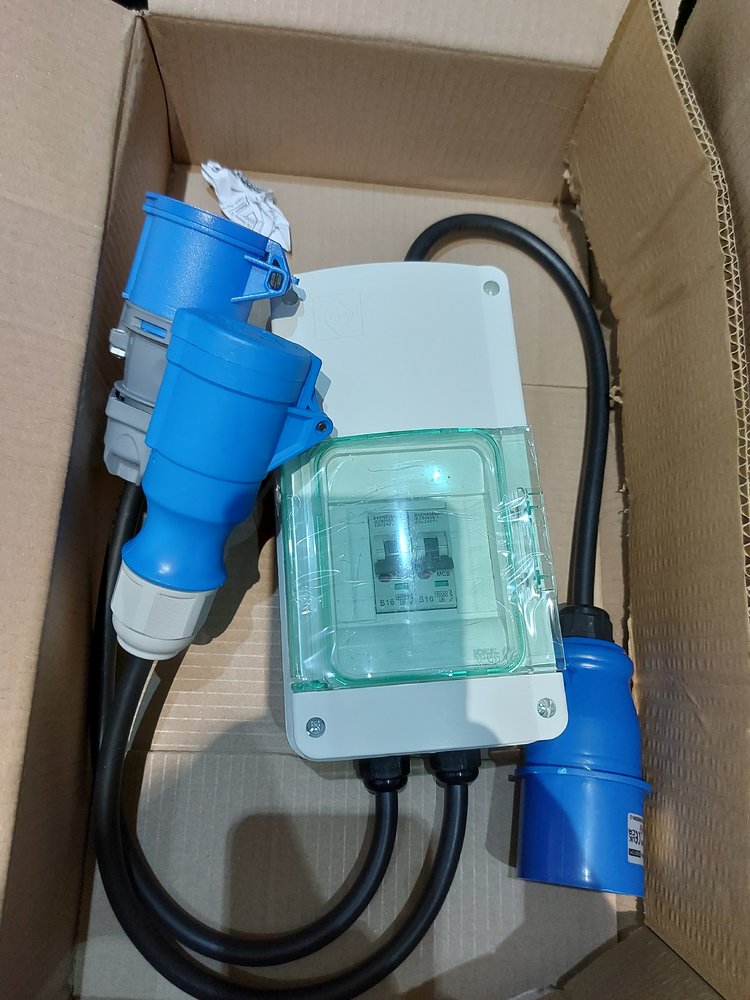

I'll connect both compressors to my 32amp supply with a proper 16 amp splitter fly lead like this
And as mentioned good idea to set the motors so they don't try to start both at once. Probably give the larger belt drive one the largest range. So it's the lead compressor.

trouble is the comps wouldnt be man enough to use one and blast as well. best to use a visor and a respirator if u haven't got air fed
but running 3x at once sounds a little extreme! I have a good respirator and full perpex face sheild so can start with that.

At least keep the 16 amp ones the same!

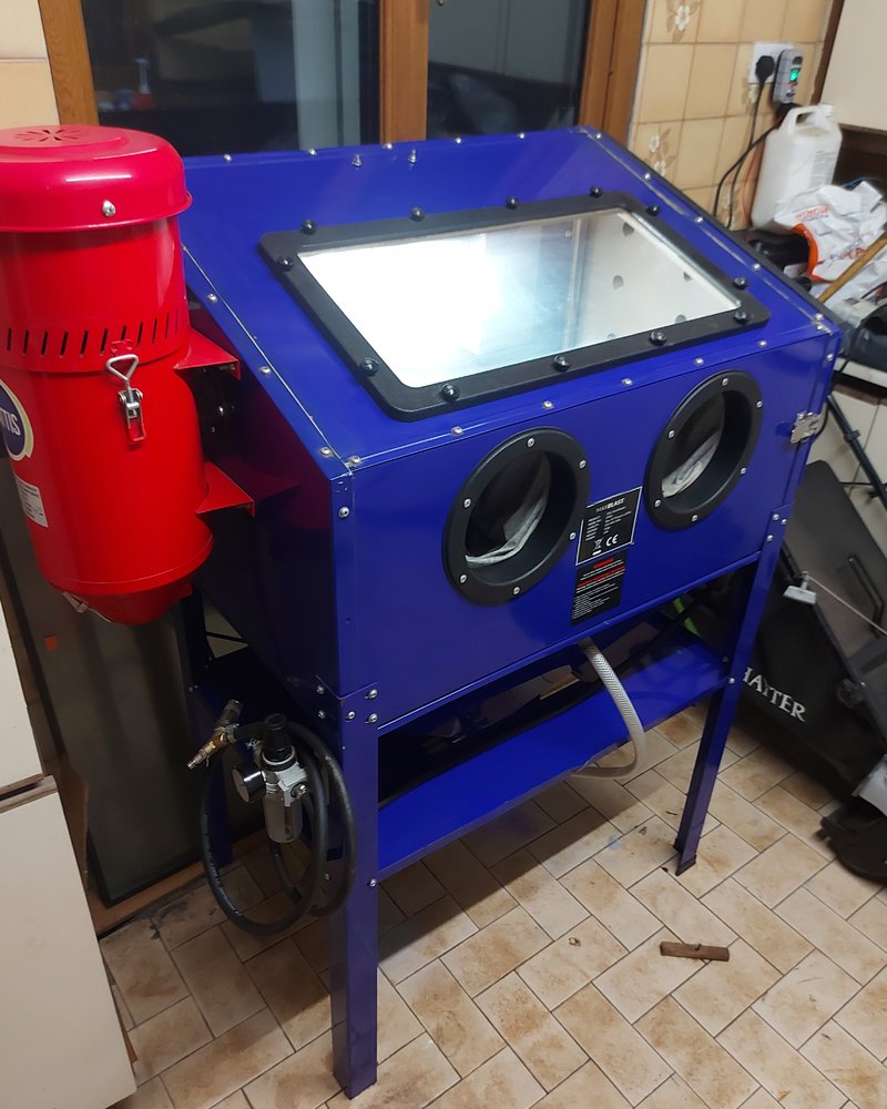

I got a larger blasting cabinet and tandem compressor so that does all my parts blasting. I'll use the blast pot on a car restoration at some point
