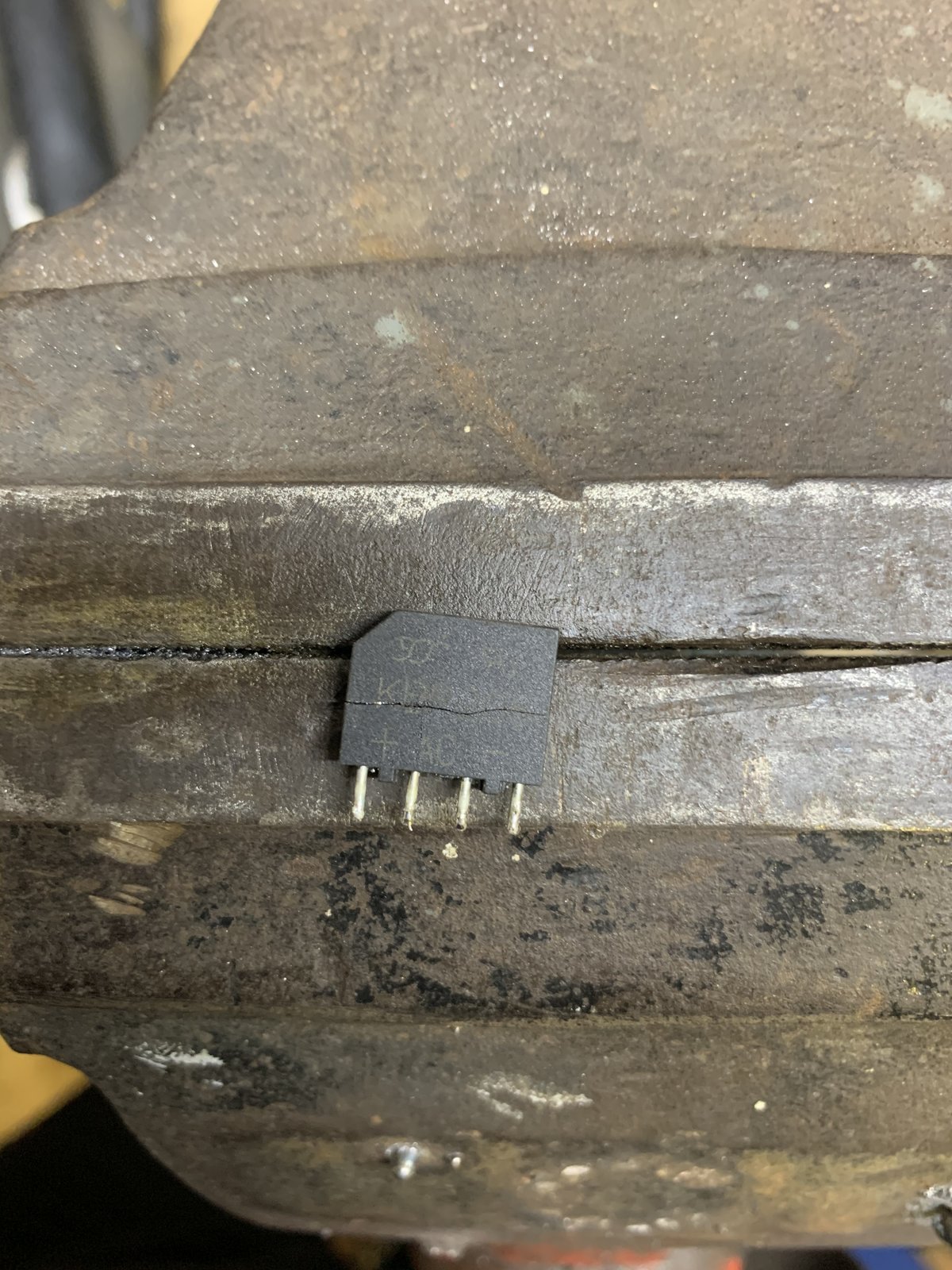

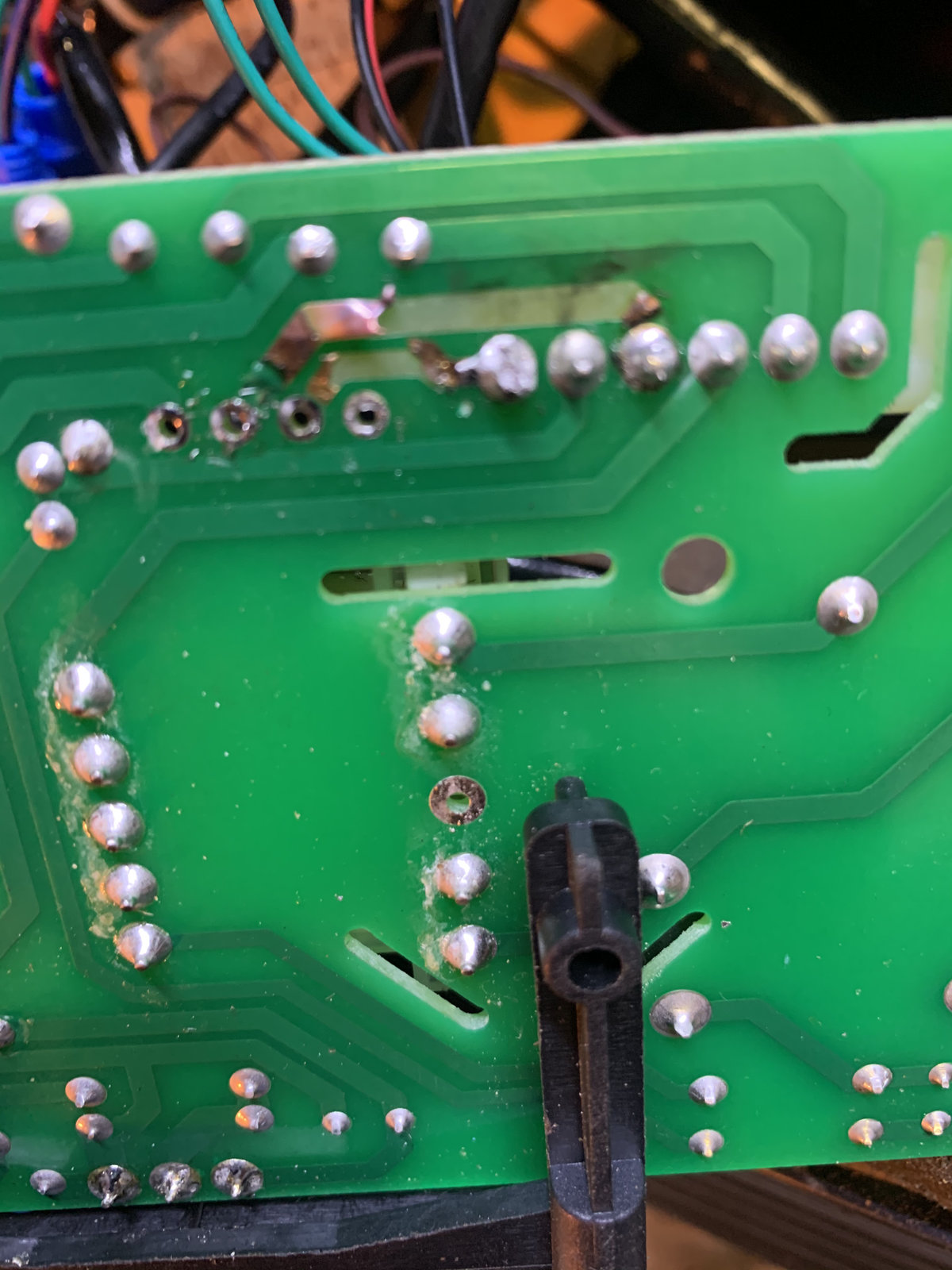

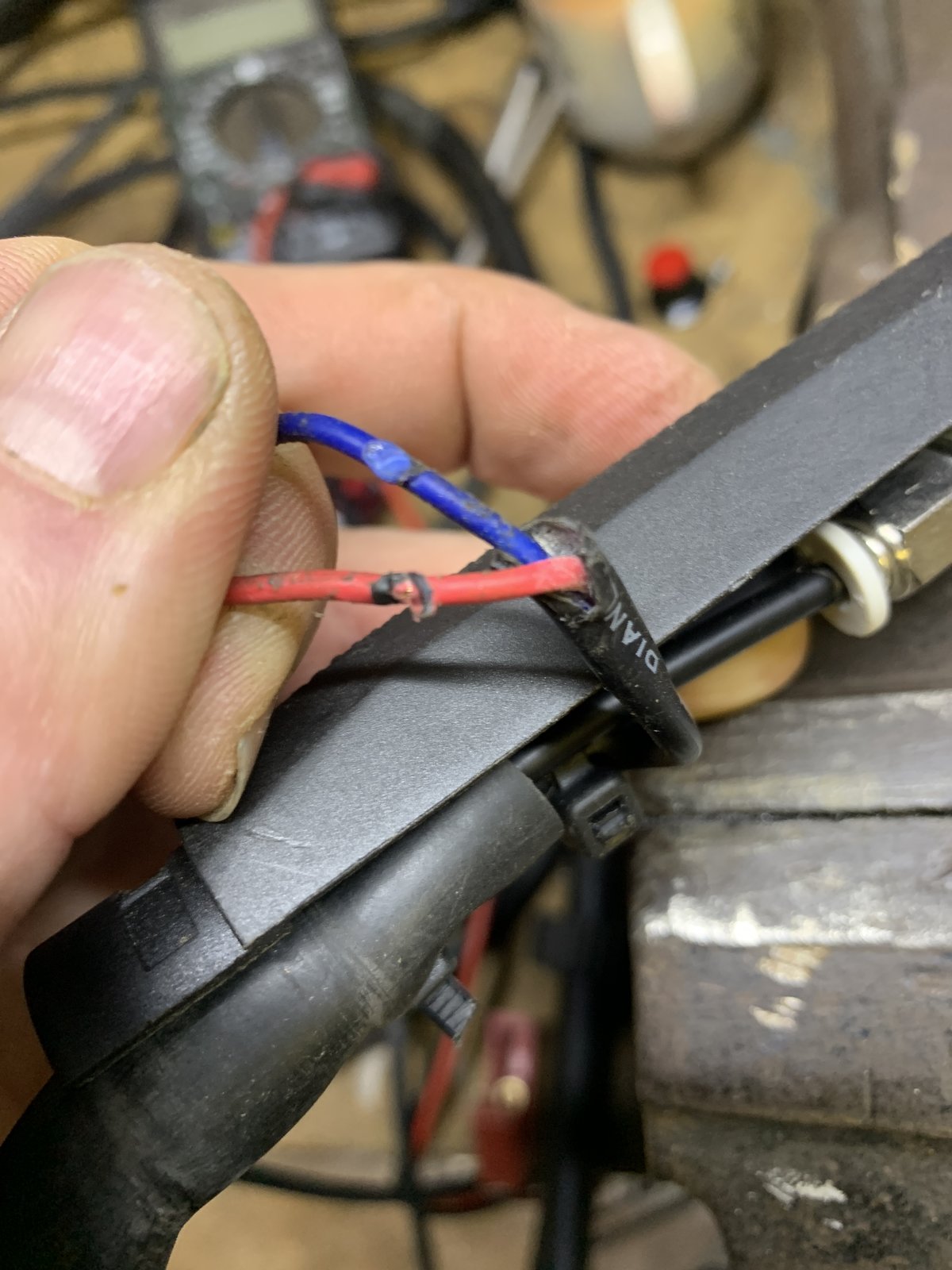

    C52300B1-A183-43AB-B98C-8B9F7CFDE8A5.jpeg Hmmmm - seems odd I got one here that seems to have done the same thing :whistle: seems that the trigger wires have rubbed through and touched the torch and took the rectifier and tracks with it . 0DF18A56-F695-4DCF-ABD6-657D16F55843.jpeg

  7. a111r Member
    Messages:
    890
    Location:
    London
    You might have solved the OP's problem here!
    I'm guessing that the plastic encapsulated rectifier works with the board-mounted transformer and is rated at something like 4 Amps?
    Shorting the torch wires gave it the welding voltage (AC) and these high amps blew it, and the tracks.
    A cheap fix, though.

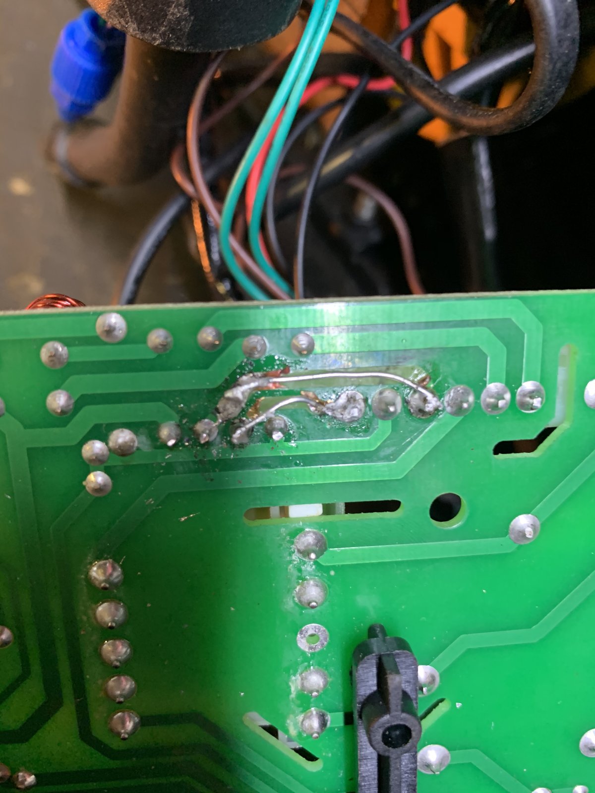

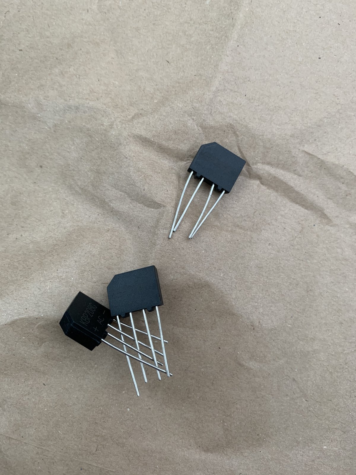

    Hopefully bud fingers crossed , just have to wait for it to come and try it , doubled heat shrink switch wires and unravelled them so they sat better - I did bridge them and it went pop - pcb transformer seems ok voltage wise , and everything is working when trigger is pressed ( relay etc etc ) it’s only
    Thing I can think off
