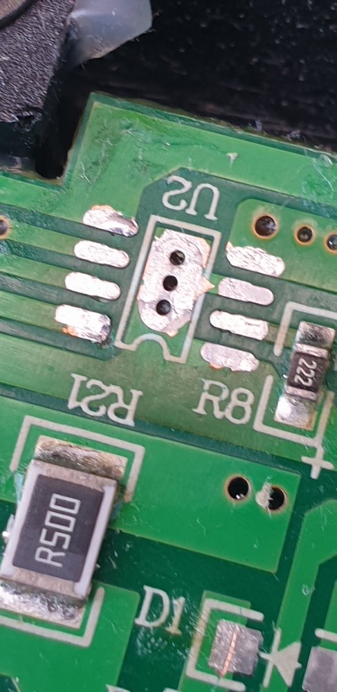

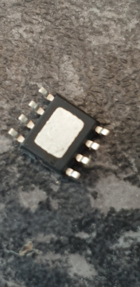

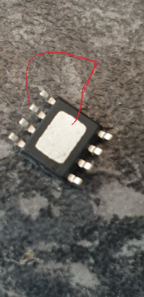

As I mentioned in #15, the blown-up chip and/or other faulty components on the board may pull down the voltage across the battery, prevent it charging, and short the output of the new USB charging boards. You could do a quick test with your 5v 1A supply at connector 2. An Ammeter is series should show a current draw of about 500 mA or less. A voltmeter across the power supply should show the voltage dropping to maybe 3.5 or 4 volts, but not zero.
please see above pics
