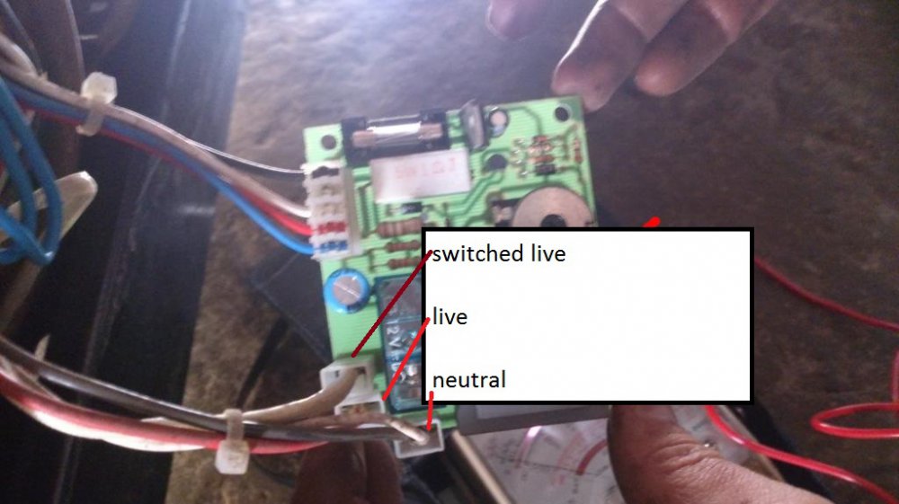

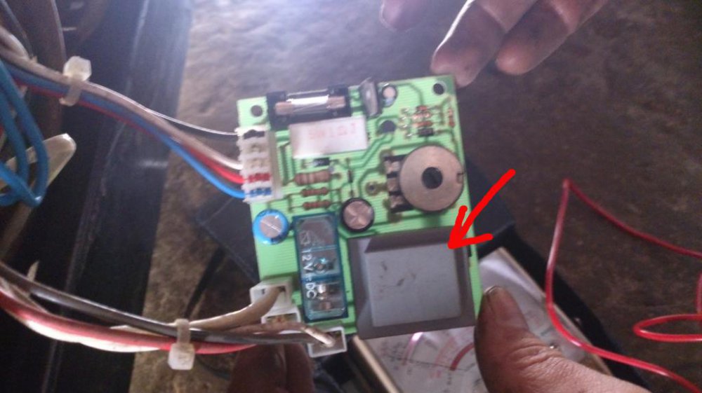

it is an R and shows the gas solenoid connected to it, which I suspect is the heat resistant insulated wire shown from the pcbThe one marked B (That R may be a B on the diagram?) All the other wires have heat-resistant insulation on them and go to the transformer.

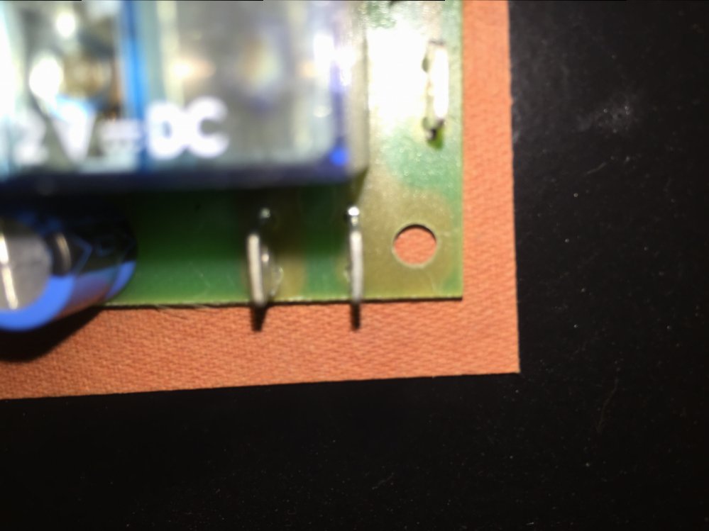

This is the circuit board with those connects removed no labels?look on the circuit board fs1
The one on my welder marked B (on the power switch) has the neutral wire from the 3 pin plug and my blue wire from the solenoid connected to it.!The one marked B (That R may be a B on the diagram?) All the other wires have heat-resistant insulation on them and go to the transformer.
I wonder if the switch is in the neutral side of the transformer, so we should be looking to connect the other side of the valve to a live rather than a neutral?
try connecting to the ones on the board marked switched live and connect the other solenoid wire to the other marked neutral in the pic above it should work

Seems the issue was i had the neutral connected to the 3 pin plug neutral...
