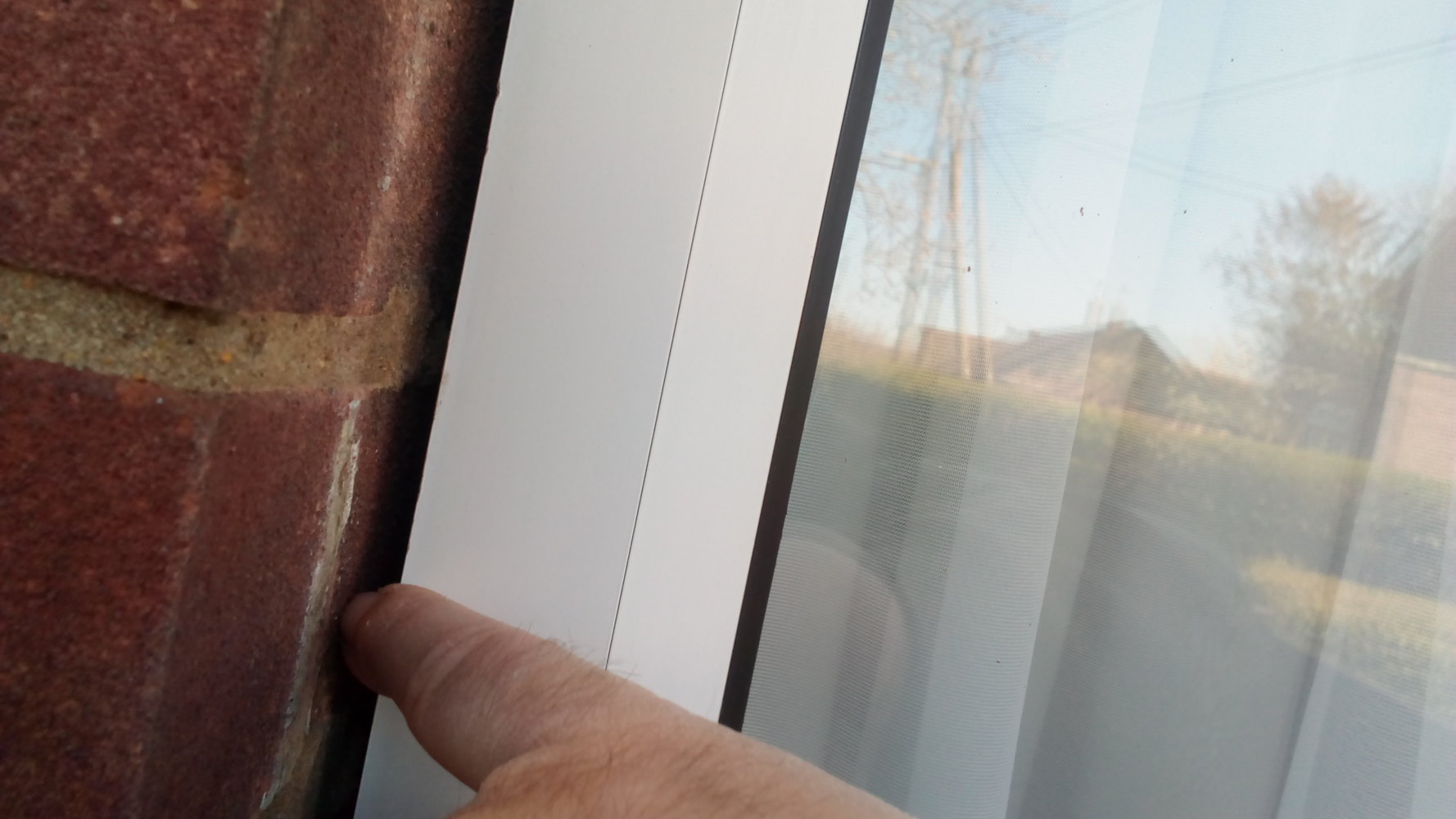

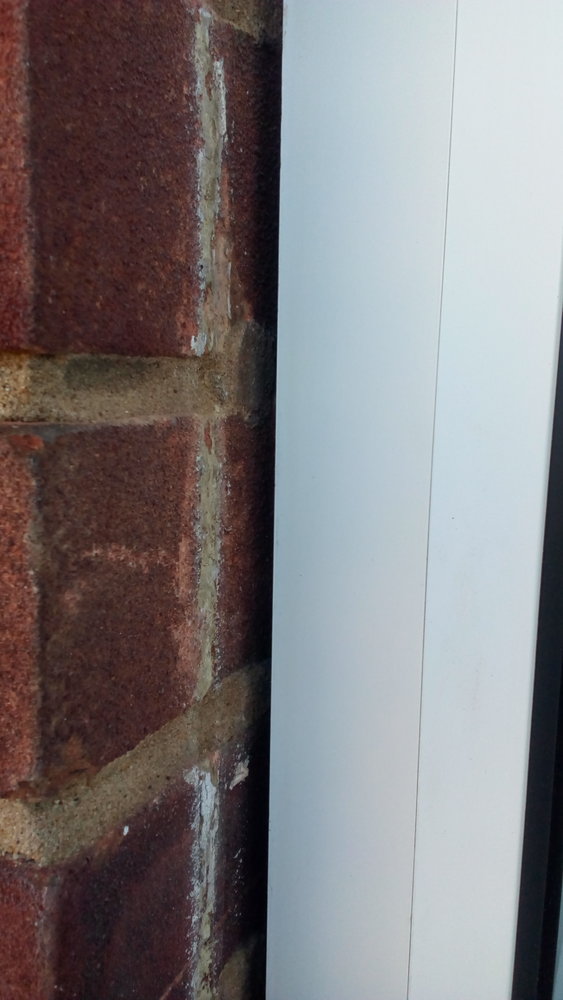

steveo3002 Member Messages 7,690 Apr 22, 2021 #5 One of them has a huge gap now I've pulled the sealer out...would I be best gluing on a trim?
angellonewolf Member Messages 8,772 Location bristol england Apr 22, 2021 #6 you can buy d bead from plastic places add a roll of double sided tape stick on you realy should use non expanding foam or at least foam pipeing behind to help stop drafts
