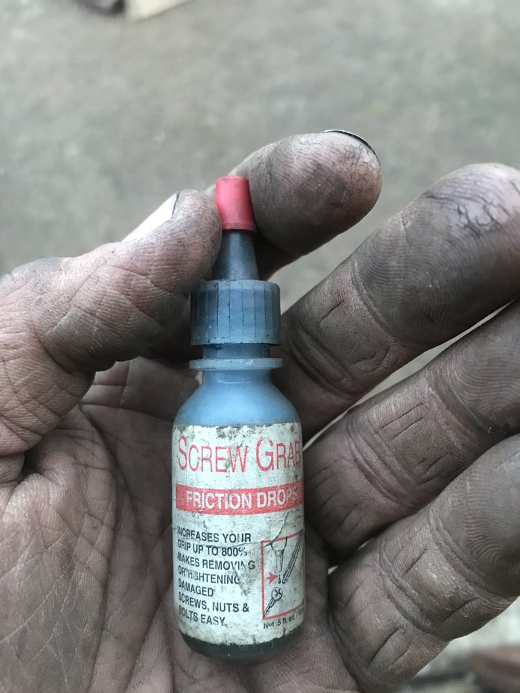

As above. Screw grab does me.
Ha, this was the last job I ended up having to use my screw extractors for, if this magical paste had saved me messing about so long and re-tapping I wish I knew about it soonerIf camming out is an issue then you do need it. Used it earlier in fact on the two small JIS heads some idiot decided would be useful to hold the wheel bearing lock plate on my Navara in with.
much more elegant solution than a staked tab washer but not road salt friendly!

I think that’s like Chinese percents but it’s good stuff.800% more torque!!!!?? really?
sometimes you gotta go old school and use an actual screwdriver. This is where that stuff wins hands down.i just use diamond tipped wera bits in a dewalt small impact gun it can remove rusty 2 inch screws out no probs

or a pozi bit on a jis heador your mates using your best pozi on phillips heads![]()
What's a jis head?or a pozi bit on a jis head
It may have been a pozi bit and screw grab that got me out the sh1t earlieror a pozi bit on a jis head
Japanese Industry Standard. Looks like a Phillips but different profile. They usually have a small dot by the crossWhat's a jis head?
Used extensively on Japanese motor bikes and doubtlessly elsewhere.Japanese Industry Standard. Looks like a Phillips but different profile. They usually have a small dot by the cross
