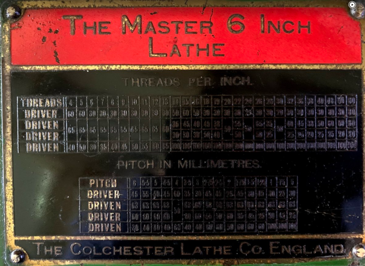

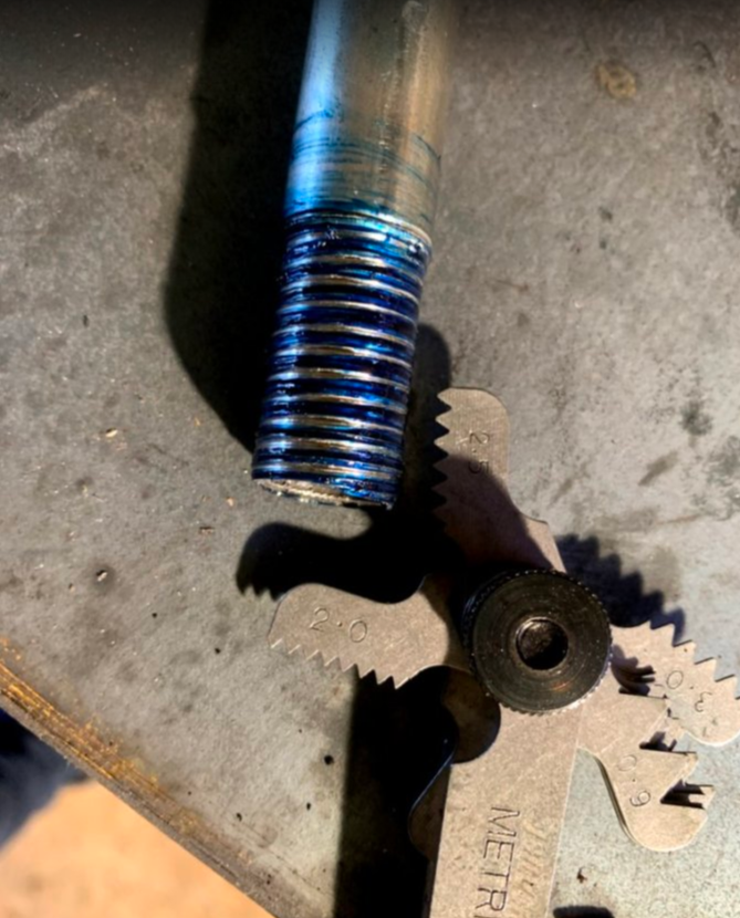

Today's problem (which was actually Sunday's problem, too!) is that the gearing / pitch seems way off. I'm going by the gear combos stamped onto the gear housing, and they are either out by around 40% or I am, once again, doing it wrong.
That thread above is supposed to be 4.0mm but seems to be closer to 2.5mm. When I was playing on Sunday I had it geared for an alleged 1.5mm but it was much finer than that.

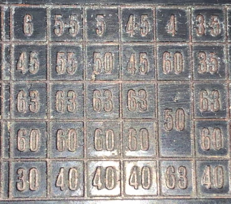

This is the appropriate part from the table on the cover:
I put the 60 tooth on the main drive out of the gearbox, 50 on the banjo, and 63 on the leadscrew - that's correct, huh?

Your machine plate suggests it has a 6tpi screw. If it does, then a 60 on the stud gear and a 63 on the screw gear should yield 4mm pitch (or near as dammit). If it has for instance a 8tpi screw you'll need to re-figure the gears.

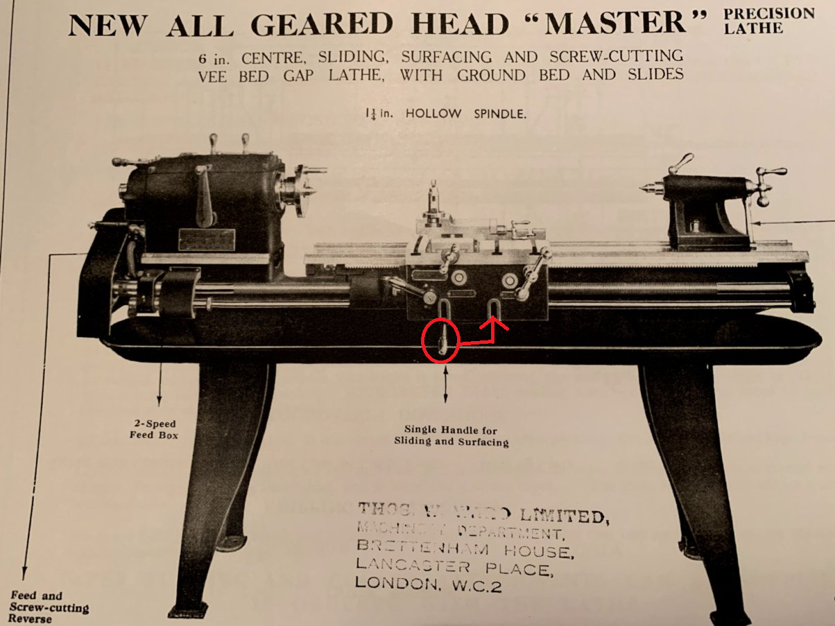

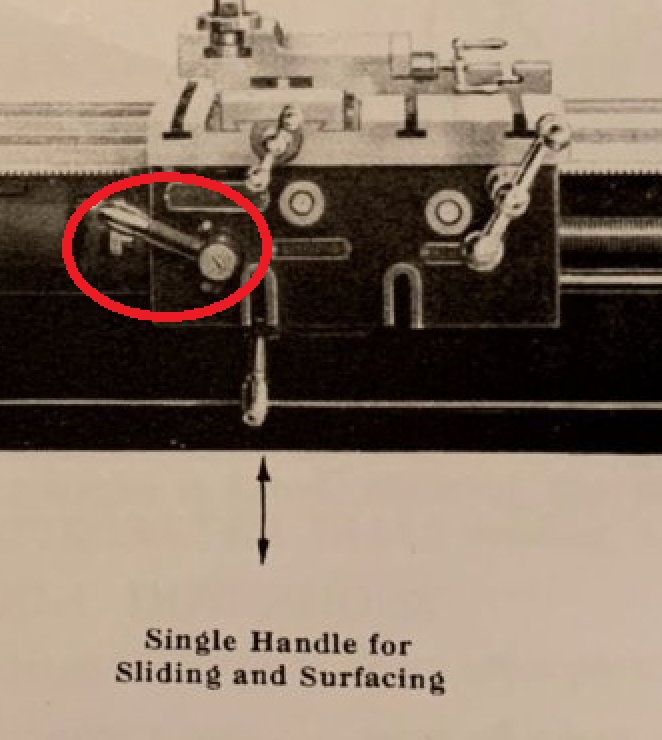

Same problem as another poster a few days ago. That's for surfacing and facing, not thread cutting.
It would certainly explain the too-fine 'thread' and the tool crash.
Scotl - the drop-out lever is for turning only. It basically engages a power feed to the handwheel to drive the carriage along by the rack and pinion. You have to leave it disengaged and use the other lever (the half-nut lever) to engage the half nuts on the leadscrew for cutting threads. The leadscrew is more accurate and repeatable for making multiple passes for cutting threads.
Since you're cutting a metric thread, you have to stop the motor and back it up to wind the tool back to the start without releasing the half-nuts.
Oh look... a single handle for sliding and surfacing. What a plank...
So my guess, being 25ft away from the garage, is that the circled chappie is the half nut engaginator...
The thread-dial-indicator is just to the left of it, so that makes sense.
- Don't do what I did when I started out and reverse the motor without retracting the tool thinking it would follow the cut back to the start - it won't, it just trashes the work by chewing up all the bits you don't want cut. Always retract the tool.
