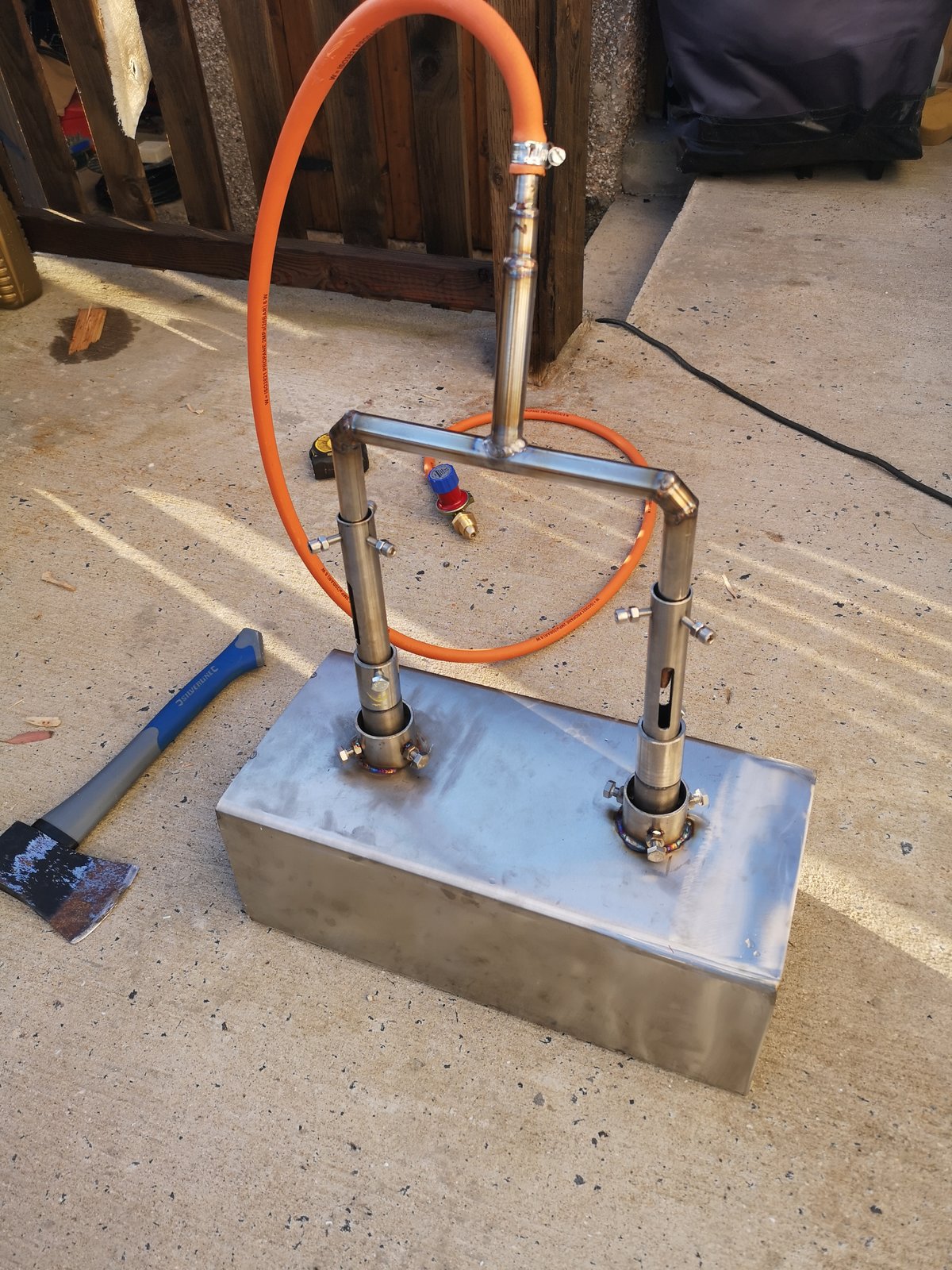

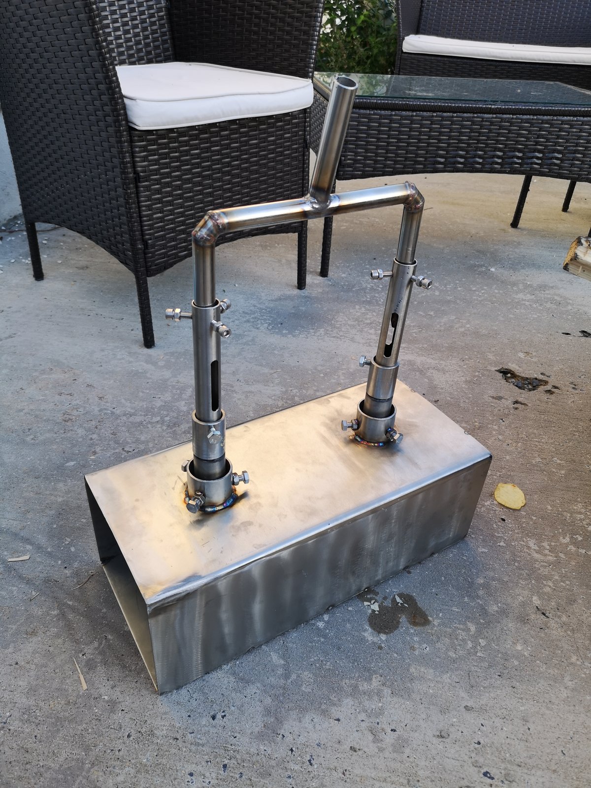

Hi guys over the last few weeks I managed to collect some scrap in the bins at work to start making a propane forge, I've only had to buy the regulator and some hose, rockwool, fire cement and bricks. The welding isn't the best as I was using a naff set in work which was oxidising the welds for no apparent reason, until I found a big split in the gas hose
from the apprentice dropping a bottle over the welding set. Manged to take it home and do some welding at home then.
Anyhow here it is, I didn't do much research so I'm sure there are some design flaws haha.
0.8mm tips as injectors, even on thr lowest pressure it's like a beast, although when I've lined the forge I will have to dial it in
Cheers guys
