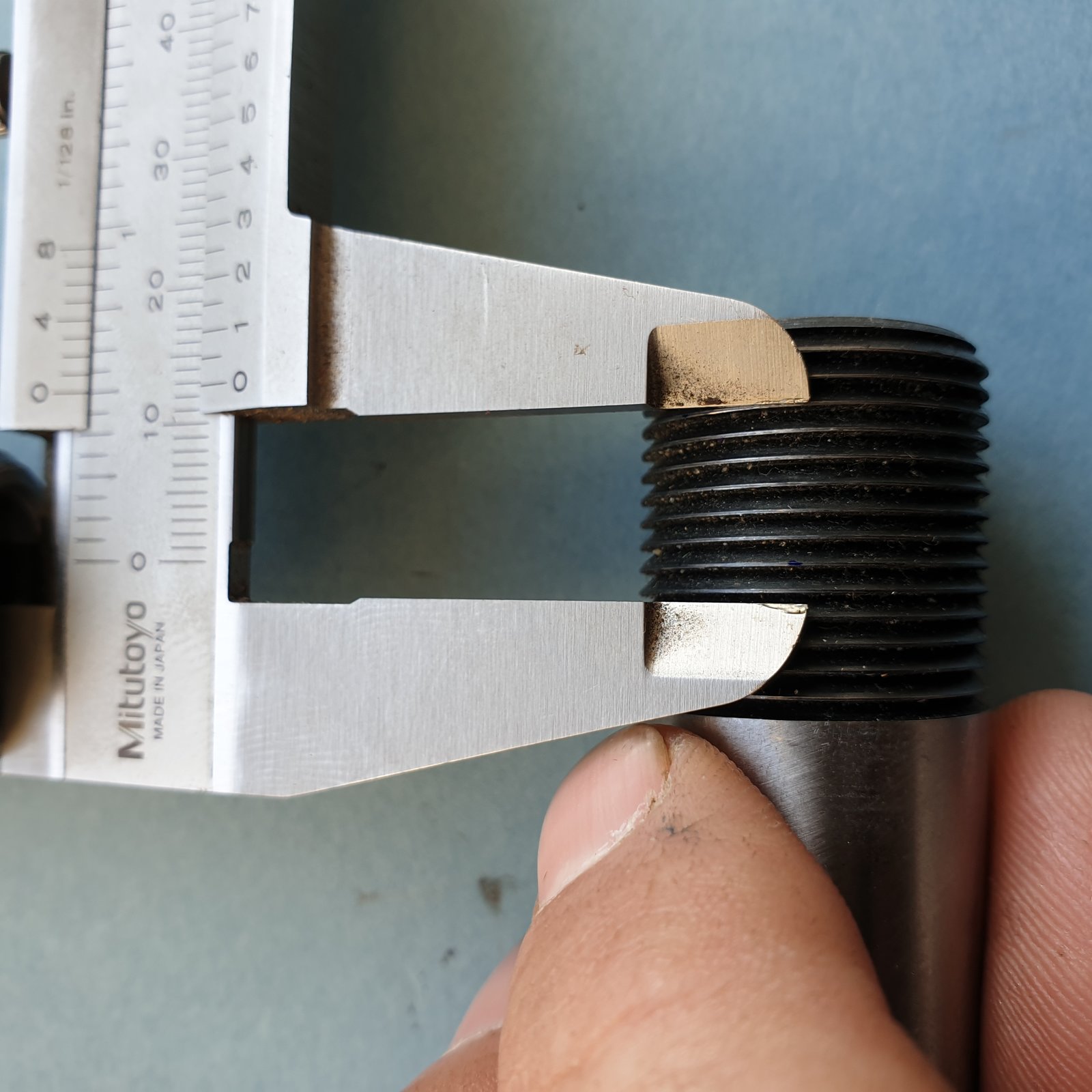

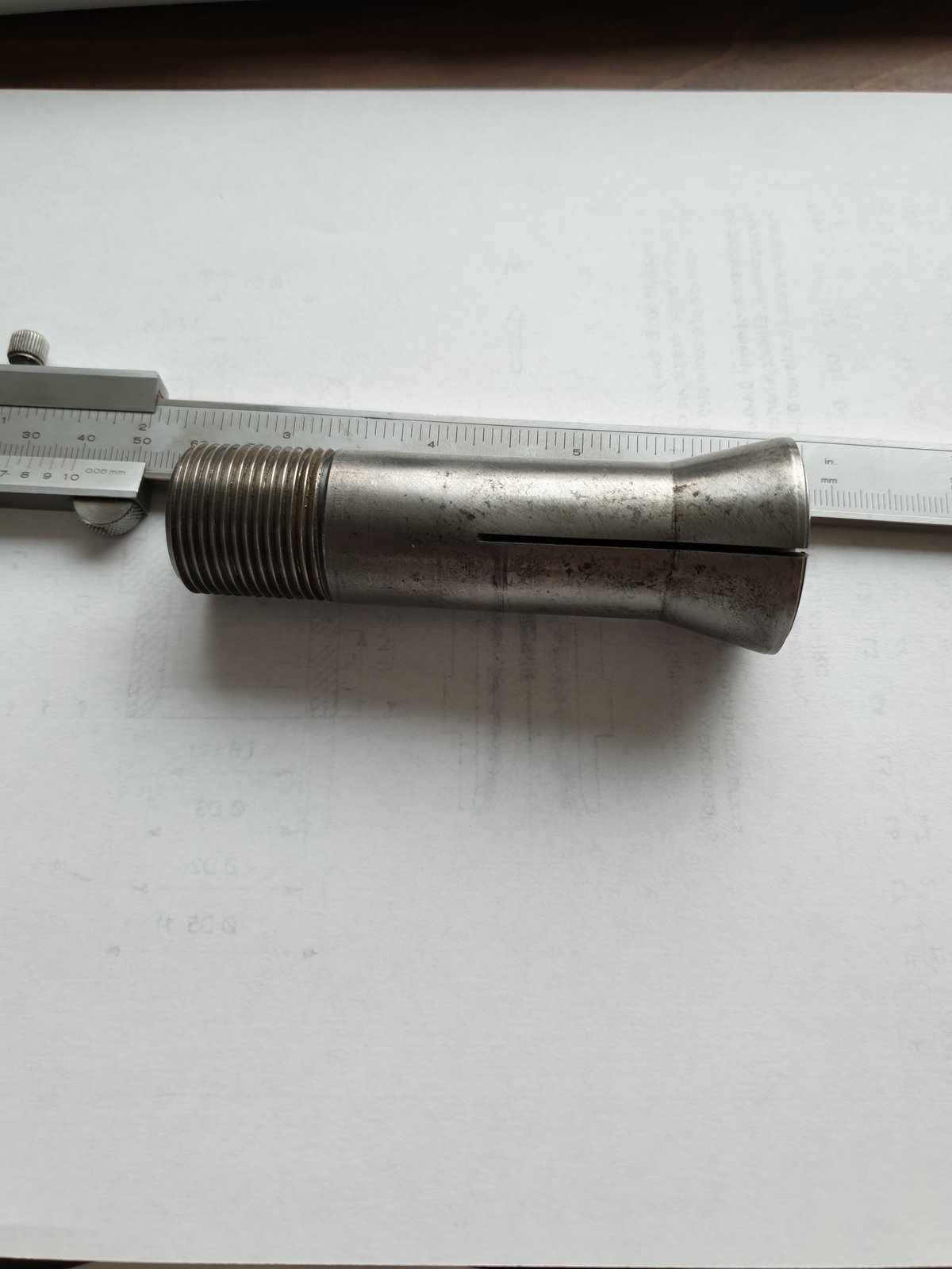

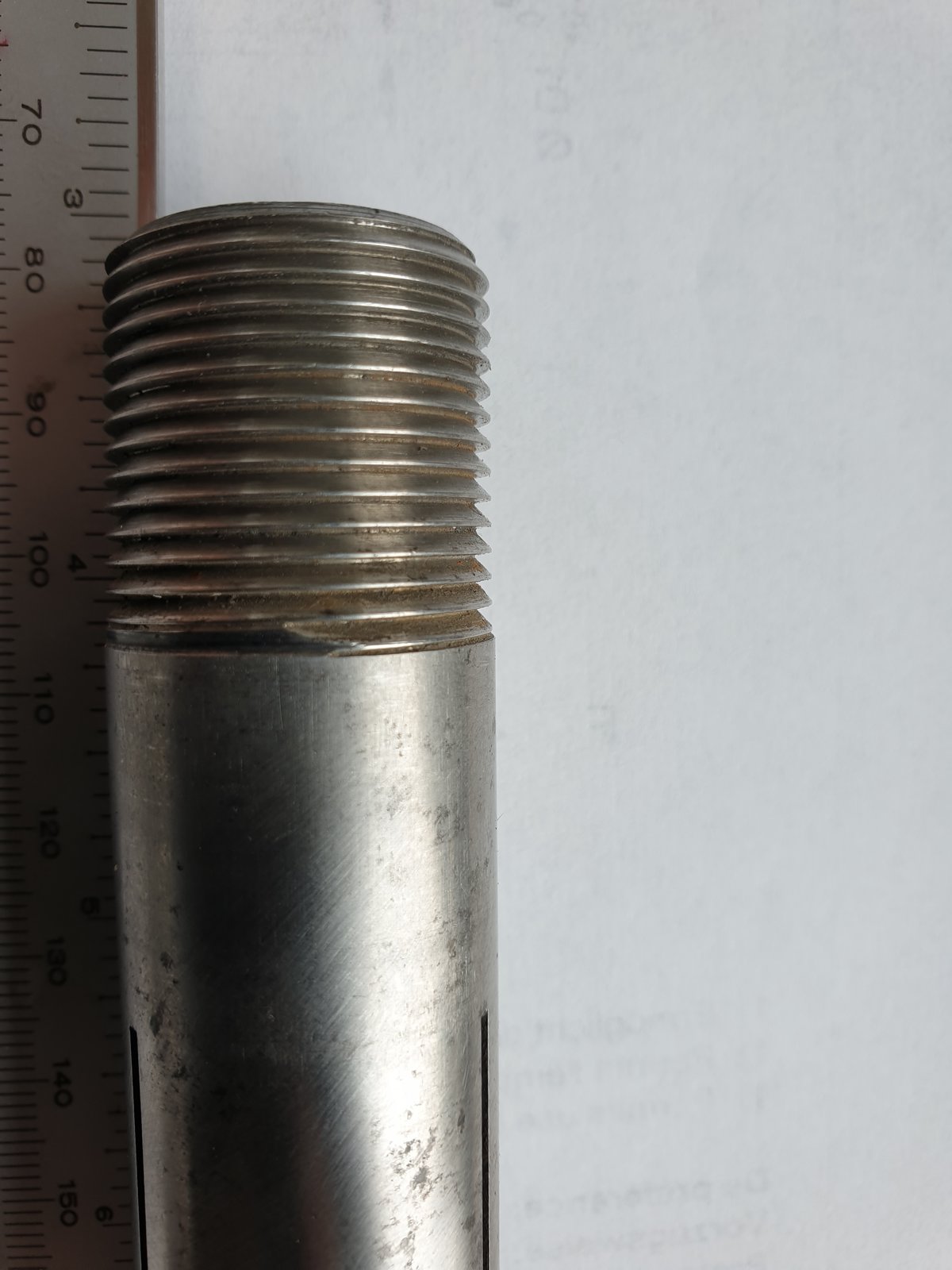

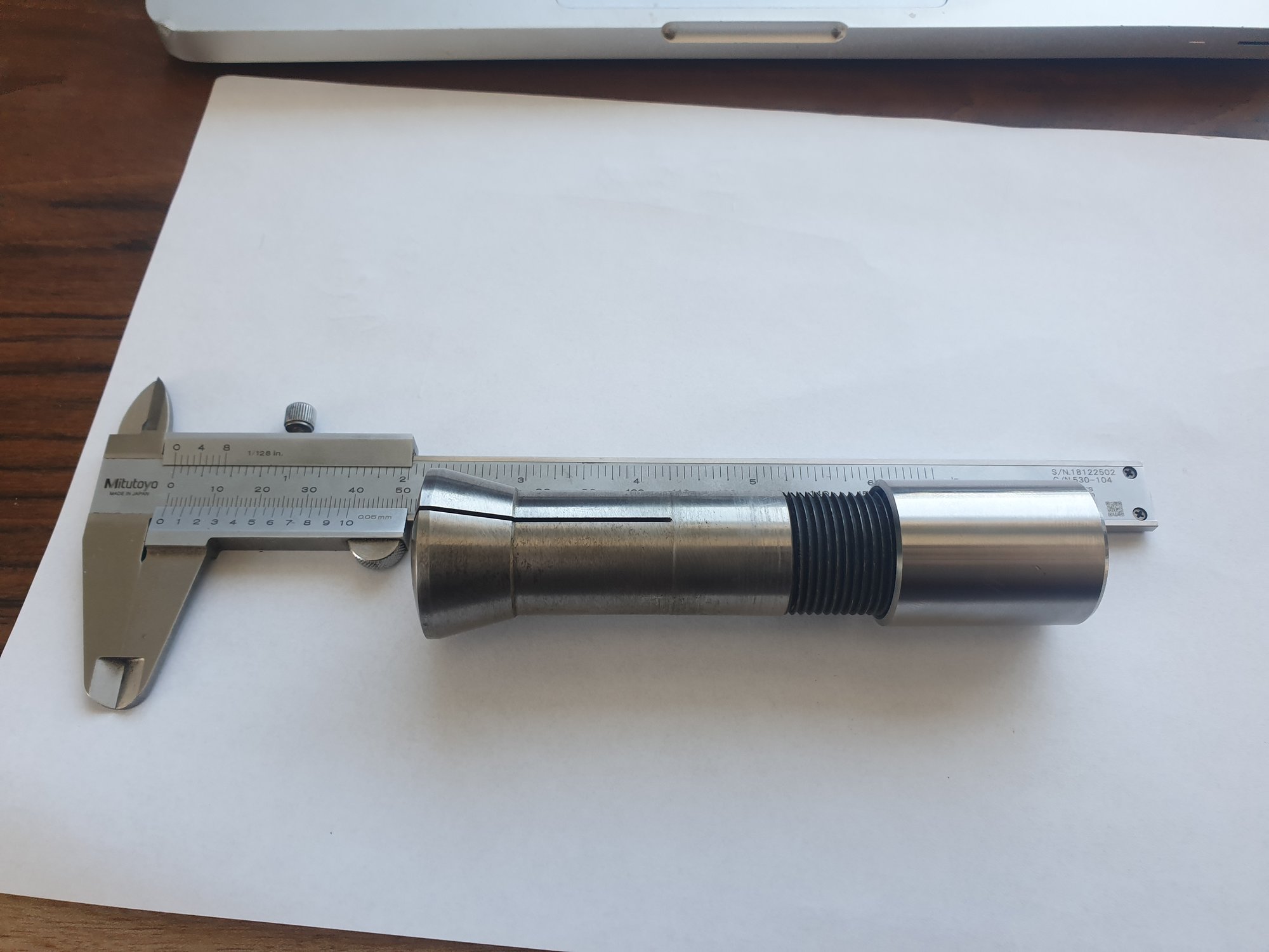

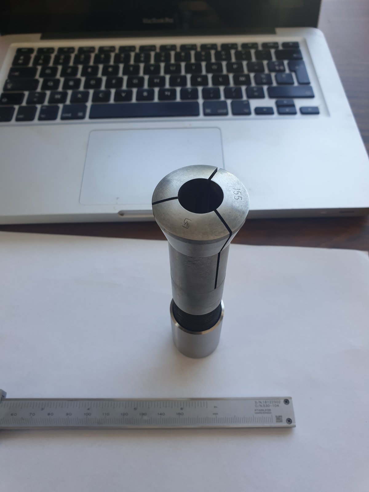

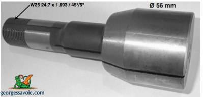

Looking in to making a drawbar for a set of schaublin collets I bought a couple of months back, collets have a very weird thread on the back of them, is there any way to make threads like this or is this Schaublin's way of making sure you buy their parts instead of making your own.
Looks like the threads are 24,7mm x 1,693 pitch 45°& 5° angle, which seem near to impossible to make for an amateur like myself?
