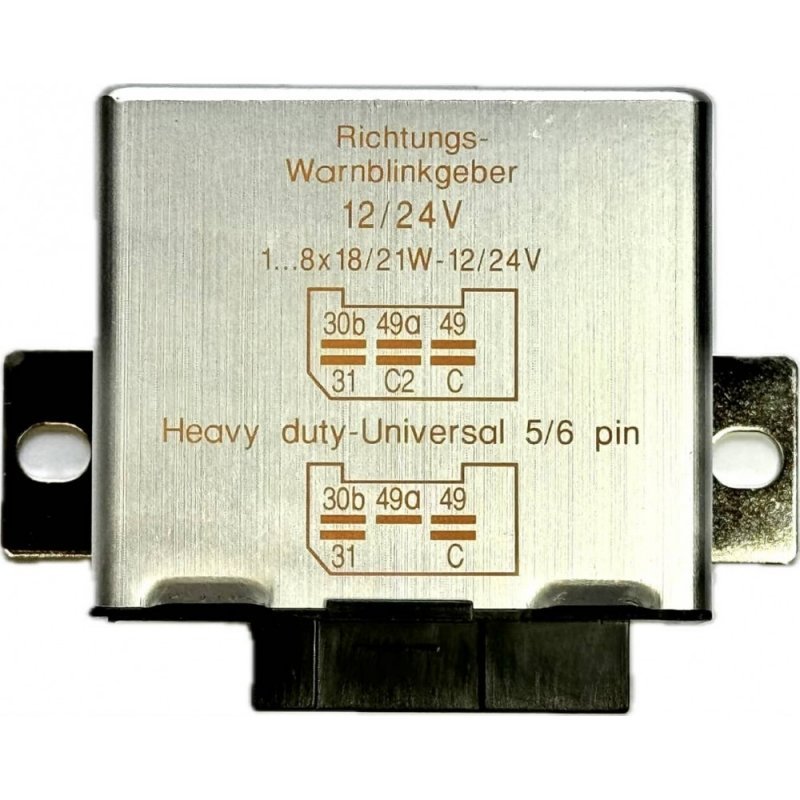

Also a new thing arrived just now... The dilemma is do I claim the VAT back via the house for hunting for cold spots / draughts or via the business for debugging electronics...
