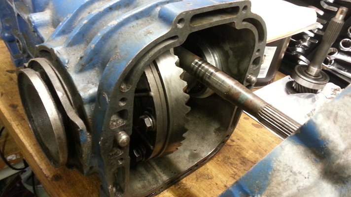

To join the engine up to the 002 VW Micro-bus (said with an Arlo Guthrie accent) I intend to create "Frankenbox"
Helpfully the 002 box splits at the section that houses the clutch. VW box on the left, clutch housing in the background. Input shaft is removable.
Hopefully I can find a CAD drawing of the VW 002 box end.
