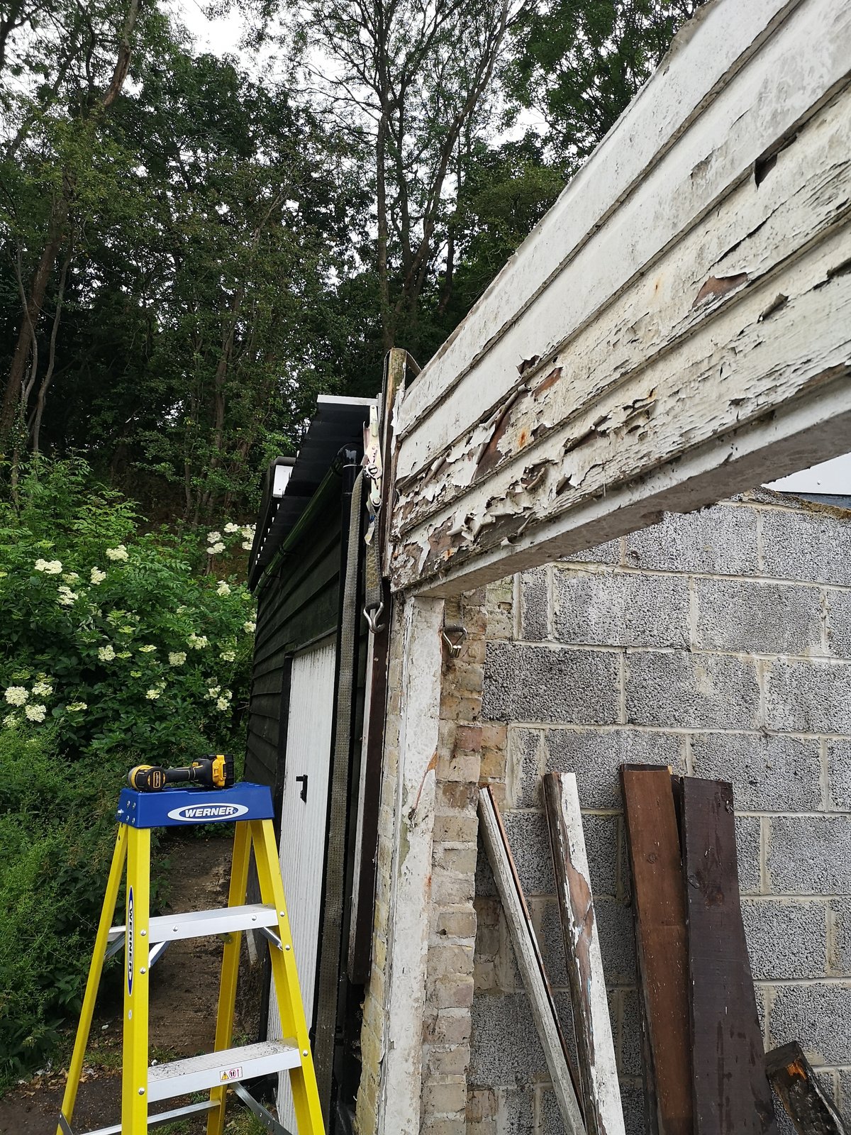

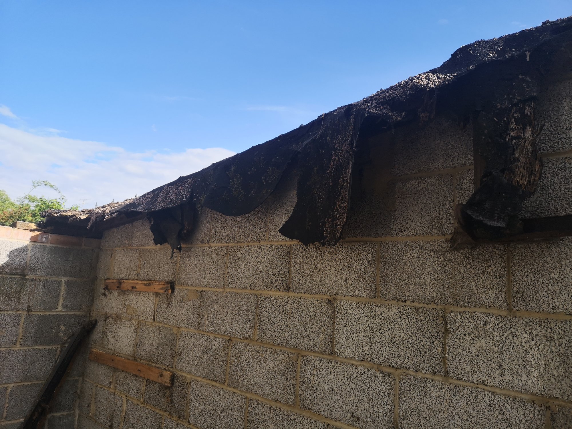

Got the bags pickup.
Now going to have a measure up and buy materials.
There are several other garages with caved in roofs.
(non mobile skips)![]()

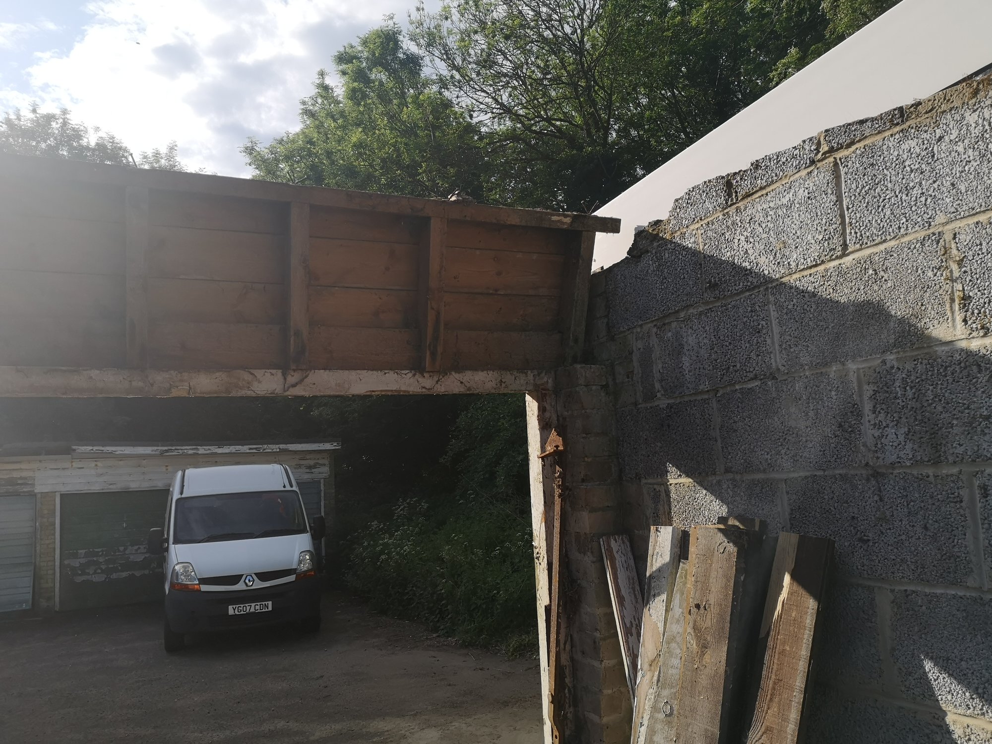

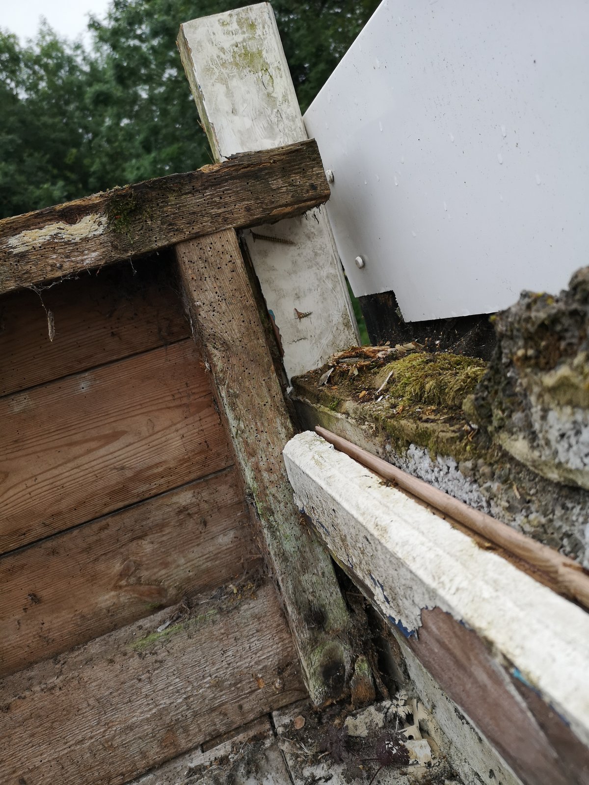

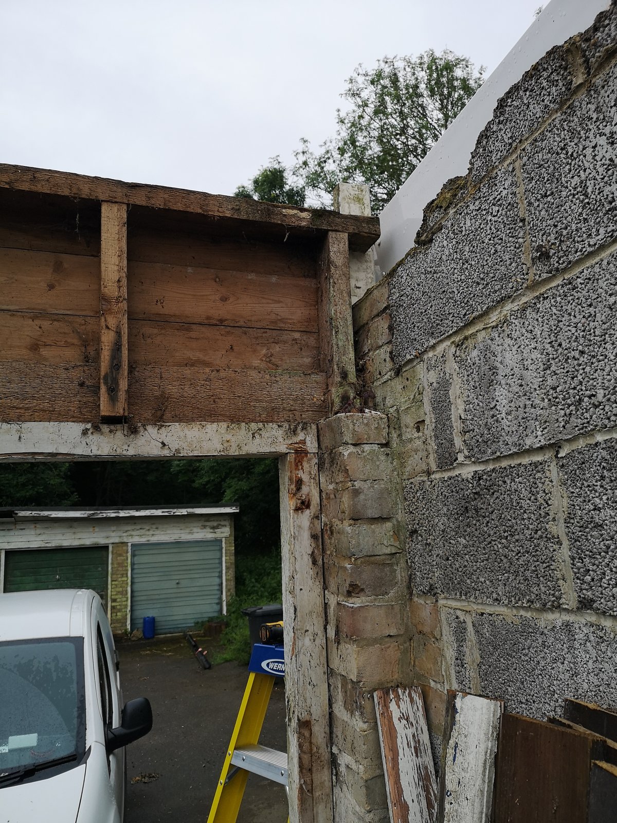

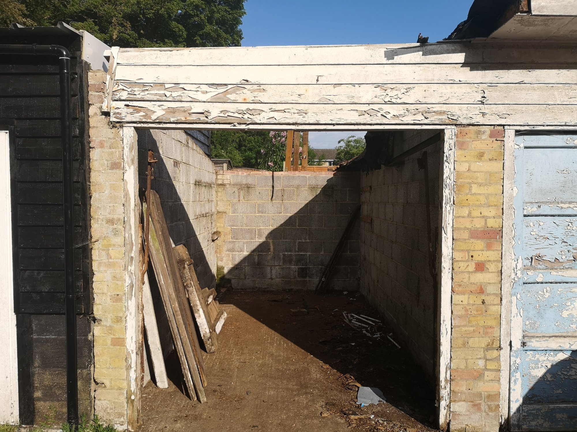

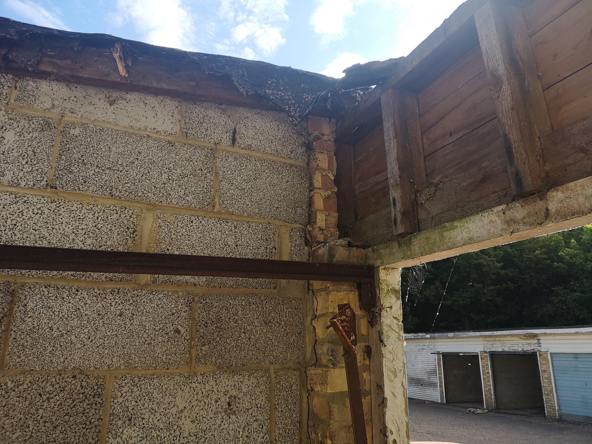

if you had to start and build one from scratch , youve a hell of a good start ,, lots of work , but it will get there.
ask consent to put your roof sheets interlocked into next doors as gives a better seal and no water down the sides
as goes for the right wall you would need to build it up and remamber its a single wall garage they mostley are built that way
this also means you would need to tie in the roof as well you have to do it anyway with roof ties

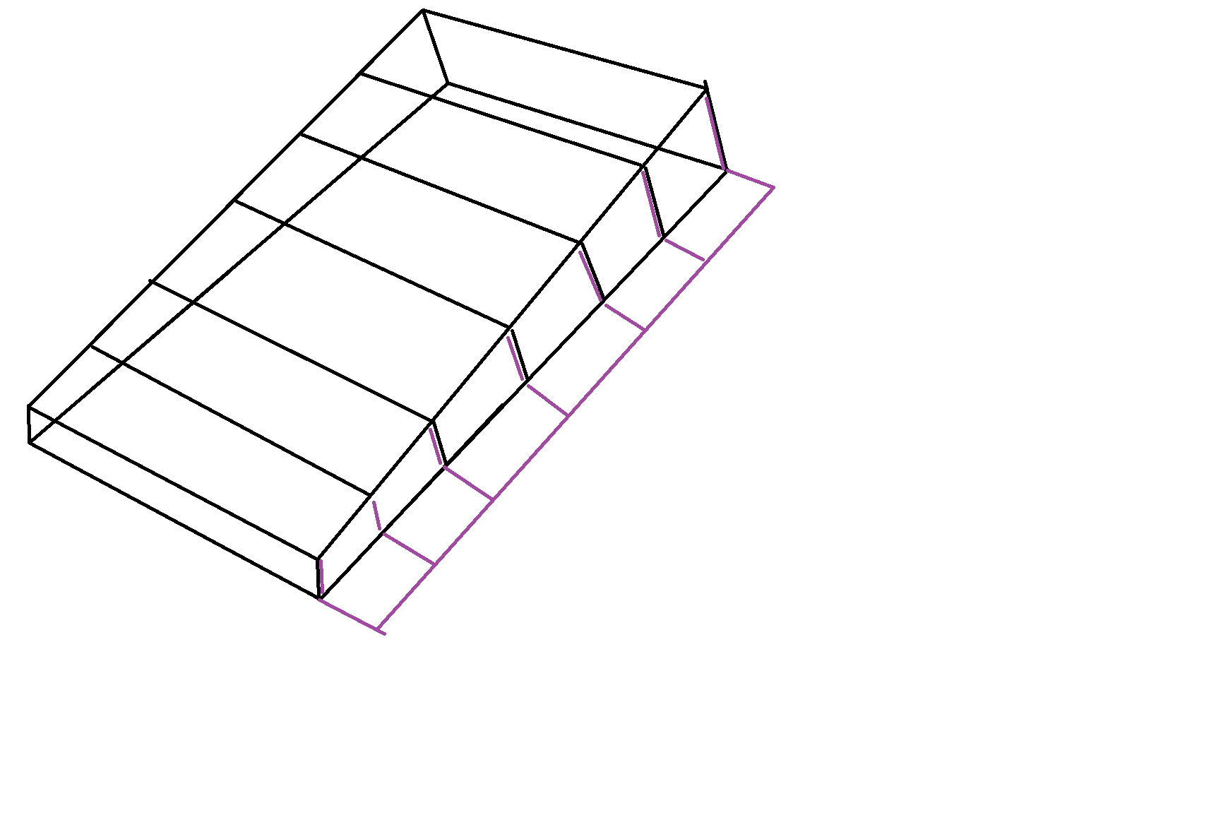

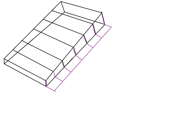

purple is where you would need to use torch on felt the top os metal roofing and overlaped at the side as normal fit gutter on it
this is what id do up to you but either way your roof need to go higher to get a good seal on that other felt other wise you can only match to theres and your using torch on felt same as them
